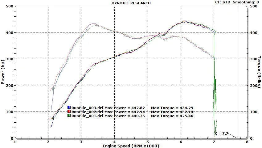

Did three pulls at 110F room temp. I forgot to ask which gear they used...looked very consistent for each pull. 442 HP and 434 TQ seem like a nice bump from the stock. No wonder the 60-130 at 10.9 matches the stock number of C8:p
Car is at 25K miles. No other modifications. Have driven this tune for 1000 miles and felt very stock. I really like this tune so far! Well, mileage was down 25% at 18 per gallon...

Just be happy we can be tuned with bm3. I am too unlocked now using bm3 and love it. I have a custom tune though so I really wanna hit up a dyno and see what she makes.
previous dyno numbers on JB4, e40, meth: 447whp/474tq

Nice number with JB4! I think the stock tire will suffer if TQ over 450...I got much better 0-60 when the rear tire was newer with 91 tune. Well, 40-100 and 60-130 were significantly improved with E30 tune
