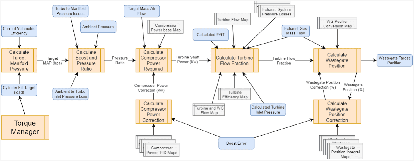

Hi,
I am the calibrator over at GoodSpeed. And I also tune a very wide variety of platforms. This ECU/DME is far more complex than say a KPro. Ecutek also spends a lot of time and money writing custom code to inject into the factory unit to do things like map swithching and such. This ecu has over 80,000 tables to edit. This is a massive under taking to go through hex and define tables and figure out what is actually needed to function. I have access to the majority of these tables and have spent over 1,000 hours working on this ecu. I also tune a lot of other platforms and on things like kpro i dont care about locking my tables. They are just simple fueling and ignition tables. But even if you could open these maps you most people would never have any idea what they were even looking at.
Here is a simplified top view of the airflow model for just cyliinder fill alone on this engine. This is extremly simplified.
EcuTek tries its best to provide training to its tuners. They do webinars, and reading material and spend extensive time figuring out how this logic works. This isn't a simple set the boost level and adjust timing. The other day I was looking for a solution to a problem and i found it after sifting through over 1,000 tables. This took an extensive time.
So if you were interested in self tuning your car I am more than happy to help you out. The package is however not $500. They had a self editing abillity on the BRZ that i feel was priced very nicely for the quality of the software (i have tuned pretty much every bit on the brz platform and even helped define some of the open source maps!). That ecu in its entirety is probably as complex as just the fuel trim model in this ECU.
Ive done hundreds of flashes on say BM3, over weeks and weeks just trying to figure thins out. With that being said I doubt people will really have a desire to edit their own tables, as it is going to be quite a bit over most folks heads.

Hi,
I was more talking about editing the set parameters maybe like hot boost cut, low boost cut settings. Lean protection settings. Not sure if you ever will have boost by gear on these ecu setup? IAT vs IGN retard setting tables, injector size settings, disabling secondary o2 to pass emissions, and etc. Maybe electronic boost controller table where you can turn it off and run off the wg spring or adjust the pressure or run it off boost by gear. stuff like that. and the stuff you mentioned, holy cow! Definitely sounds like super complex vs what I am used to!!
I wasn’t planning to go in and start messing with the major tables. As far as knock detection. Do the datalog detect that? And is there an indicator when the motor is knocking? Are you also allowed to save your datalog and review it? I been 15 years out of the game and this high tech bmw is new to me. And thank you for taking the time out to tell us more about this.
These ecus do no thandle boost like kpro does. The engine looks at airflow much different and doesn't care about how much PSI is in the engine. So settigs similar to what your asking are so complex. The timing for example has a simple flow chart to what i showed for thermal management. Timing is balanced with modeled components suhc as the actual manifold, valves, pistons, turbine etc for damage thresholds. So when things warm up the car changes fueling, turbine presure, ignition angle, fuel firing angle. None of these are simple tables to edit. This would take extensive experience to be able to edit these as an end user.
Boost by gear there are ways to do it with the OEM tables if it was needed.
Timing on this ecu is complex. The engine will do many things to verify knock, it is very complex and if i recall it uses both knock sensors and ion detection from the spark plug its self to check for combustion stability and it will alter the parameters in the strategy to test to see if it can stabalize its self.
You can also log every parameter i can, and view it. Ecutek does come with a simple but quite useful datalogger. If there is enough interest i can write some guides on reading some basics in logs. But i also want to prevent people from over analyzing the logs thinking this engine works with set boost targets and such. There are a number of signs for knock and even a basic knock flag that does show up at times. Buth there are earlier signs of combustion stability issues and such. EcuTek is also developing custom logging logic to log internal data that is not available through the standard dataloggin available on the market. For datanuts this will be quite nice. =)
