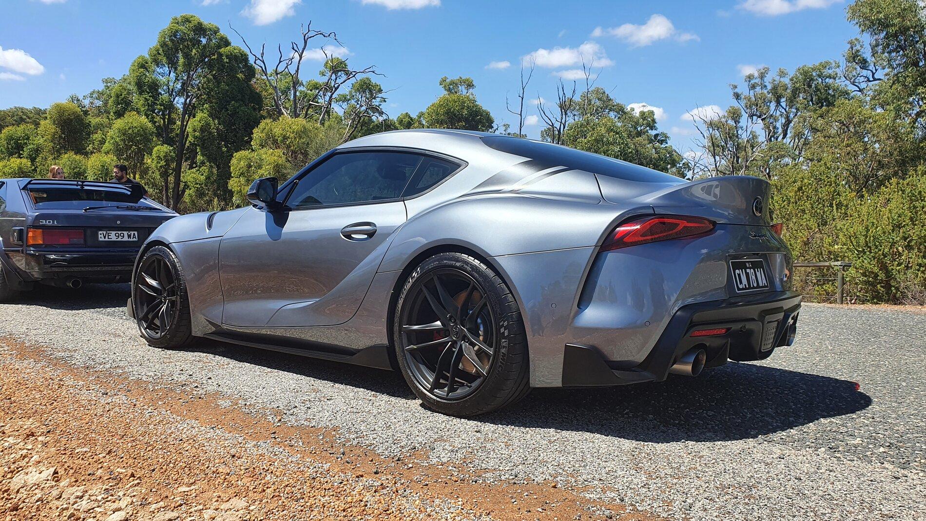

Have any pics after some mileage? Did the springs settle any further?
This is after a couple of hundred kms - settled very nicely I think - without measuring I'd say exact same distance front and rear between tyre and guard, plus it doesn't hit on curbs pulling into parking bays etc. A good compromise between looks and driveability.

Appreciate the final picture. I have a US spec kit at home, but after seeing all the pics of these, this is the drop I was looking for from the beginning. Even, pretty mild, still low enough to satisfy my aesthetic needs. Nice job on the video too.:thumbsup:
