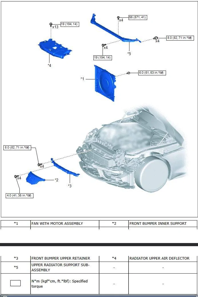

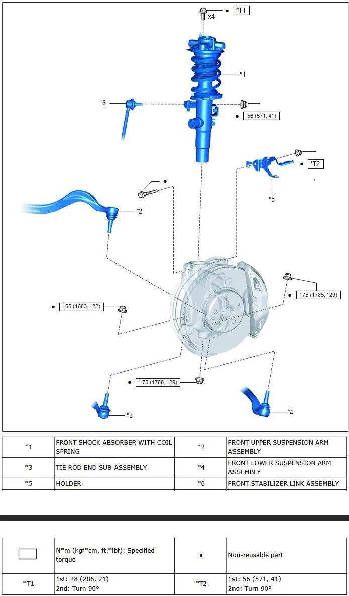

Its, 56 Nm or 41 ft/lb for chassis mounted bolts in those areas.
The shocks and nearby bolts are 56 Nm or 41 ft/lb.
Here's some context clues:
