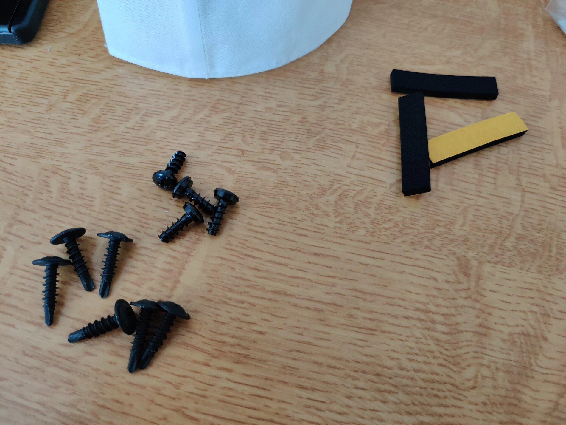

EDIT: All 3 cushions were installed on the bumper were there was a possibility of the middle ridge of the license plate (see top ridge of the license plate holder picture) could dig into the bumper.
I believe the cushions were actually provided for the rear license plate holder. In my case that holder was already installed safely with use of some gummy/putty.
When I took delivery of my vehicle, the garage did not install the front license plate holder because it requires drilling in the front bumper.
I will most likely still install it myself.
Are there any European Supra owners that can tell me where the foam cushions are supposed to be placed?

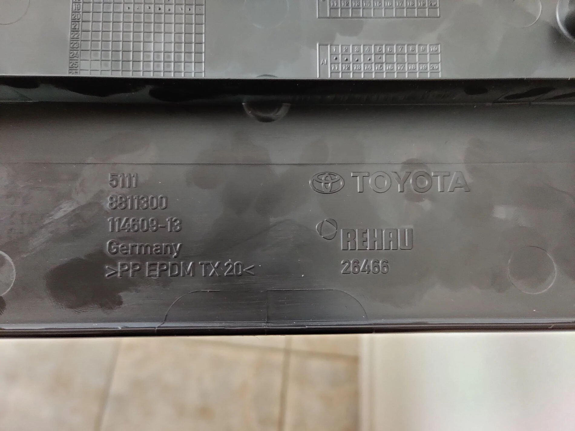

The European license/number plate holder/bracket part number seems to be: 51118811300
Other part number mentioned on the plate: 114609-13, made in Germany

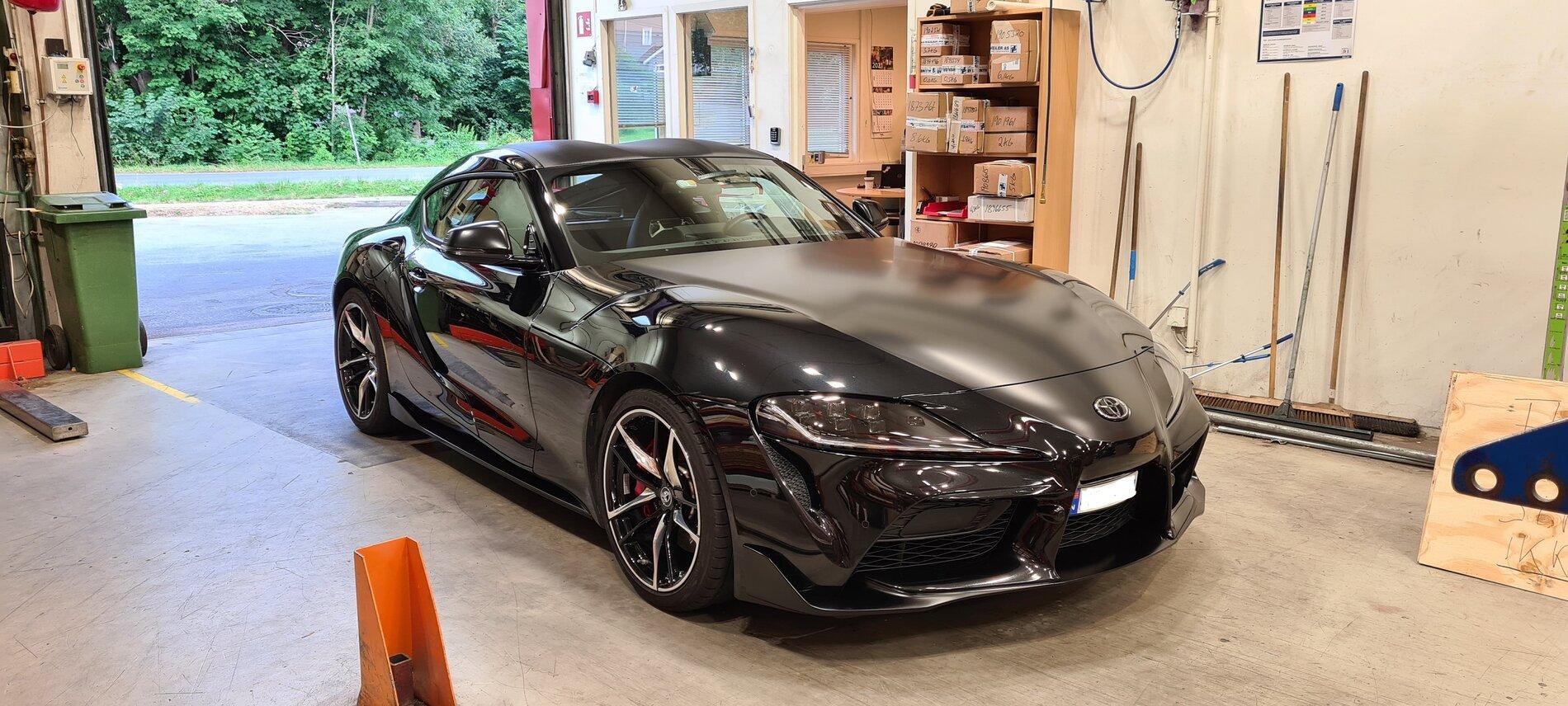

here is what mine looks like now, it took me a few hours to fix the holes and paint over them..

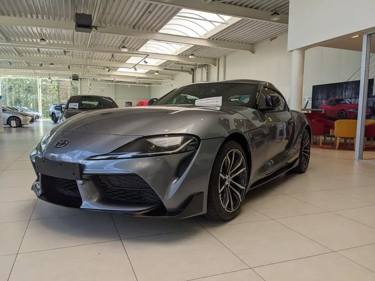

The car I bought last weekend has the front license plate mounted to the tow hook (I think) in the grill below the drivers side headlight. However I prefer the normal spot like in this picture.
Is this the same one you ordered with part no. 51118811300 ?
