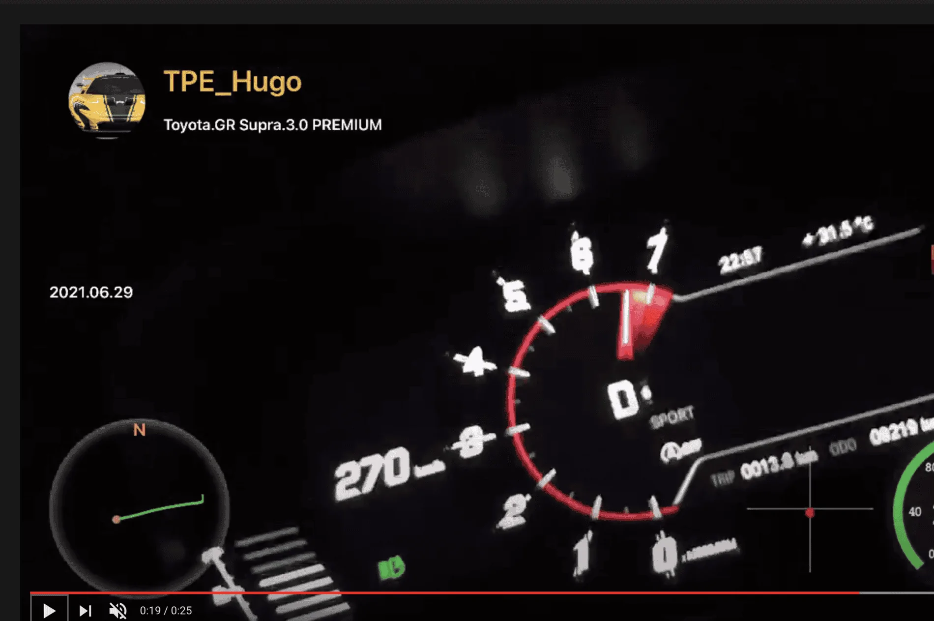

For owner who would like to extend the speed meter scale over 263kph
This is hidden one under Z4 menu.
Z4 → Instrument cluster → Expert mode → 3000 Anzeige_Konfiguration → BC_V_KORREKTUR → onhe_korrektur

From the BimmerCODE steps provided in post #1, my research indicated that these coding steps removes the speed adjustment so the speedometer displays ther correct speed. See my BimmerCODE User Guide thread
  1. Speedometer Display correct Speed (not ¾ mph faster).
    This removes the speed adjustment so actual speed is displayed on instrument cluster.
    Main --> Instrument Cluster (DKOMBI2) + [Expert] --> 3000 ANZENGE_KONFIGURATION --> BC_V_KORREKTUR --> ohne_korrecktur (i.e. without correction)
    Main --> Instrument Cluster (DKOMBI2) + CODE
I guess this also removes the "max speed limit displayed" setting? Does anyone know what the maximum displayed speed is changed to?
I saw the same user guide at the beginning. It's very uncleared. Then I found a post in m340 forum.
They extend the scale with this coding. And it works for Supra as well.
The maximum speed displayed is 300kph for 600whp STG in my area with this change in the summer (85~92F).
It's limited to 300kph due to heat soak in my guessing. We'll have it a try in the winter.
