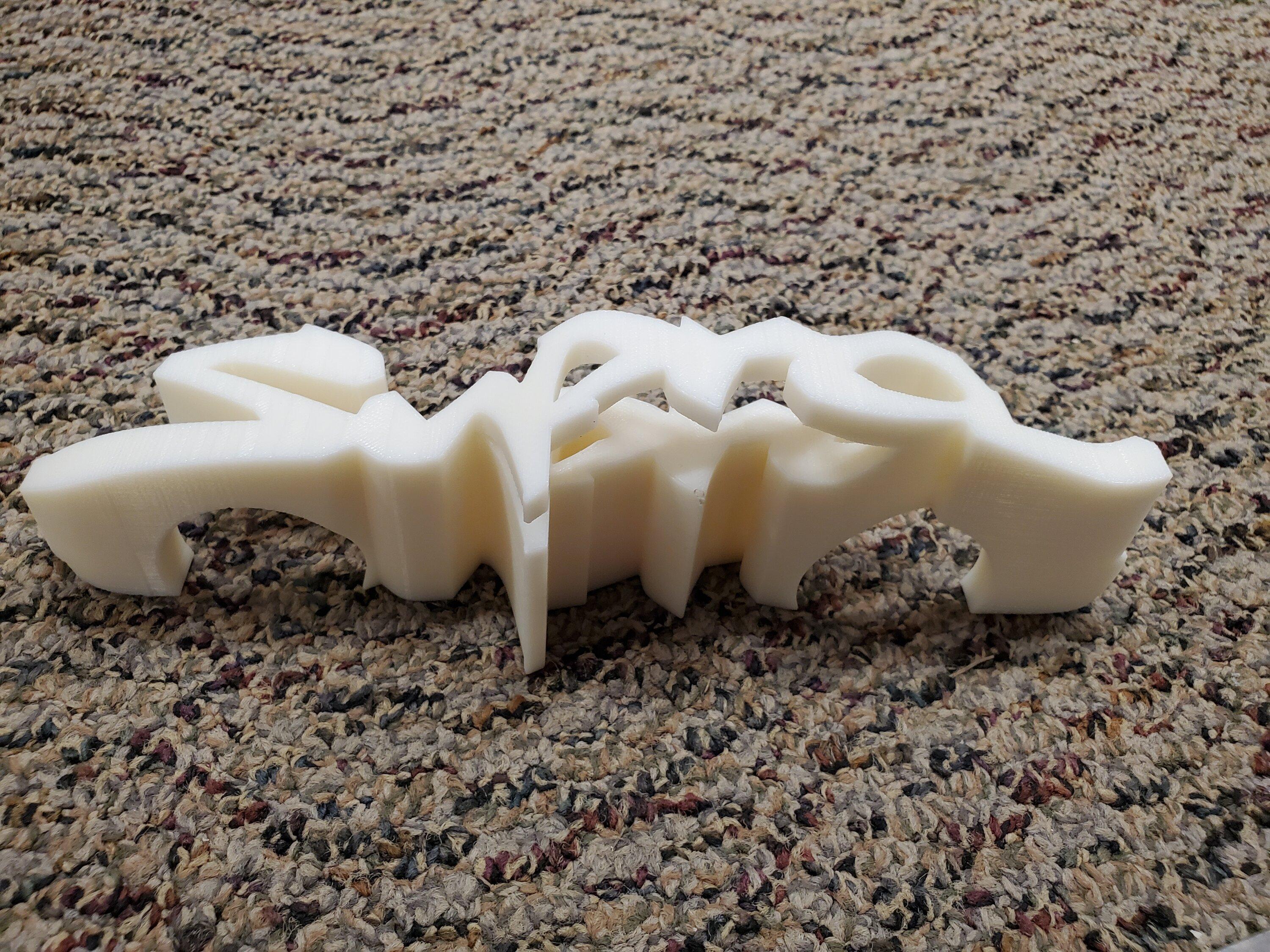

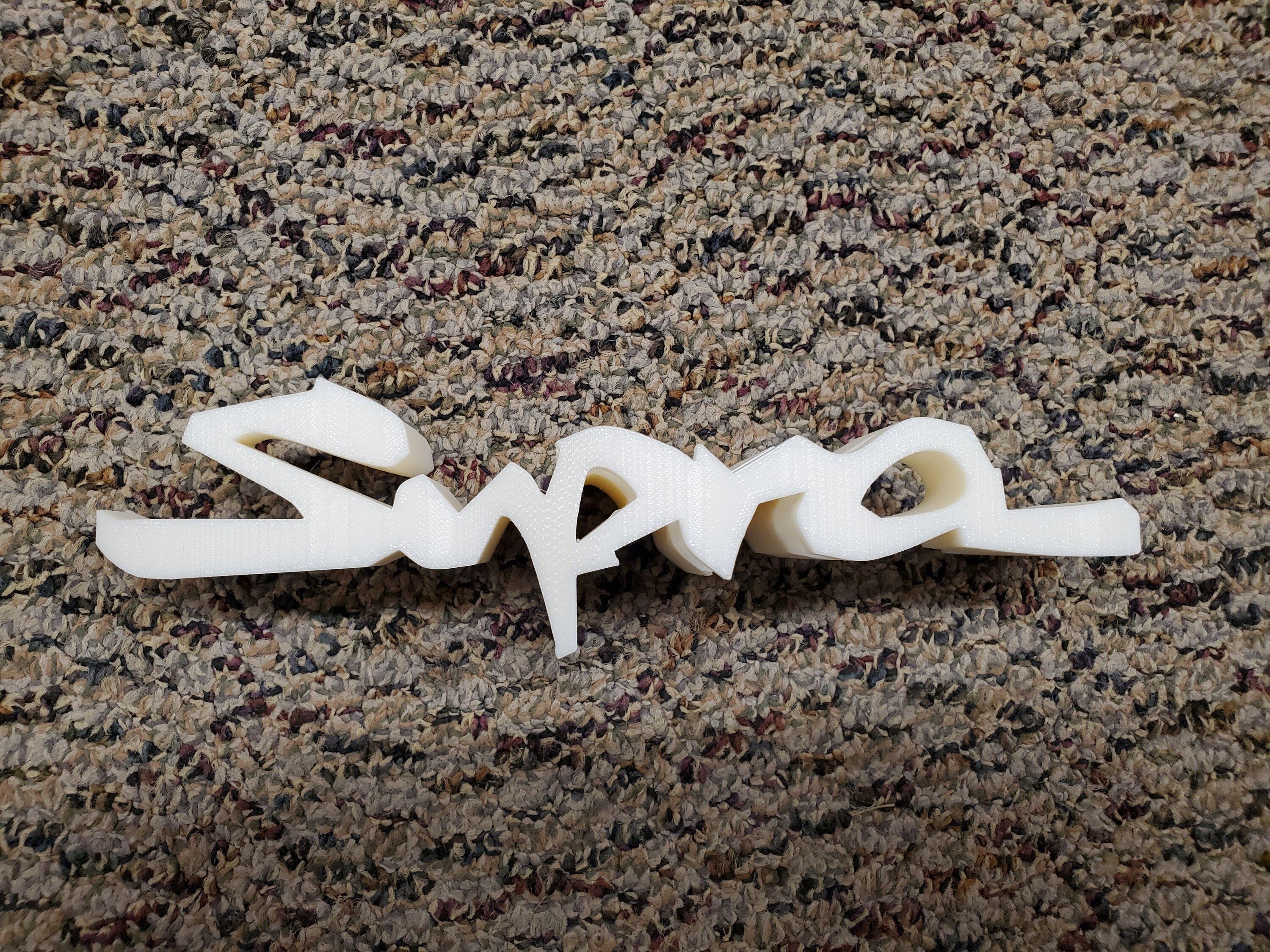

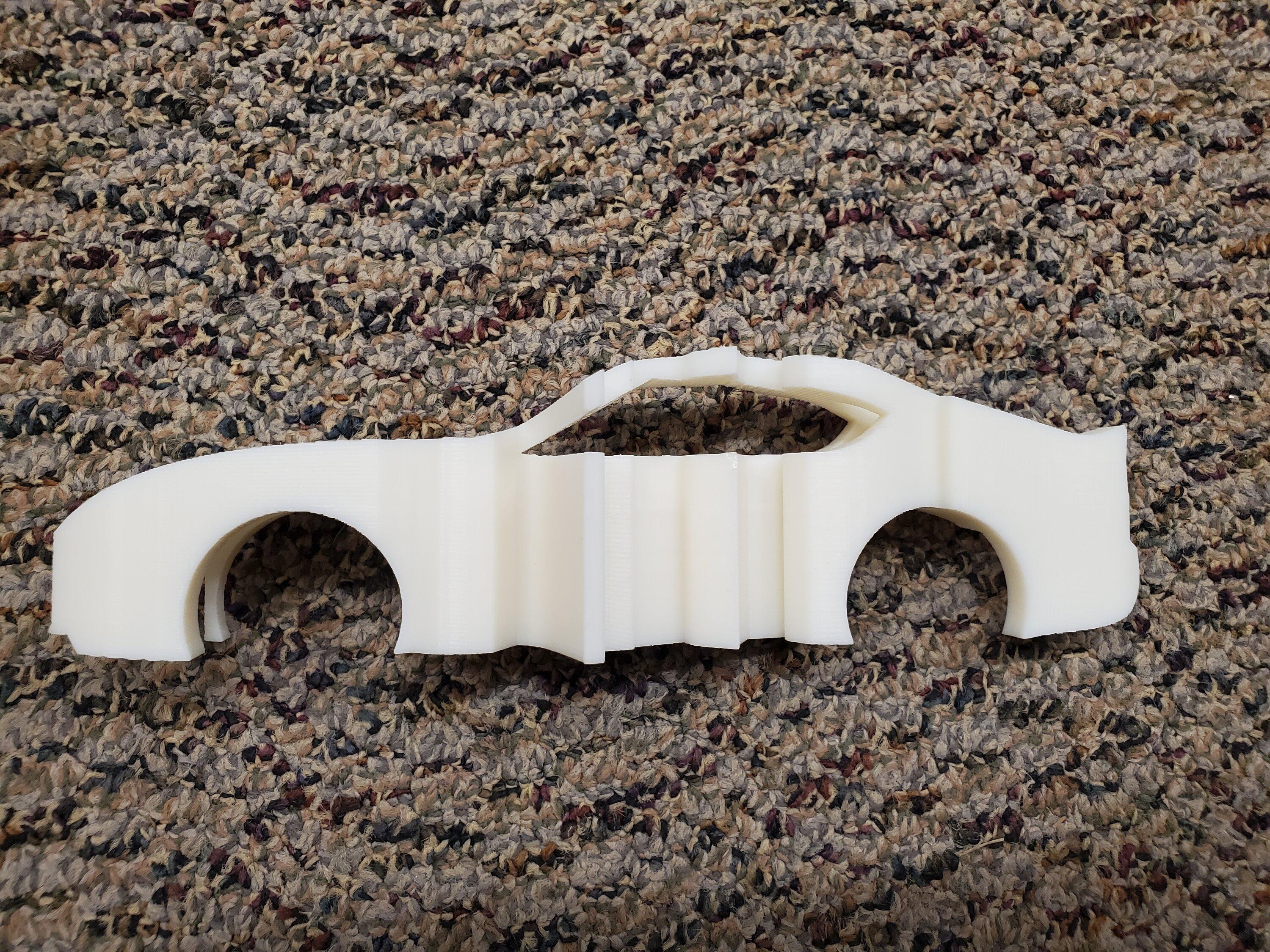

Very cool. Not as talented as this guy, but I also dabble a little in 3D printing Supras. A little piece I designed for my desk at work:

Thank you! That's a great idea too. The Stratasys printer I have at work uses pretty thick layers - would have required plenty of sanding and paint. Was lazy and got AMS deflectors on mine 😂

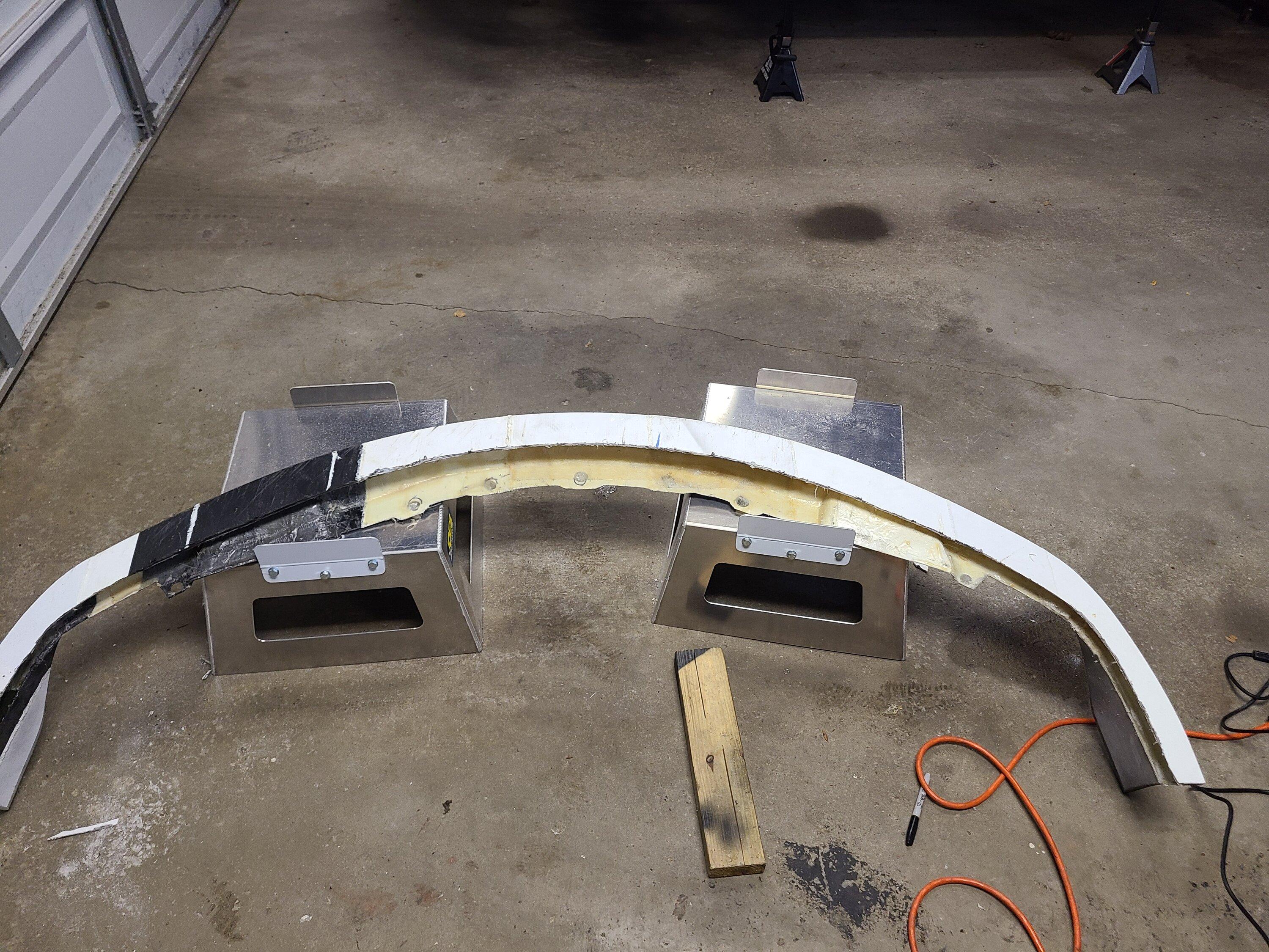

Lol. I guess it'll be an engineering challenge and learning experience. The hood and the rear quarter panel are massive. Not sure what 3d printer he'll get or build, to print. Chances are he'll print smaller pieces and epoxy them or whatever.. I'm also curious as to which material he'll choose. Hopefully this idea will not die after just 1 video.

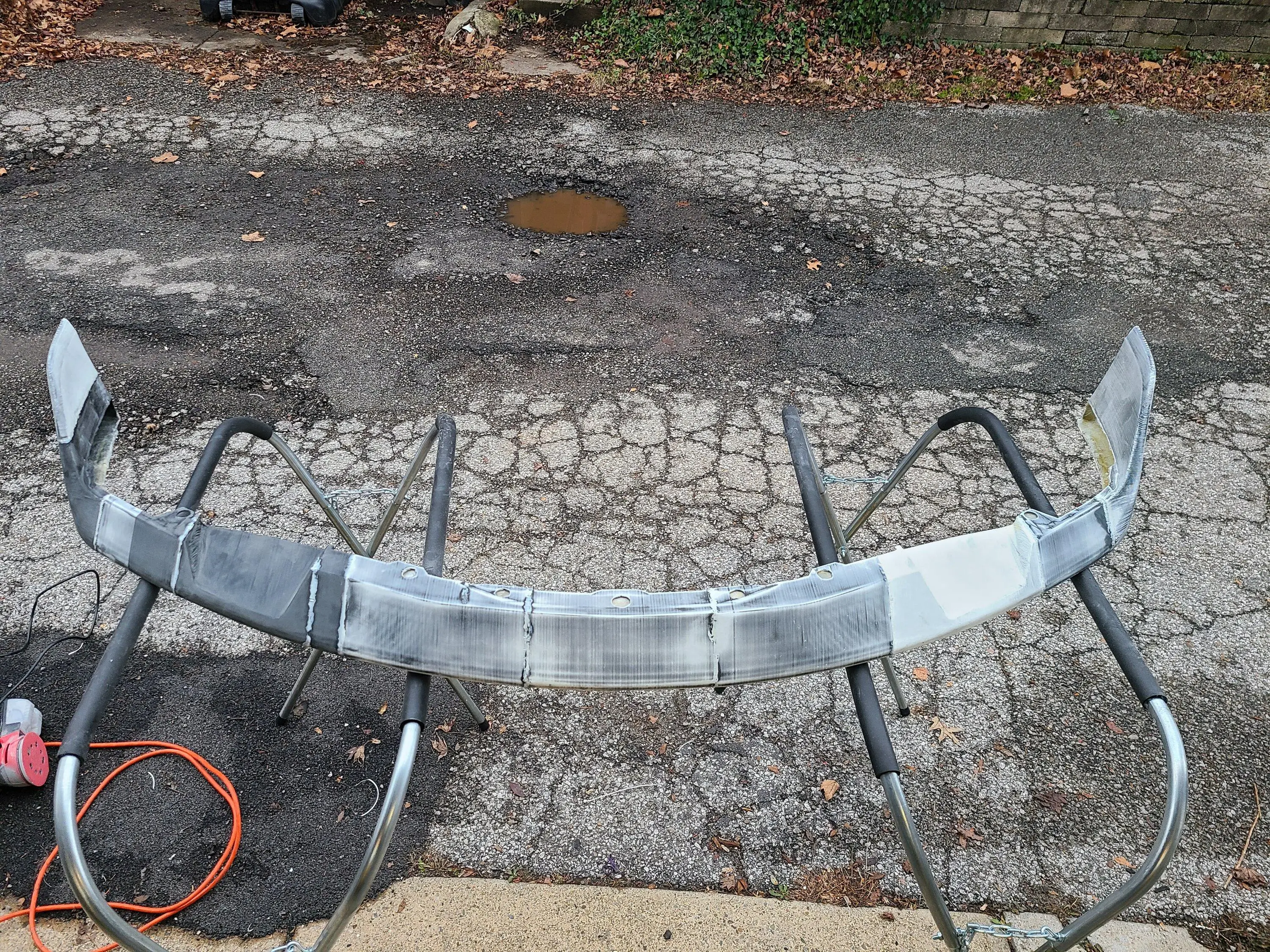

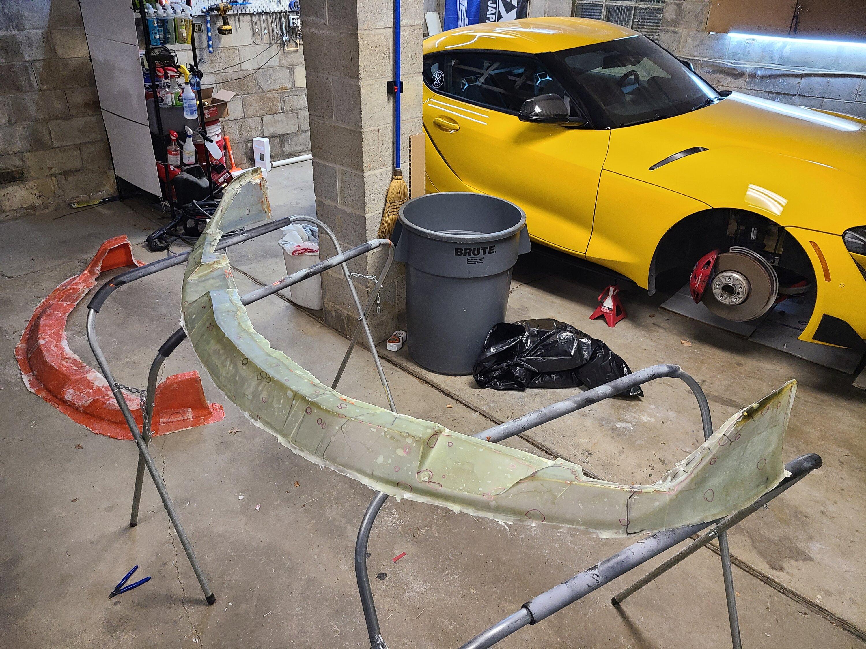

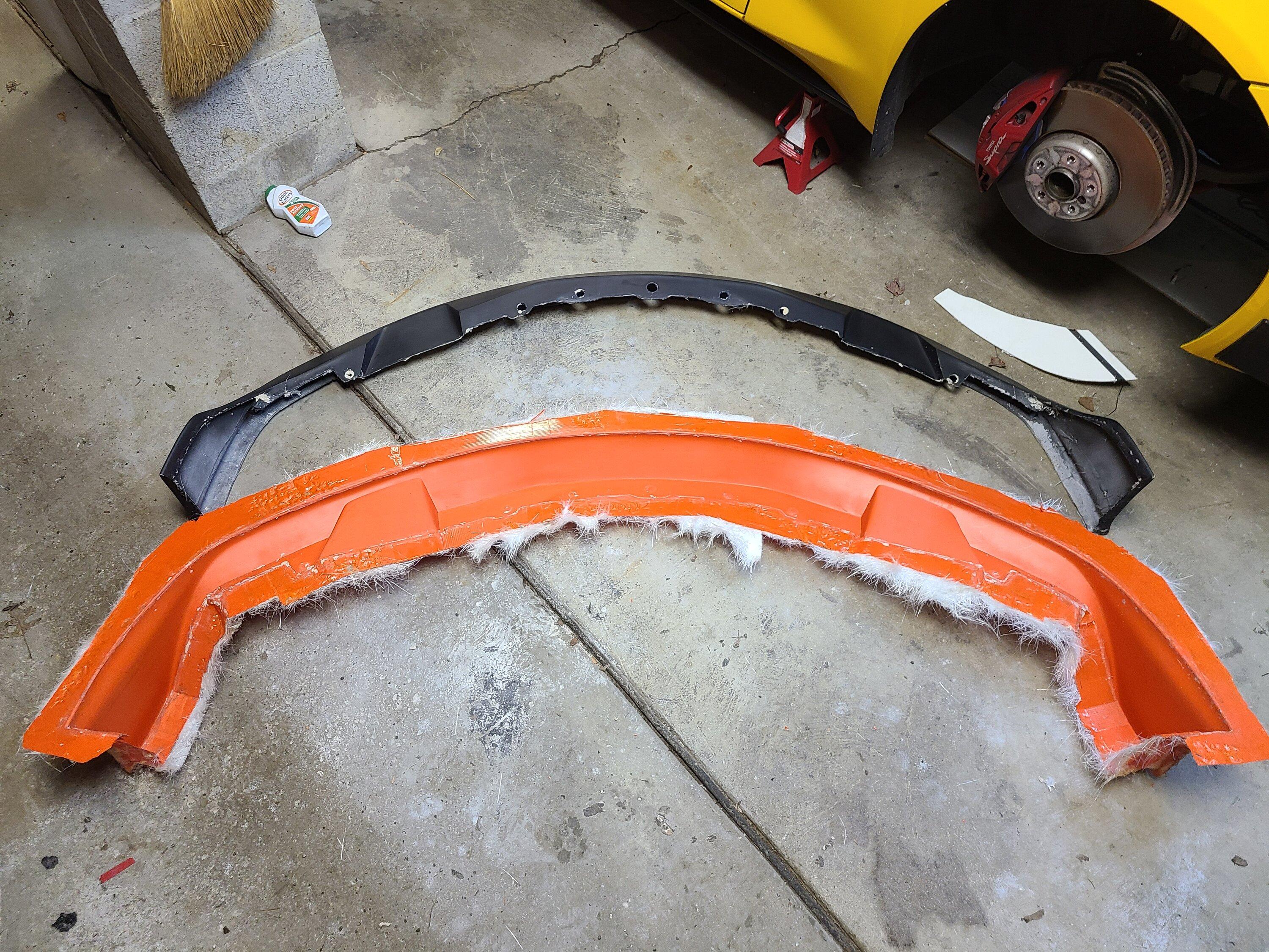

Not entirely sure either, however I would imagine he would be doing smaller pieces and gluing them together like I did with my lip (although I did that just to strengthen it to be used as a plug for a mold), then adding reinforcement on top of/underneath. There's a small community of people 3d printing hardtops for NA miatas where they do just that. Print the shell in pieces and then either reinforce it with fiberglass or use it as a sacrificial shell to mold fiberglass on with mold release and then remove the 3d print.

Lmfao!!! Solidworks tracing feature ez😂

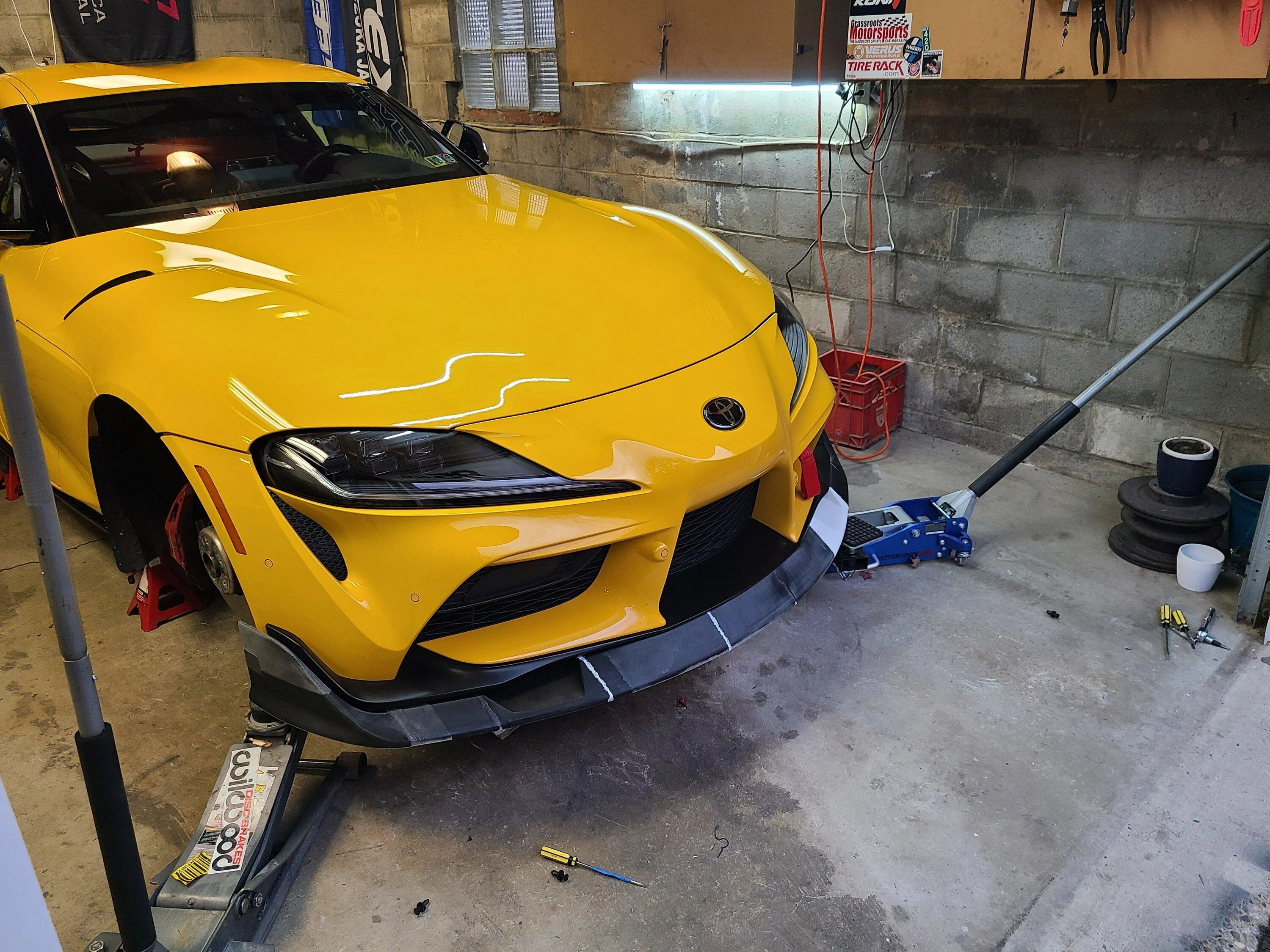

Outstanding work brother. Been thinking of going this route as well mainly because I'm not a fan of the available lip kits that are available. I would love to pick your brain.

Thanks man! Reach out anytime. I helped someone else replicate the lip, he's on insta @bo.nguyenn
