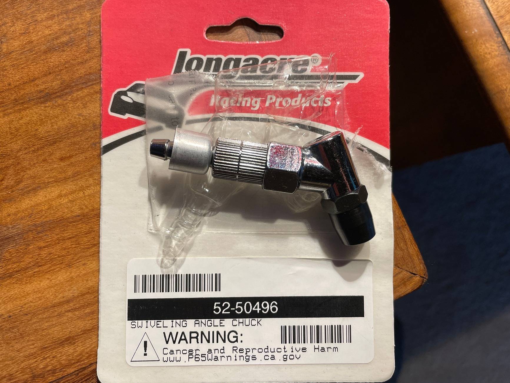

CA must be the looniest state in the US. I bought this 6 months ago from CA. Check out the warning label! For a tire inflation adaptor!

CP65 is such a pain in the ass. People literally will go into stores looking for products without the warning label, have it tested and if it fails they sue the manufacturer and retailer.
All that crap says is this product is made with materials that have been known to cause cancer. Unless you're melting it and injecting it into your blood stream, you're fine but people think they can get cancer by touching it. You know what else can possible cause cancer? Stepping into the sun, sitting in your car on the freeway, living life, etc etc.

When I got it I went to the website to try and figure out what about it was a risk to my health but found nothing obvious so came to the conclusion it was only CA "stuff".
