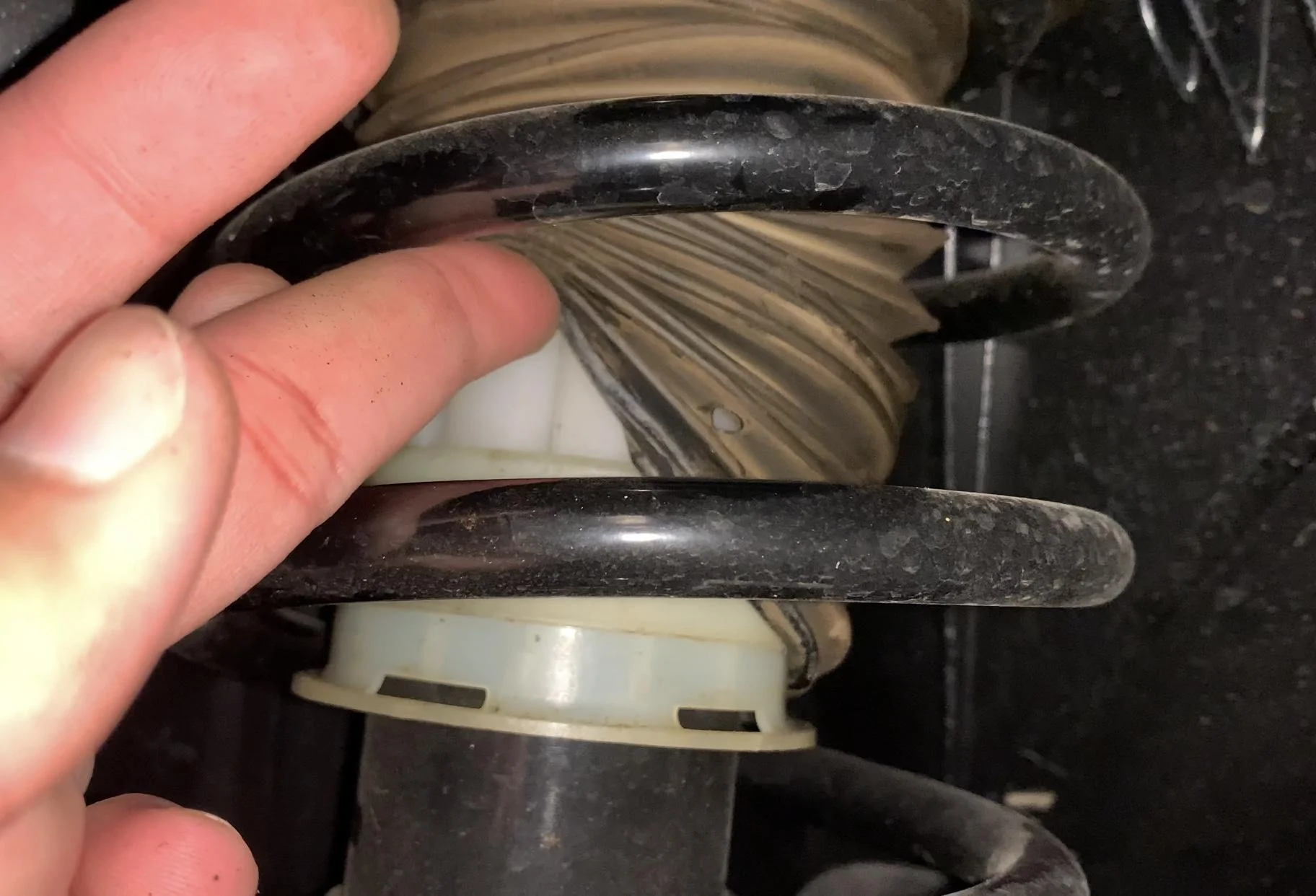

- I will look for the bump stops removed from the suspension

also, check the front struts if they removed the shipping spacer
