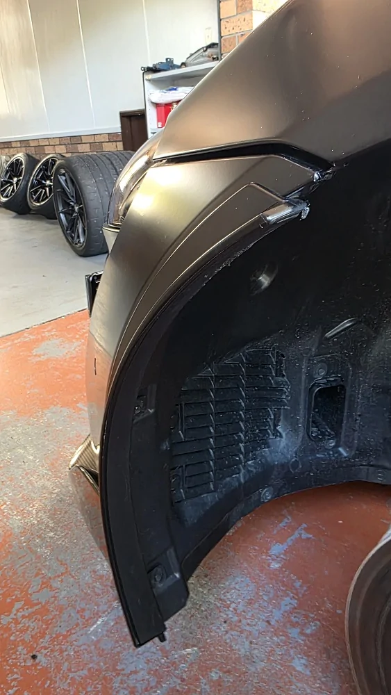

Can someone confirm the part numbers for the front bumper aero flaps as fitted to Final Edition/Track Edition/Lightweight EVO 2025 and 2026 Supra's.
I have damaged both of mine on track with 275/35/19's rubbing the inner edge of them. The part that should make it better for track gives you extra clearance issues on track!
I have called one on my local Toyota dealers and the part seems to be a bit vague in the catalogue.
A silly, scary price of just over $2000 AUD for both sides was quoted over the phone.
Will go in to confirm with them it is the correct part in the future as I need to get some service items anyway for a few other cars.

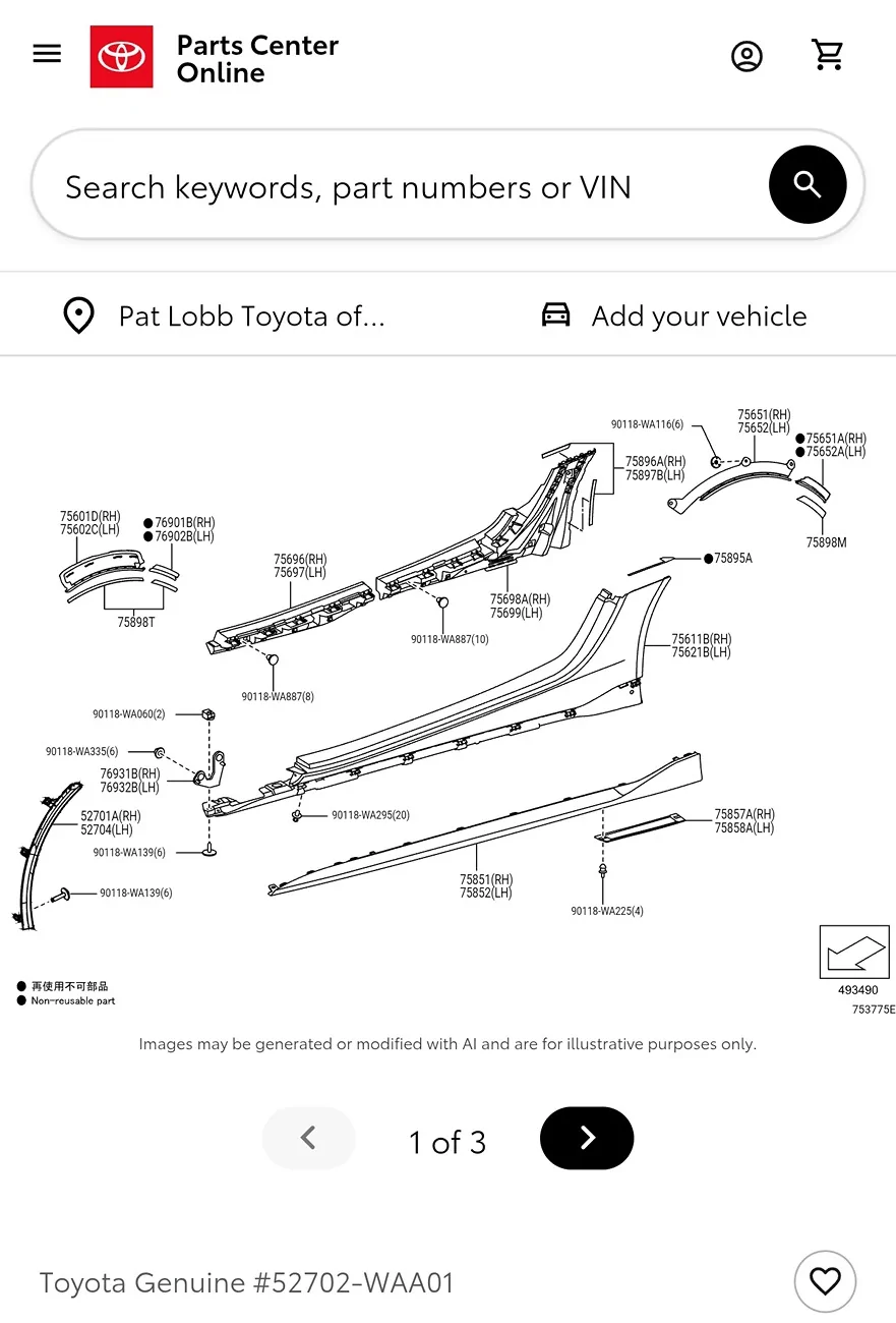

From what they told me it seems the part numbers may be.
RHS: 52702-WAA01
LHS: 52703-WAA01
Found this online, but cannot find any pictures associated to the part number to confirm.
Molding Sub Assembly F 52702-WAA01 | OEM Parts Online
Molding Sub Assembly F 52703-WAA01 | OEM Parts Online
And here is my lovely rubbed LHS flap.

Interesting, it looks like other websites have a picture of it, but they also dont have any hits when you try and search 52704-waa01. The price of 52702/3 seems high to me, considering the giant fender liner is only like 60 bucks, so I'm guessing it's something else we're not seeing in this picture
You would be surprised. The little stick-on fender "flares" on the ZTK package for the M240i are like $2,000, unpainted.
That is definetly the correct part numbers.
I did drop into my most local dealer here in Australia to confirm.
Those two parts are just over $1000 AUD each!!!
I think I will explore other options at that price.
This will be more so for returning the car to better condition when I go to sell in the future. Not for now.
Will contact Amaya regarding the part and see what they come up with.
I actually have not destroyed them yet. The left side is more rubbed than the right as I ran a clockwise track that has a right hand heavily cambered corner that you brake into. Essentially have worn through the upper inner edge of the left one and started touching the guard liner behind it. Just touched the right one a few times as there was only 4 off camber left corners in the whole track.
I'm already maxxed out camber wise at 3.2 degrees with Millway Camber plates. That is spring nearing the strut tower ribbing. Not camber plate limit.
Have H&R springs which are way to low up front but OEM springs will still bottom out the same amount os a non issue.
THe problem is the 275/35/19 on 19x10 OEM up front with 12mm spacers to clear the strut inner.
I also have 10mm spacers but could not fit them with thi setup so they are on the rear ATM.
My HKS springs arrived this week, so I will be swapping the wheel spacers on the front from 12mm to 10mm which may just be enough to stop future rubbing as it is really that close and with the bit of seff clearing already done it may not rub again.
