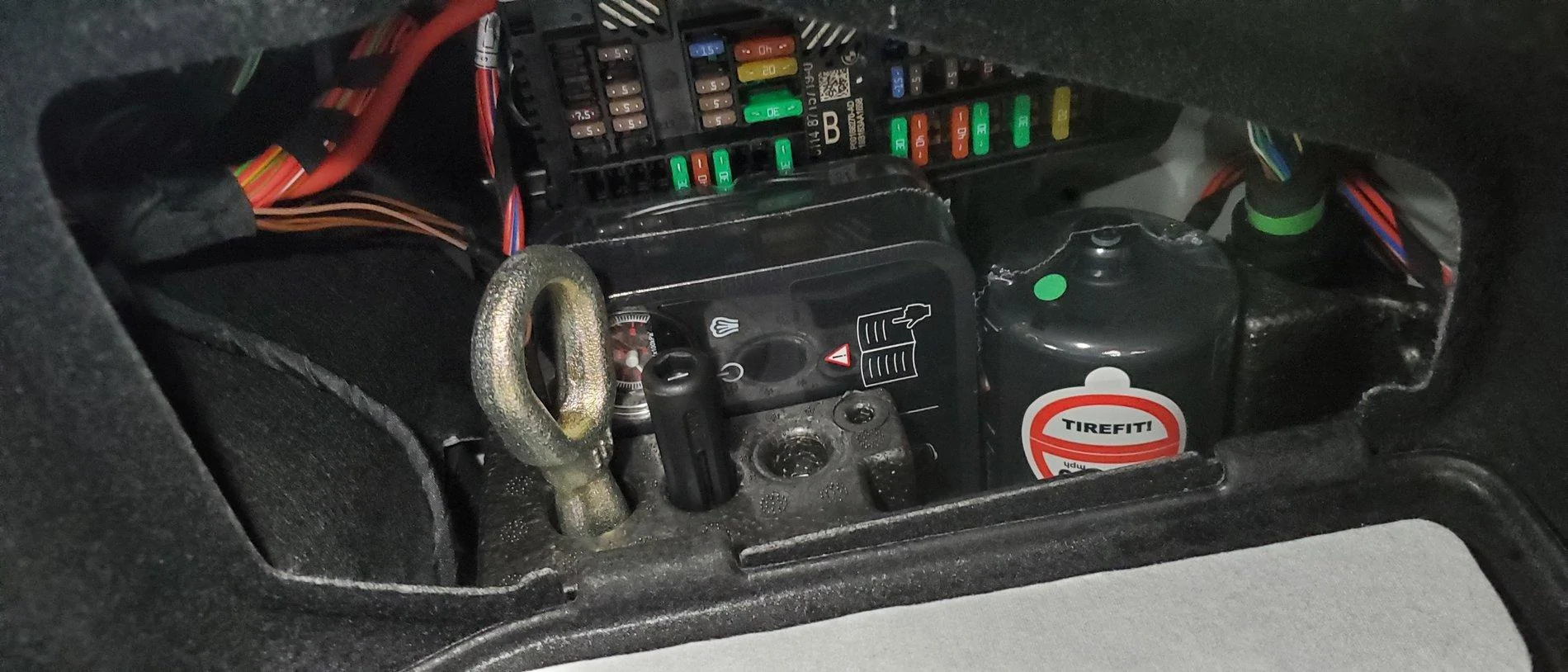

I finally got around to exploring the back of the car and the "emergency" kit that was added to boost the dealer price. There is not much to help in trouble. In the fuse panel area you get a tow eye, a little screw driver, an inflator and the goo canister. The inflator does not appear to be something you can activate without the canister plugged in. I unwrapped it and hooked it up to a different car- and no matter what I did (including prodding the canister port with the little bmw screw driver) I couldn't get that sucker to turn on.
In the emergency kit there is not much to help either, it is more of a survival kit. There are some gloves, rain parker, mylar blanket, jumper cables, flashlight-
There is no concept of a scissor jack anywhere or any way to get the wheel off preloaded. Even the warning triangle compartment is empty but that might be the NA market.
So to slightly improve my chances of survival, I am ditching the goo canister and inflator for an inflator that does not require the goo canister. I also added a proper tire patch kit to the emergency kit (reamer tool, plug tool, plugs and rubber cement). Sure it wont help with a side wall puncture but there aren't much sidewalls and nothing short of a donut will get you out of that kind of flat anyway. At least with a proper plug you wont ruin the inside of the tire but it requires an inflator that will not defeat the purpose.
While still no way to lift the car, I also added a ratchet that is capable of pulling off the lugs. One "less" component to worry about if the wheel needs to come off.
