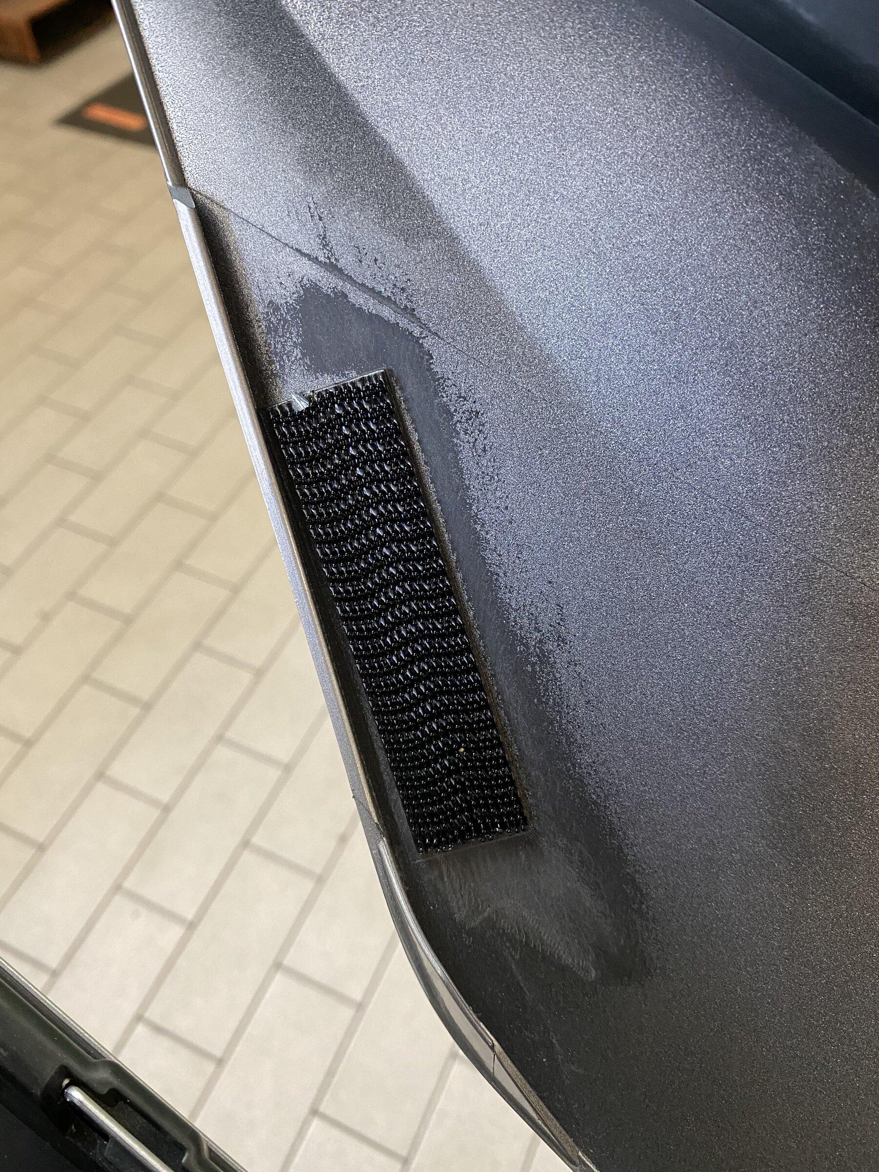

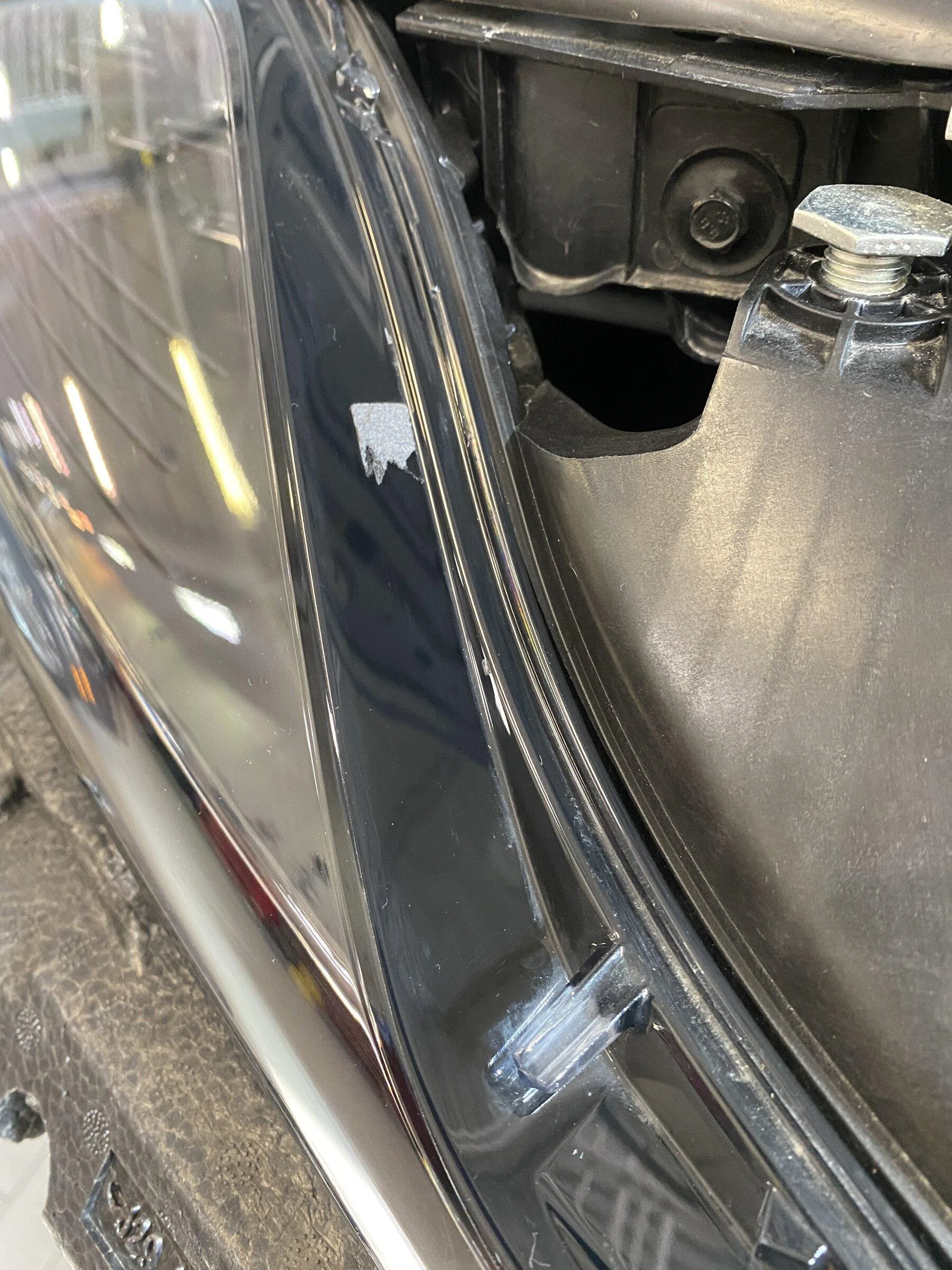

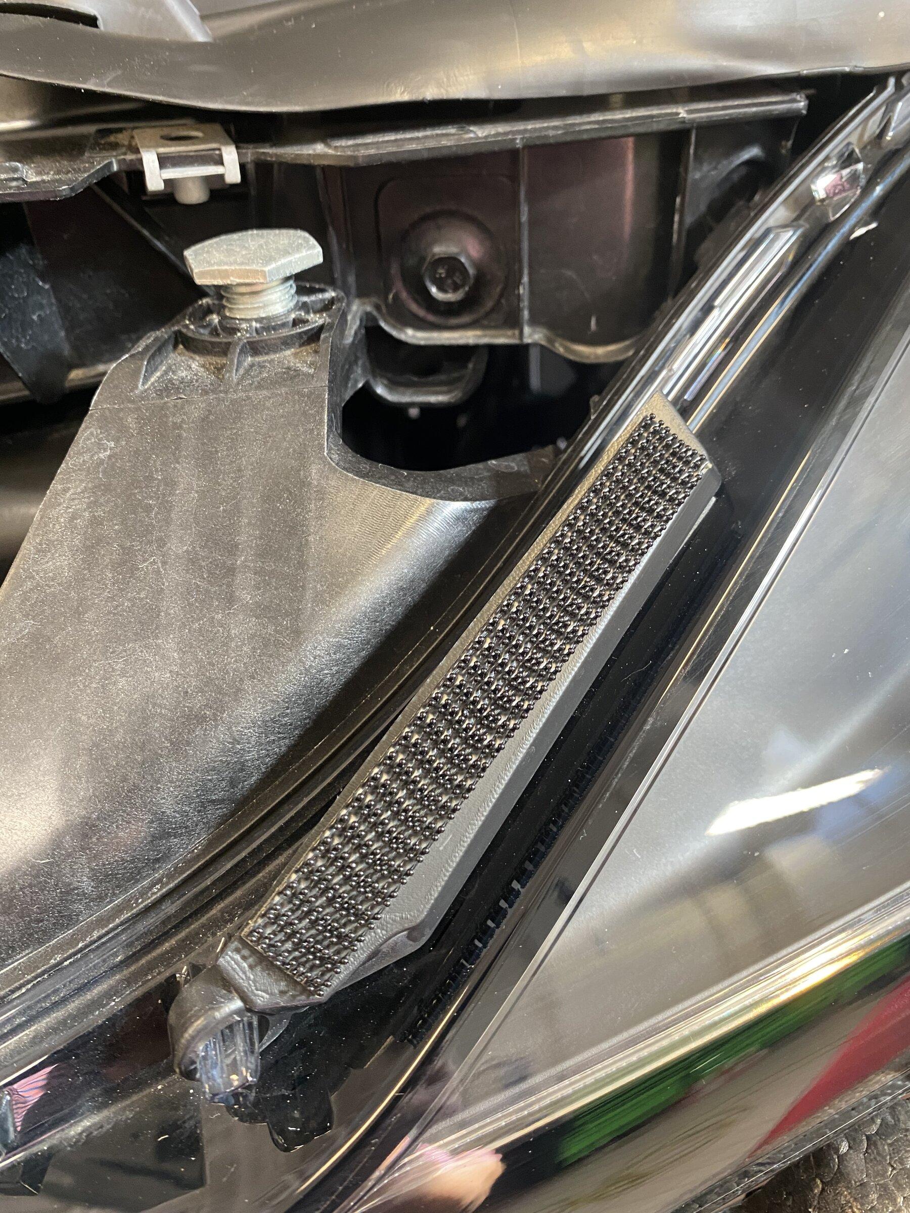

It may be one of the Velcro pieces next to the headlight for they come loose (double sided taped to the headlight) creating the possible binding at the nose. See a photo below.

I’ll double check that in the morning. The velcro was definitely there, but maybe part of it moved.
I’m getting big gaps on the inside points of the headlights that’s making it impossible for me to line up the rest of the bumper.
Top portion goes on great, though.
