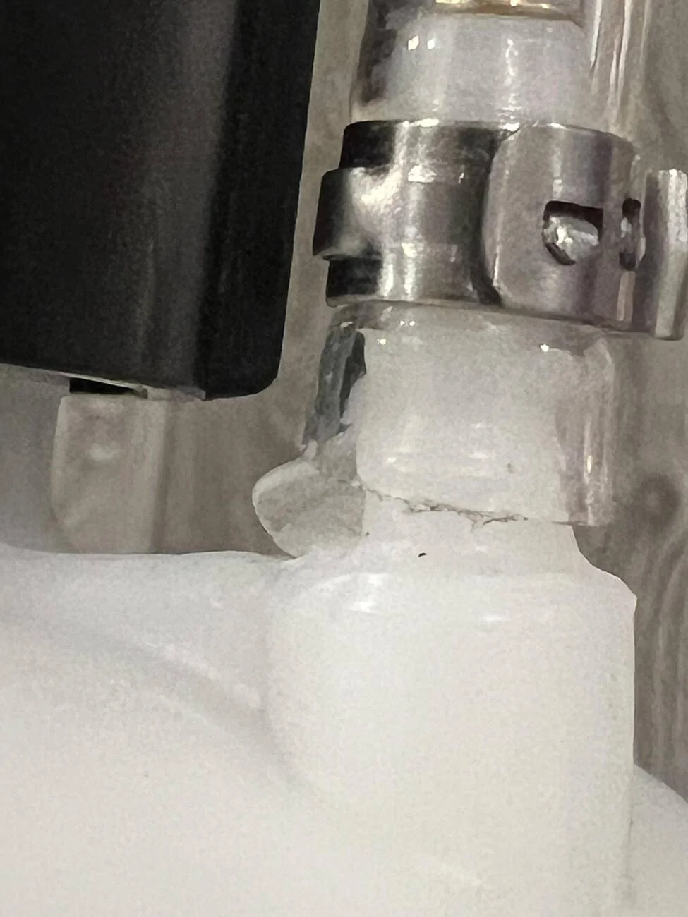

Just attempted the CVD delete this afternoon. Everything seemed to be going ok but the Motive 0100 wouldn't keep its pressure before I attempted to bleed. Spent hours trying to figure out where the leak was coming from and second guessing myself putting the rubber spacer that was removed with the CDV back in and out on the master clutch cylinder and messing with the slave clutch cylinder for hours until I realized (I think) the problem was with the Motive power bleeder...
I tried covering the hole at the end of the Motive 0100 cap with my thumb and create an air tight seal and the pressure is still not holding. The plastic at the cannister valve seems to be oddly shaped (as seen in the pic below). If this was the problem (not sure if it is), I find this incredibly annoying as the whole purpose of this product is to detect leaks. I have a new replacement Motive 0100 power pressure and another bottle of DOT4 brake fluid inbound while my clutch pedal is on floor because I leaked so much fluid trying figure out where the leak is coming from.
Ironically, the day you posted this comment was the day I was finally able to bleed my clutch after removing the CDV. I also had issues trying to use a Motive power bleeder. Initially, mine was leaking out of the box from multiple places. I tightened all the joints and all seemed well. I was bleeding the clutch line and was almost done, then out of nowhere I got a huge surge of air and fluid out. Perhaps I opened the bleeder too far? But regardless, after that no matter how much I continued bleeding with the power bleeder, all I was getting was straight air with very little fluid. The level never dropped below max.
After pumping up the bleeder and pumping it up over 15 times, I gave up on the power bleeder. At this point, the clutch pedal was stuck to the floor and the cylinder was full of air. I tried the pedal pump/hold method to no avail and also tried a vacuum pump on the bleeder. The only method that finally worked was to reverse bleed the system. I purchased a reverse bleeding kit from Amazon that is basically just a syringe and tube. Here's the link.
Amazon.com: Lwuey Brake Bleed Kit, Hydraulic Disc Clutches Bleeding Kit 100ML Syringe 50cm Hose Oil Fluid Extractor Bleeder Tool Universal for Motorcycle Motorbikes Scooters Quads Brake System Repair Maintenance : Automotive
This worked amazing although is a two person job. I had my wife standing near the reservoir watching for bubbles and to let me know when the reservoir was about to overflow. I pushed a ton of fluid into the system before the level in the reservoir even started to move, indicating the system was full of air. I probably did 4-5 syringes before the level started rising at the same rate as I was pushing fluid into the system. The clutch pedal finally went back to normal and I was ecstatic.
glad everything worked out for you. I wonder if you ran out of motor fluid in the bleeder reservoir.
