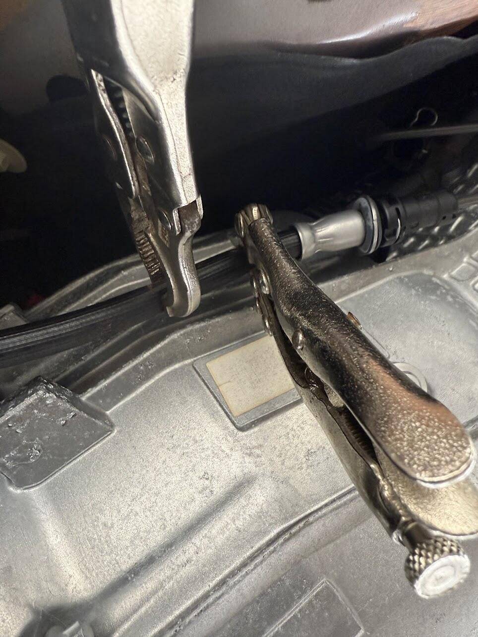

Did this today.
Took ionno 1.5 hours including jacking the car up and bleeding?
When I unhooked the line to the slave cylinder I lost maybe 1 or 2 drops total, that's it. Probably because I double clamped the soft line lol
To bleed I did it the old fashioned way with my wife pumping the clutch pedal 5 times then holding it as I cracked the bleed screw on the slave cylinder. It took 4 pump cycles to clear the line of any air, probably about a quarter cup of brake fluid was lost that I had to replenish.
First impressions:
I'll start off by saying neither my wife nor myself have ever had an issue driving/shifting the car with the CDV in.... however this mod is still very much worth it because I now have a consistent clutch engagement point between any set of gears. And if it prolongs the life of my clutch, that's just a win/win in my book. Highly recommend doing this mod!
