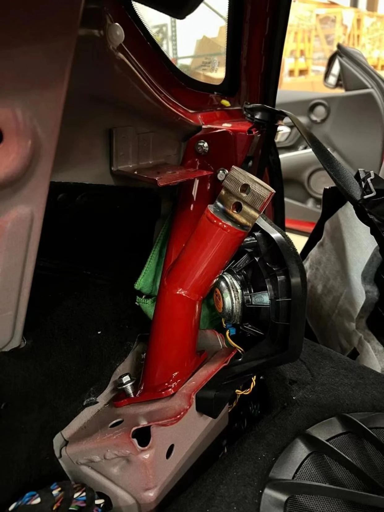

Bolt on cages must have 3 bolts on each mounting plate at minimum. that's the current rule at NASA.
Yea that thing isn’t going to pass any NASA tech. Unfortunately time trials like grid life, etc are very “light” on rules. Even the SCCA Time Trials rule book states only 1 bolt needed, which is unfortunate.

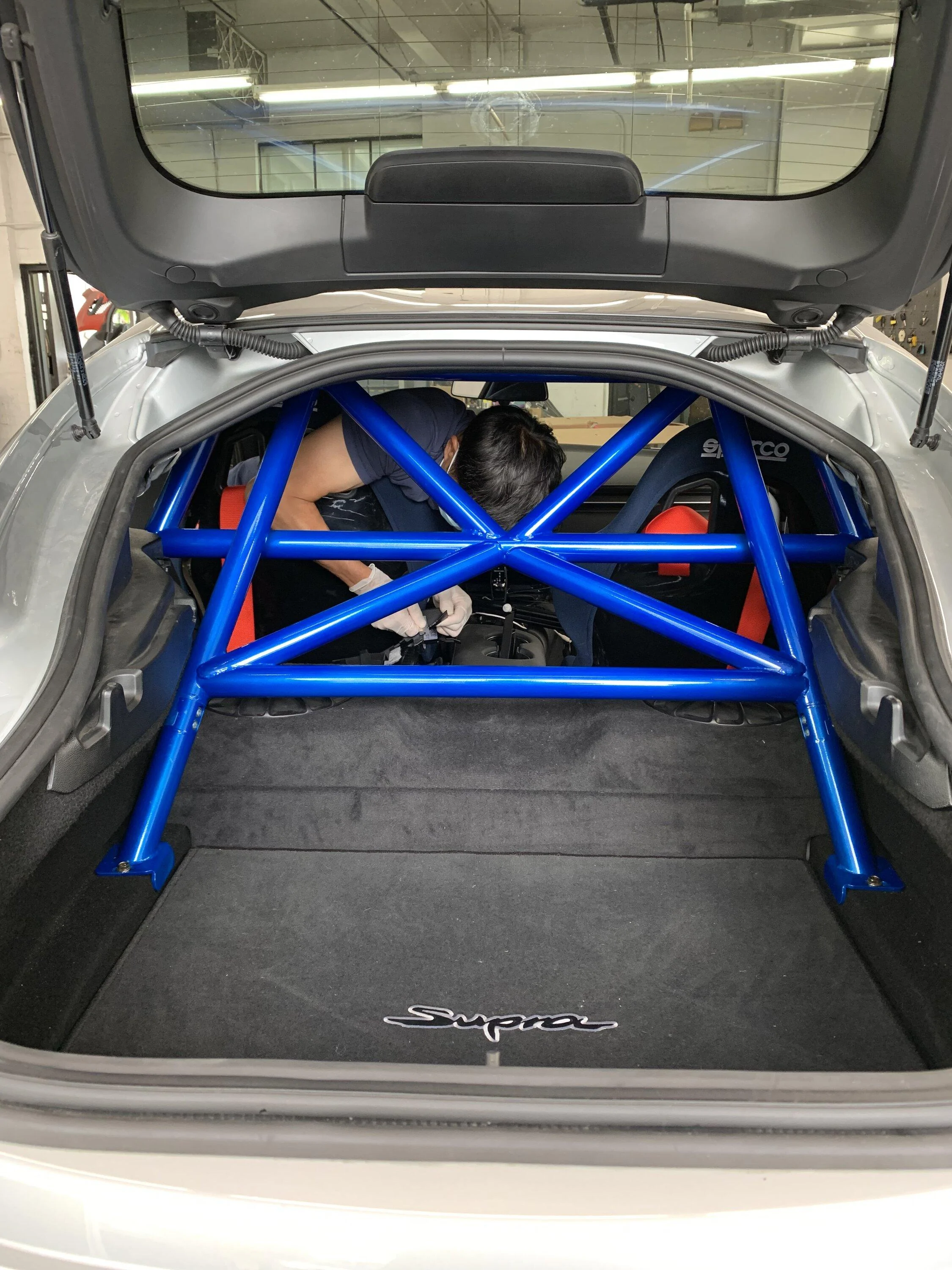

It appears that another popular option, the Studio RSR cage, also uses < 3 bolts on their mounts.
I'm assuming this would not pass NASA as well (even though their claimed "NASA Racing spec")? Are there any bolt-in cages that have the 3 minimum bolts on the mounting plates for Supra currently?

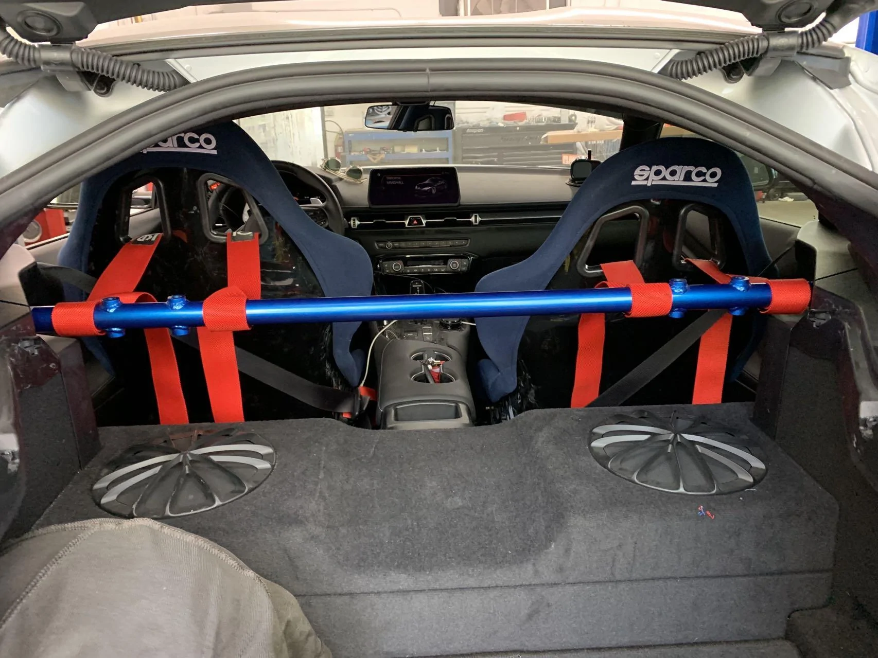

Wow waking up to lots of discussions! Indeed, this is a roll bar rather than a roll cage required for most full-on W2W racing, which I'm not gonna plan on doing with this Supra anytime soon.. For TT and trackdays this should be a great option considering the better material used, lighter weight and mounting positions.
Btw the Cusco roll bar is still up for grab..
