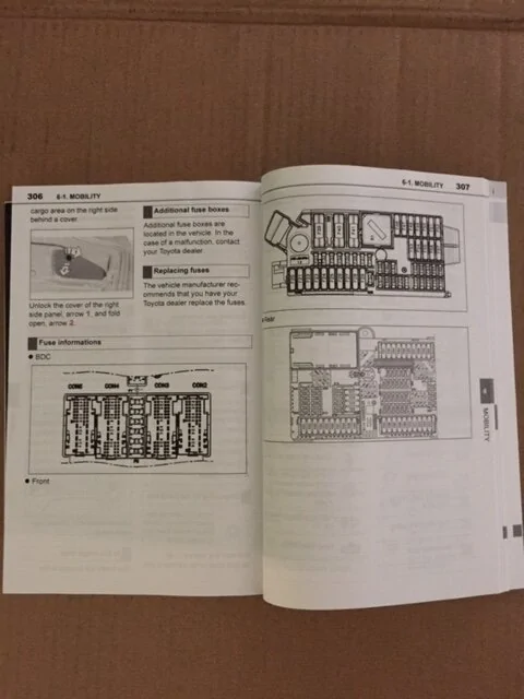

I am having some trouble locating a fuse box, I have a 2020 Supra and the right (passenger side) headlight is out, the plug from car to headlight has no power to it. The photo I posted is from the manual and the first photo indicates it is located at BDC, I have located the Front and Rear fuse box's, however I can not figure out what BDC stands for. I removed the panel from the drivers side dash below steering column but no fuse box there. I am trying to locate F1 and F3, possibly they may each feed each headlight. Thank you for taking the time to read this.
Dave
The fuse panel, in the front, is on the passenger side in the footwell.
Yes, I have located that one, it is the one on the top of page 307, the one I am trying to find is first photo under "fuse informations" indicated location is BDC. It is a bit confusing as at the bottom of the first photo the dot with Front is just below photo and BDC is at top left of photo and looking at page 307 the fuse box with the dot Rear is the bottom photo location at top left of photo.
