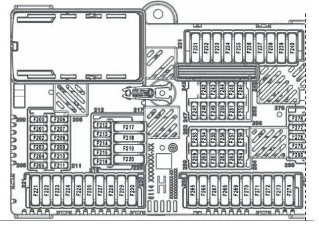

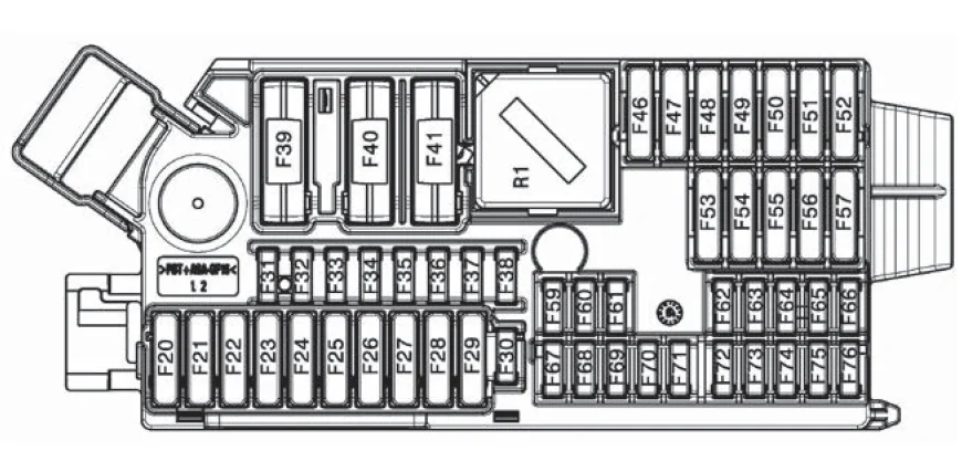

I believe that references the ECU (computer) for body domain. I haven't looked for the headlight fuse(s) so can't help with that. Here are a couple of blow-ups of the fuse panels (easier to read):

I believe I have located the BDC below the Front fuse box, however there does not seem to be any fuses in the BDC but it does have "com" references as the photo indicates. It is behind the floor padding on the right side of the passenger foot placement. I did remove the 60 amp fuse F39 and it checked out ok, still no power to right front headlight.
Out of frustration I unplugged everything and plugged it all back in and BOTH headlights work! I want to thank you all for taking the time to help, so far there seems to be no indications anything is wrong.
Glad you were able to reset it. My thinking is the body domain controller rebooted and cleared a glitch. Other less serious glitches have been known to happen (ie: door locking). Sine this car has dozens of ECUs, it’s not all that surprising. Computers are, after all, computers.

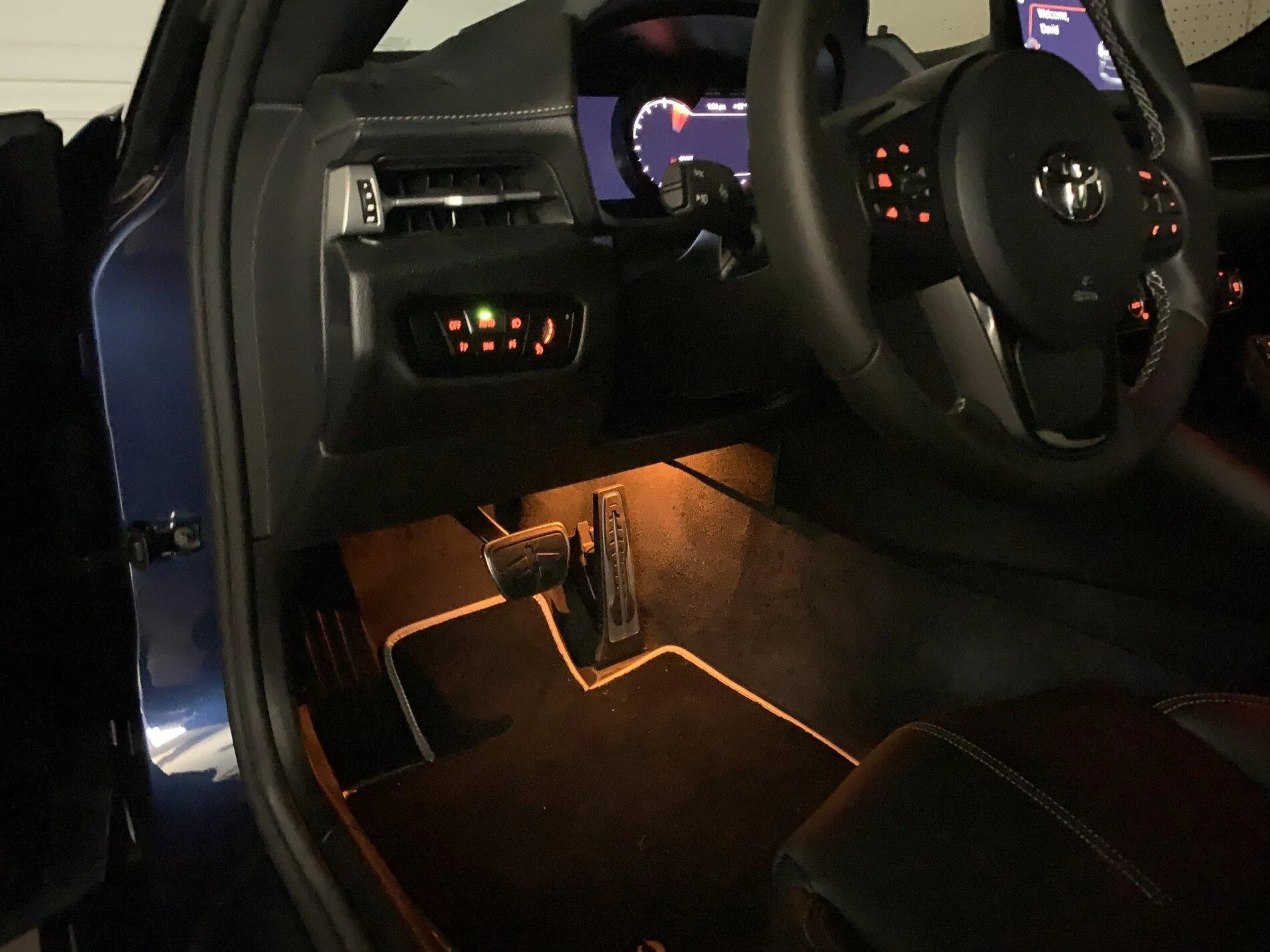

I finally installed mine as well...I just used one of the courtesy light fuse locations.

I tapped into F62. The floor lights stay on while the car is running but turn off 6 minutes after locking.
If anyone comes up with a better solution, some of us are listening.

I decided to revisit this project as well. I'm bummed that the lights don't work with the courtesy lights but these aren't super bright so they won't be distracting during the day and should look good at night.
I purchased these: https://www.amazon.com/gp/product/B01AFU4QCM/ref=ppx_yo_dt_b_asin_title_o00_s00?ie=UTF8&psc=1 the first time I did it I tried the 11mm lights and found them too bright for night driving. These are the 6mm amber lights.
Thanks to everyone who contributed to this thread.

I used LEDs which have a variable brightness control in order to tailor them to my liking. F62 (front fuse panel) shuts down 6 minutes after the car is locked.
Your install looks good.
