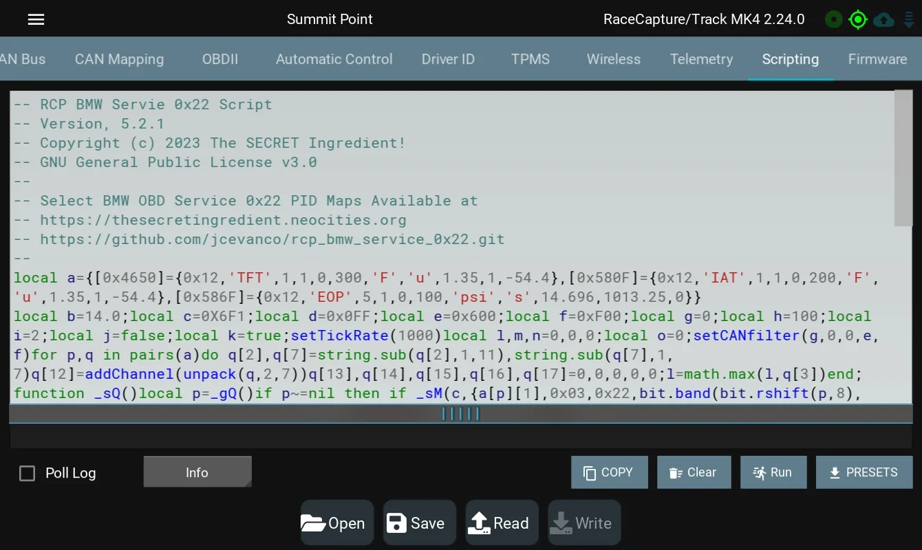

I believe diff temp is on a different CAN...however I did get transmission temperature working (TFT -transmission fluid temperature) with the LUA script that's available; I tweaked the script a bit to only pull IAT (post intercooler), TFT, and Oil pressure, because it polls the extended obd2 parameters. If you want assistance with transmission temp happy to help.

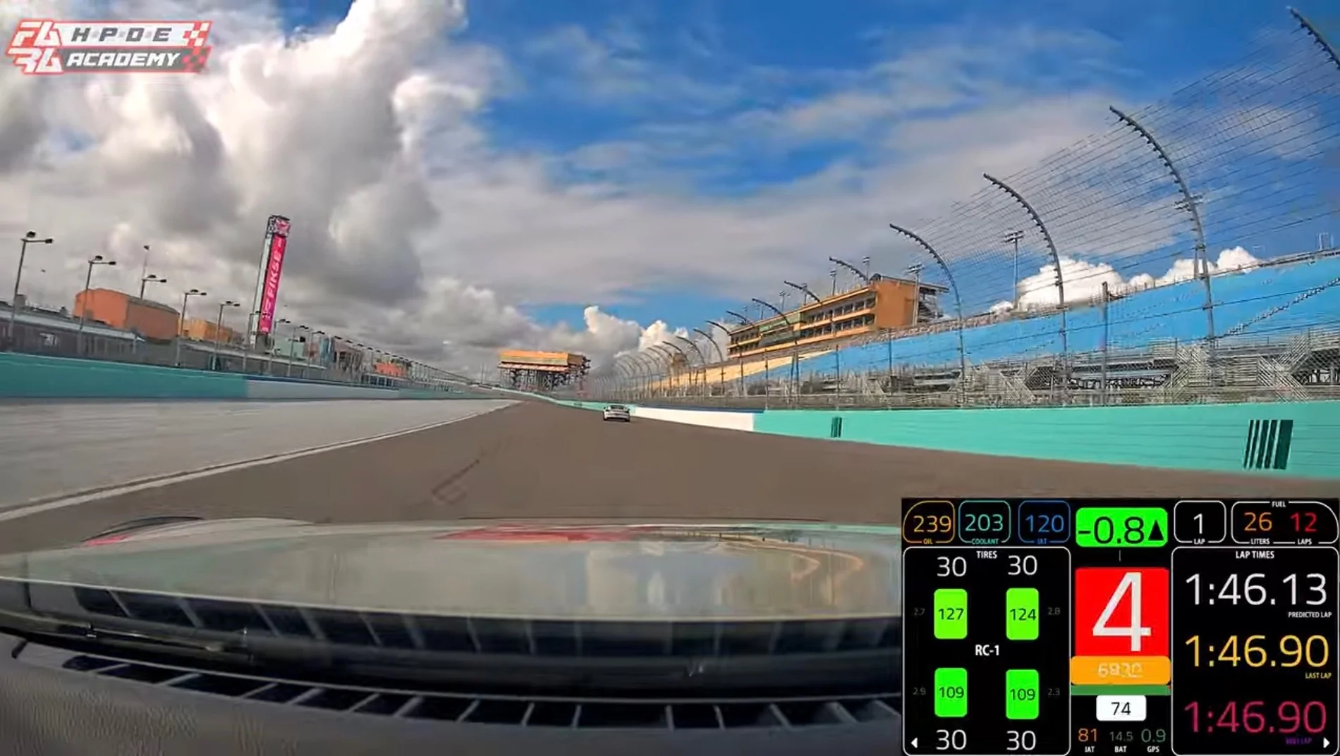

Watch this. Min 6 or so on the video

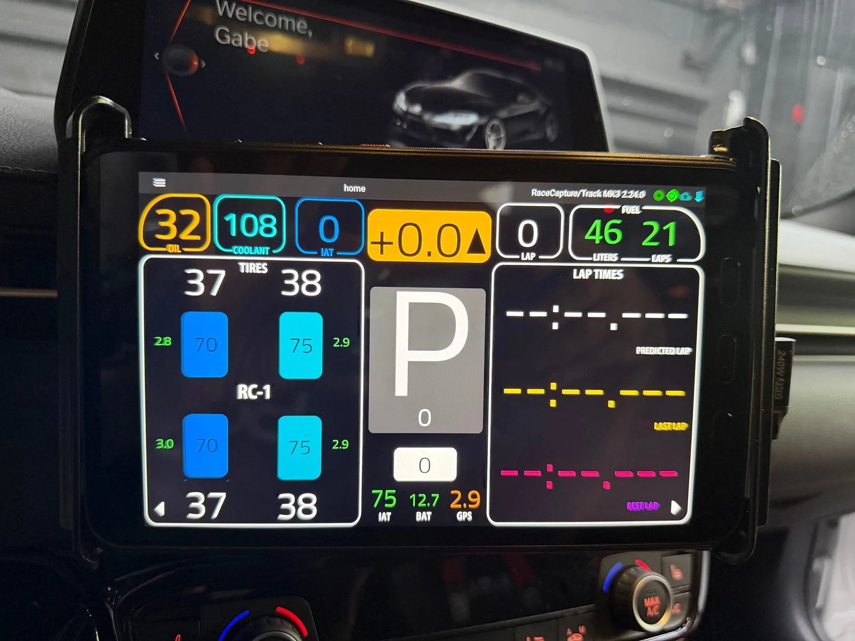

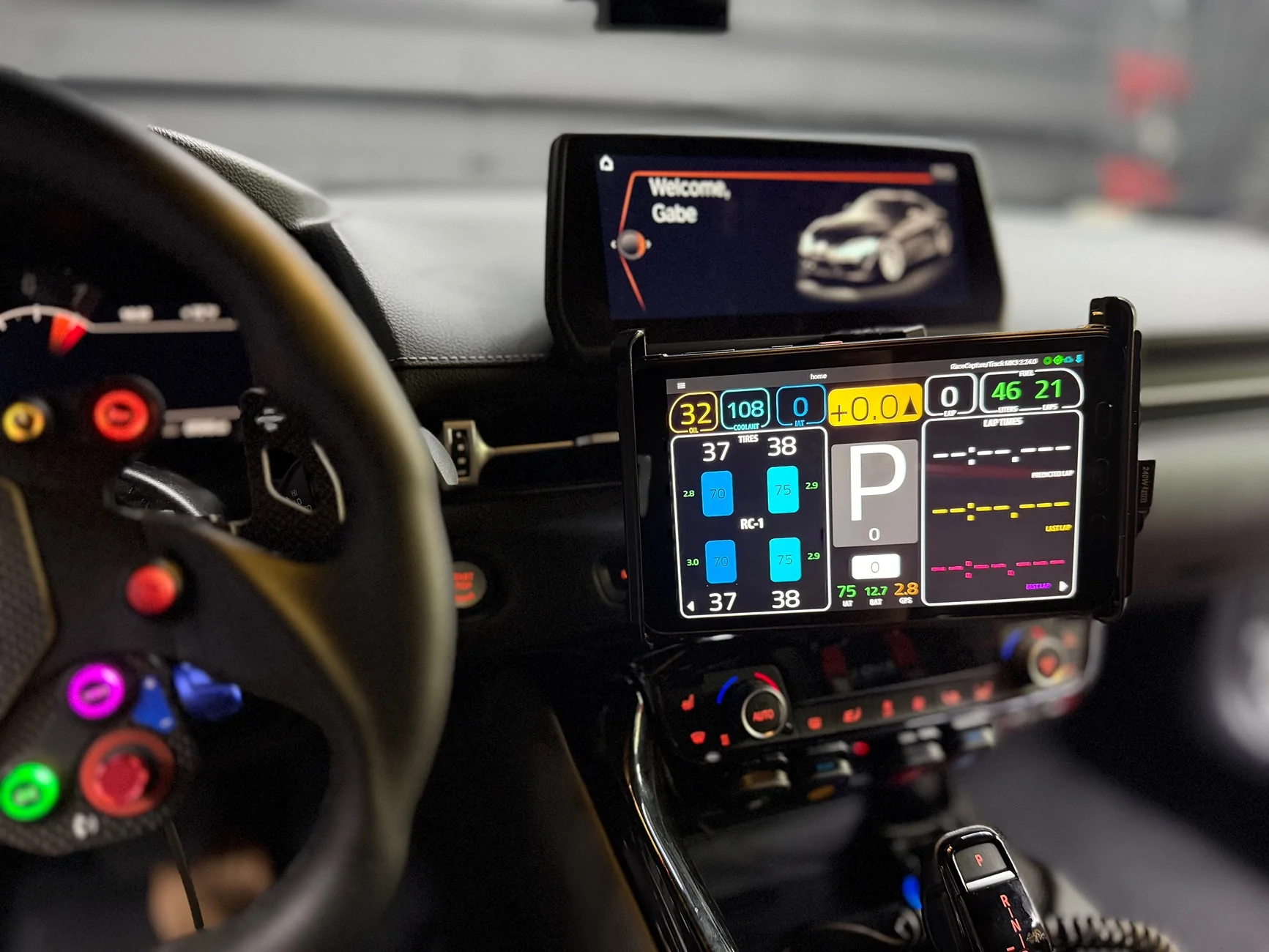

yes. I personally LOVE RaceCapture. I designed my own Race dash screen and have been using it on Track weekends and Time trials for over two years.
You can see it on the video in action throwing some engine oil temp warnings (was done on purpose to test the actual warning system)
