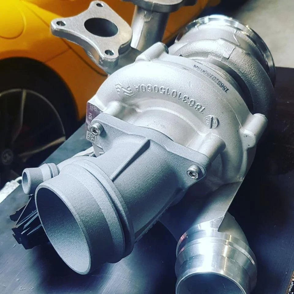

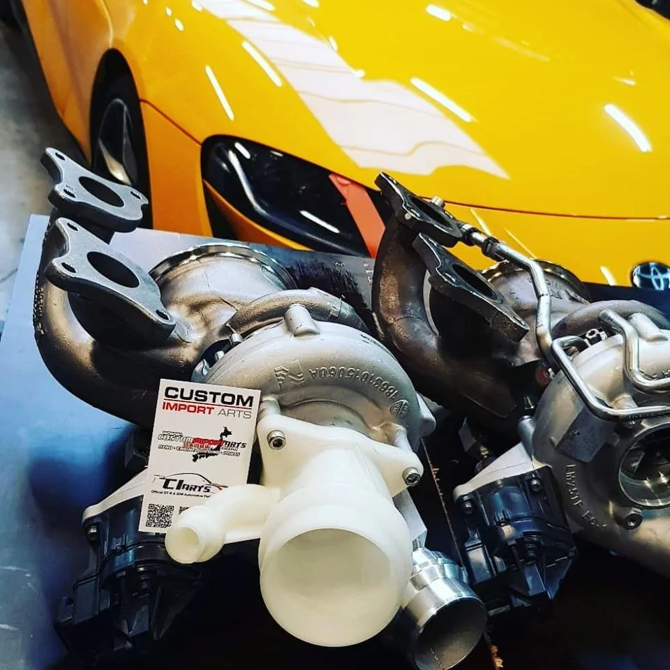

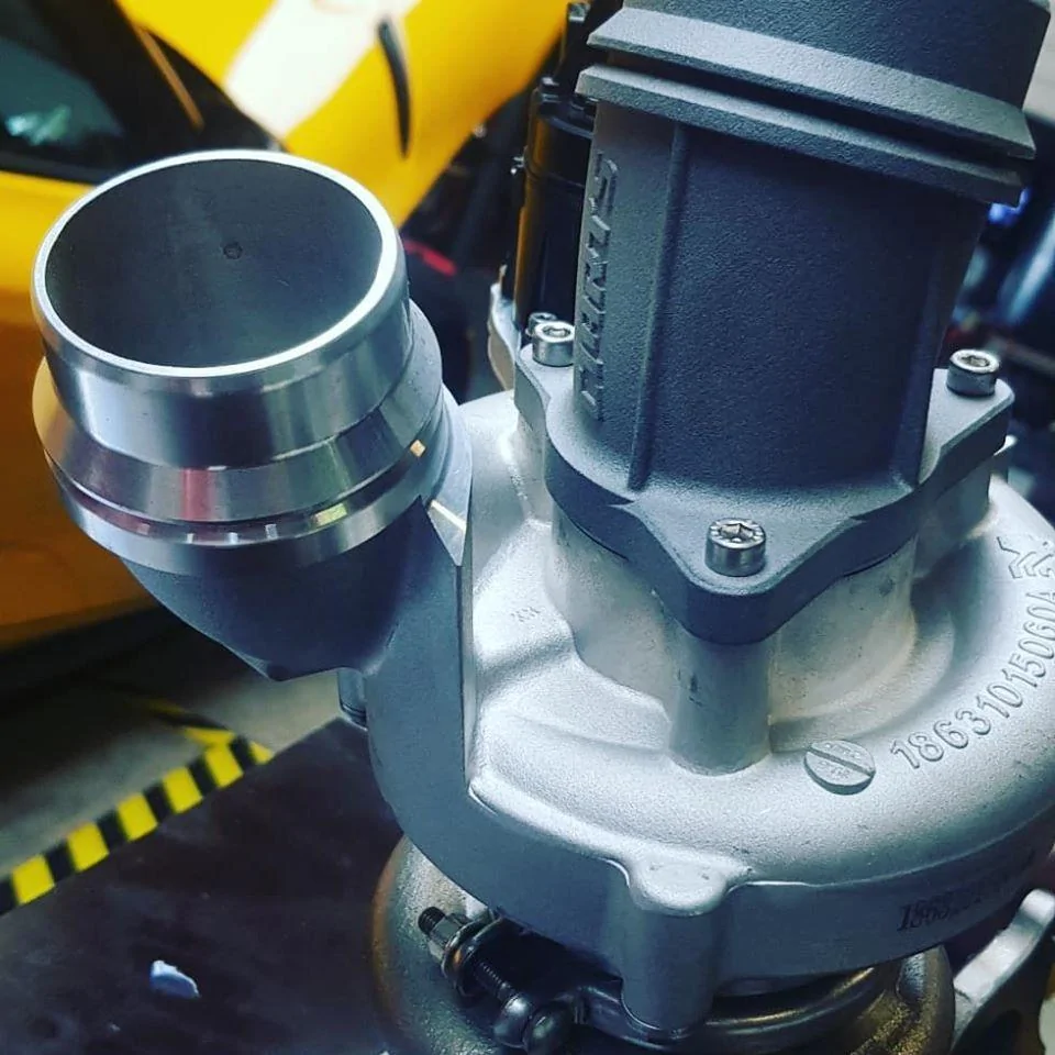

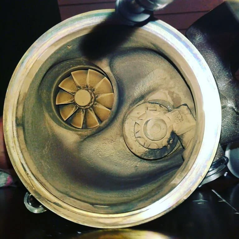

Turbo has been picked up today
Custom Import Arts - Instagram account said:
First glimps of a bold on turbocharger for the @toyota @Supra #MKV with the #B58 engine.
This is a custom build centerhousing, nothing of the shelve... this will go in beta test phase next week with the support of a custom designed turbo inlet piping.
Its the next stage of our developement with the #mkvsupra platform in #Belgium at @customimportarts
This turbo was designed and build in #Belgium in cooperation with @asd.performance who facilitates turbo manufacturing for these turbos.
This will be our first step in a stage 3 ( turbo + intake ) upgrade kit.
FOLLOW US to check in with updates.
And a picture of the turbo itself:
Now I need to find some time to bring the Supra to them :)

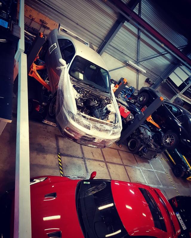

Yesterday evening, I brought the supra to Custom Import Arts
Next week, they will start experimenting with this new turbo and see which results it gives in spool-up, power output,...
And while I was there... seen my R33 GT-R without the engine. She needs a rebuild:

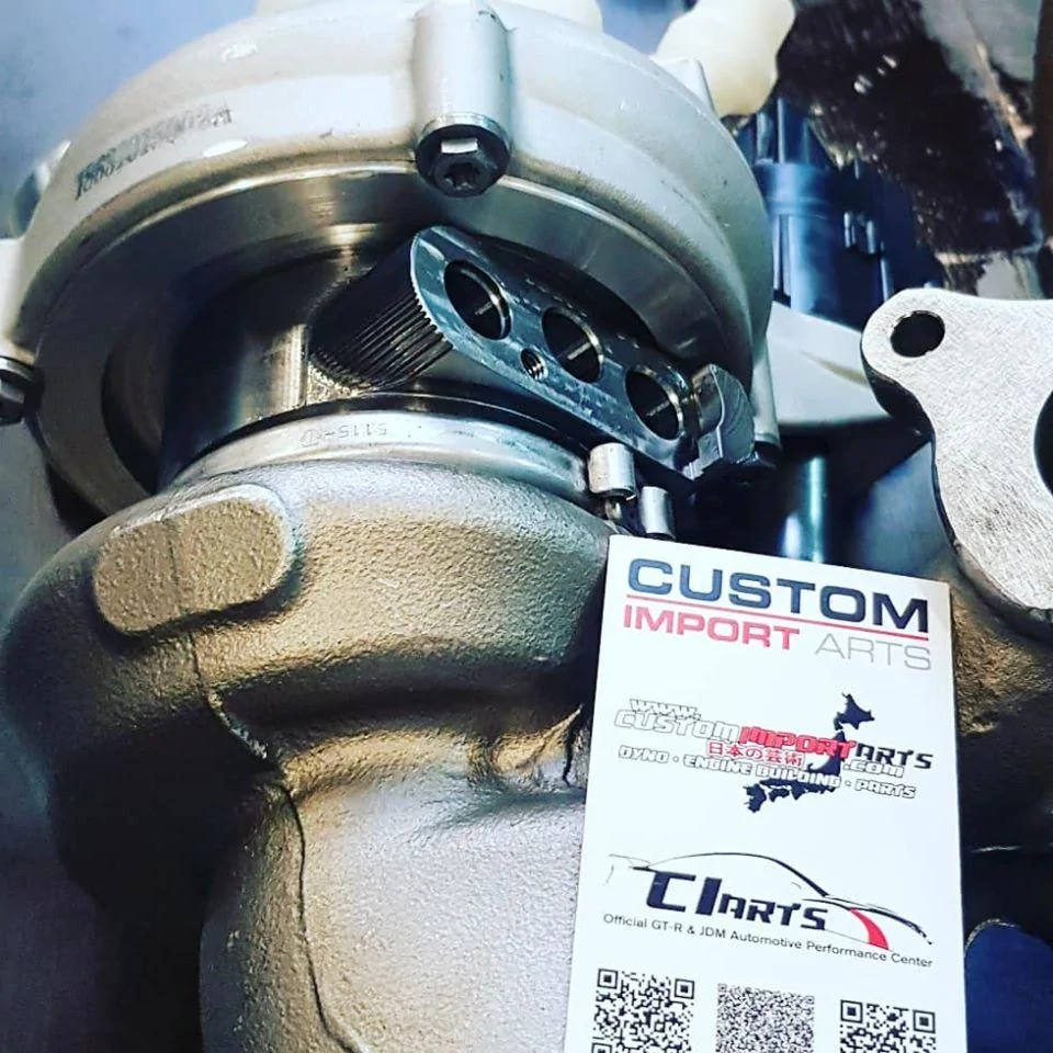

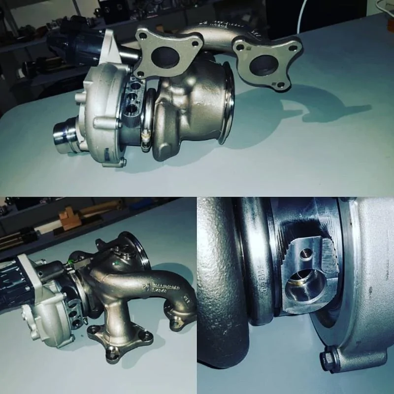

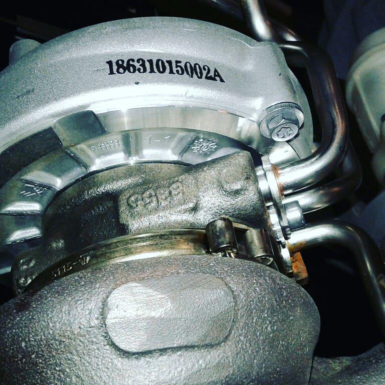

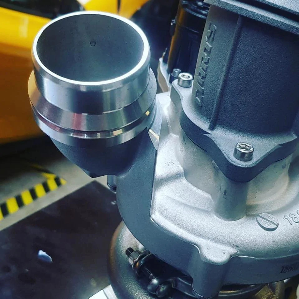

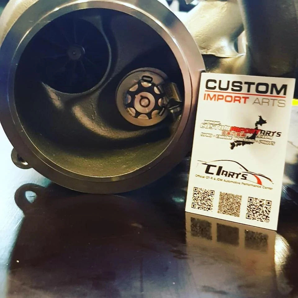

Some comparising pics between the standard turbo and the upgraded one (Original facebook post of Custom Import Arts):
Custom Import Arts said:
More detailed images of our latest development. A stage 3 upgrade for the @Toyota #MK5 #Turbo #Upgrade.
This turbo was designed from scratch and is using a custom designed center ball bearing housing. We then reused the in and outlet housing that was machined for the upgrade turbines.
The challenge was to build an oem intake housing that would fit all oem hardware.
Test fitting is nearing completion and we are waiting on the final production intake tube to get this thing on our @superflowdyno dyno again.
#inhousedesign #solidworksstudio #customimportarts #customwork #raising #thebar

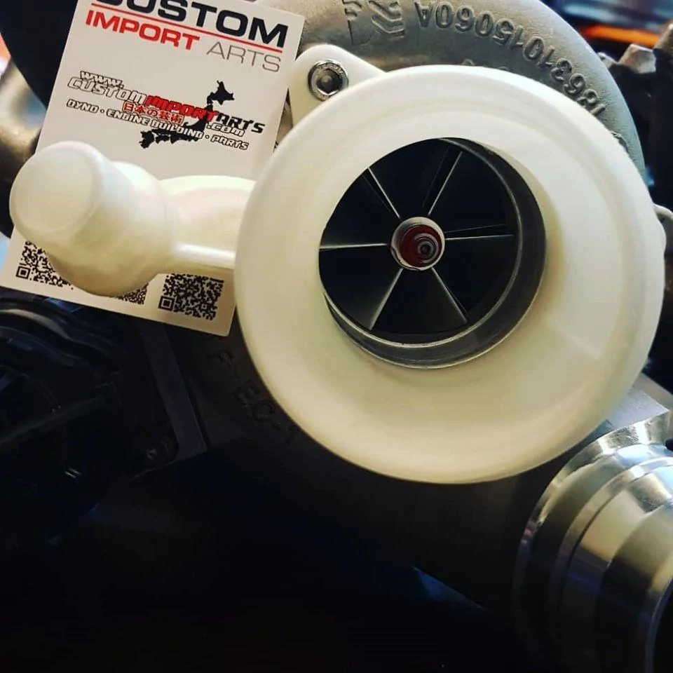

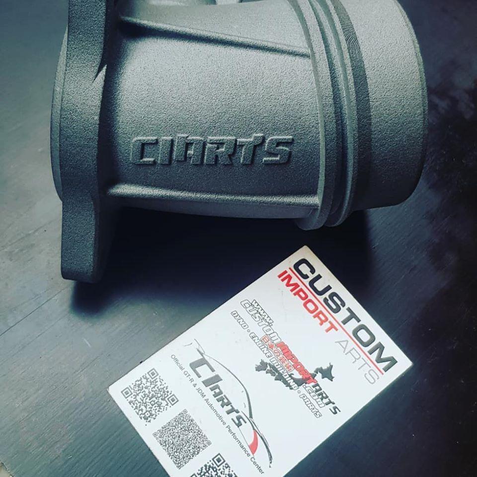

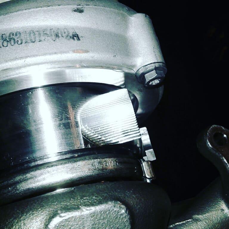

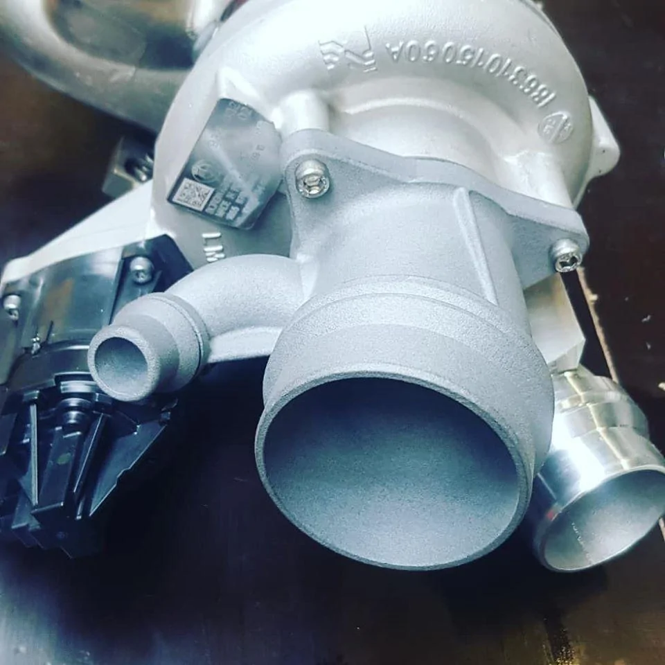

After some delay (due to a corrupt file), the 3D printed piece came finally in today.
If all goes well, the turbo gets installed tomorrow.
Enjoy a few pictures that the people of Custom Import Arts took:

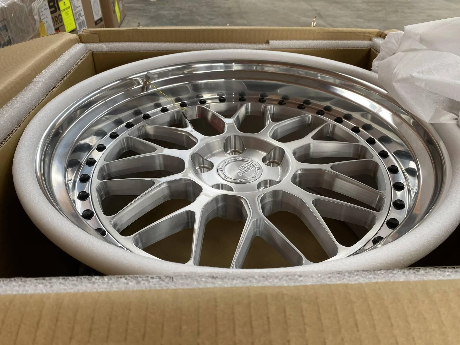

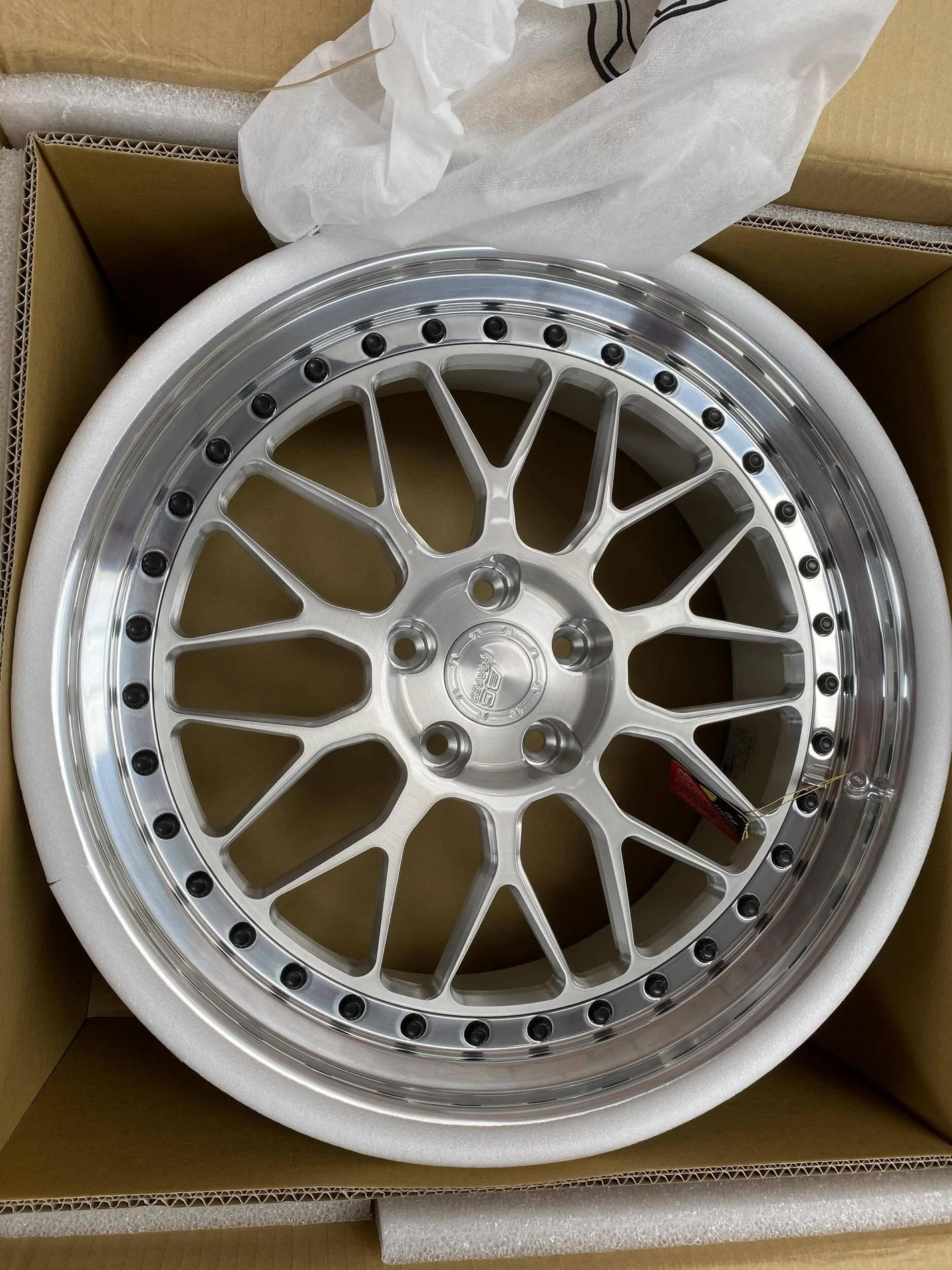

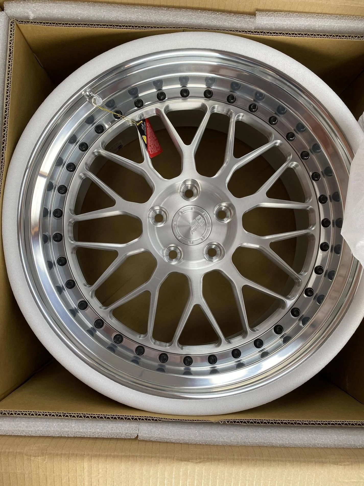

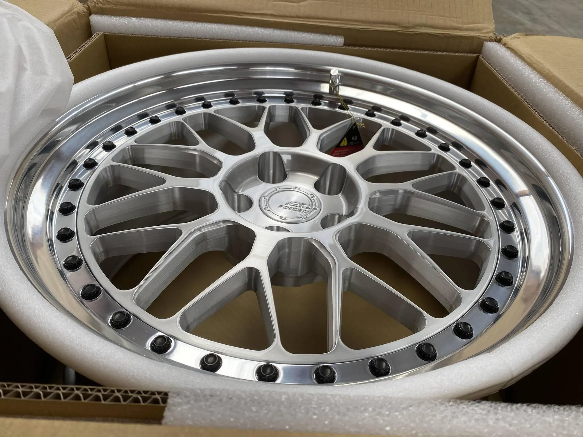

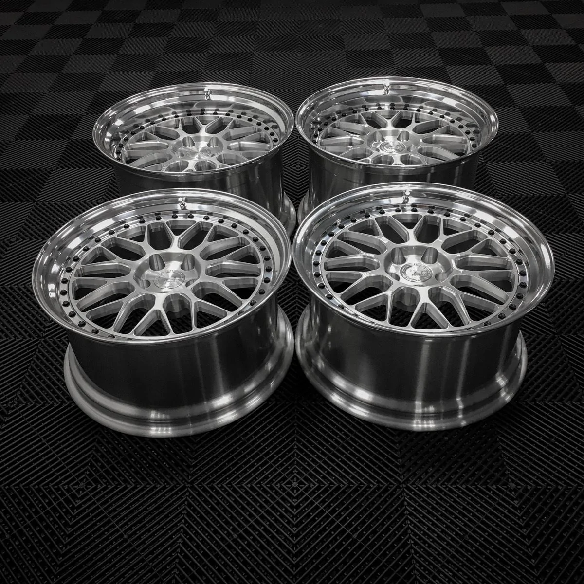

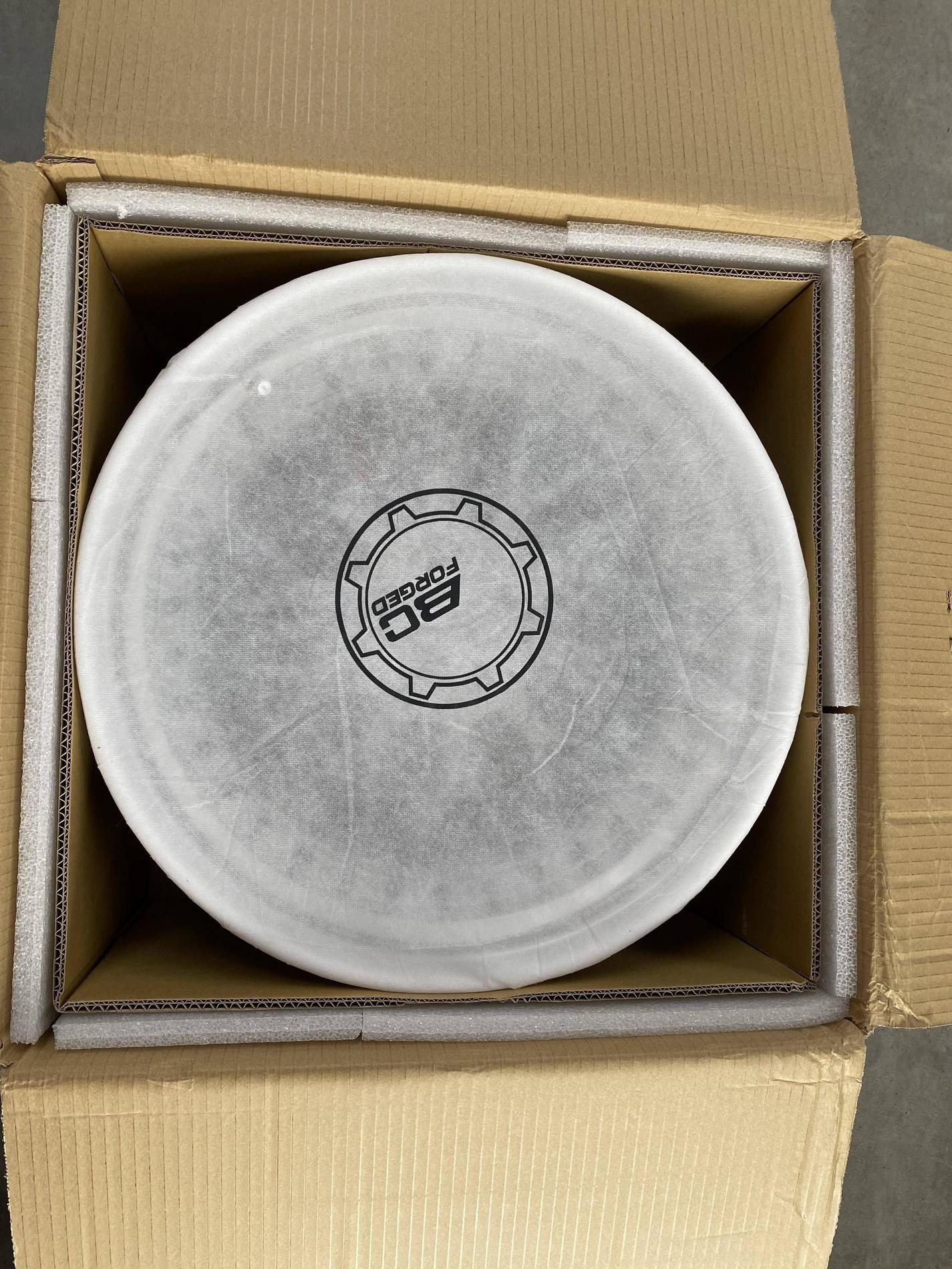

BC Forged MLE81 arrived today
Rear wheels 19x11 ET+35
Front wheels 19x9.5 ET+22

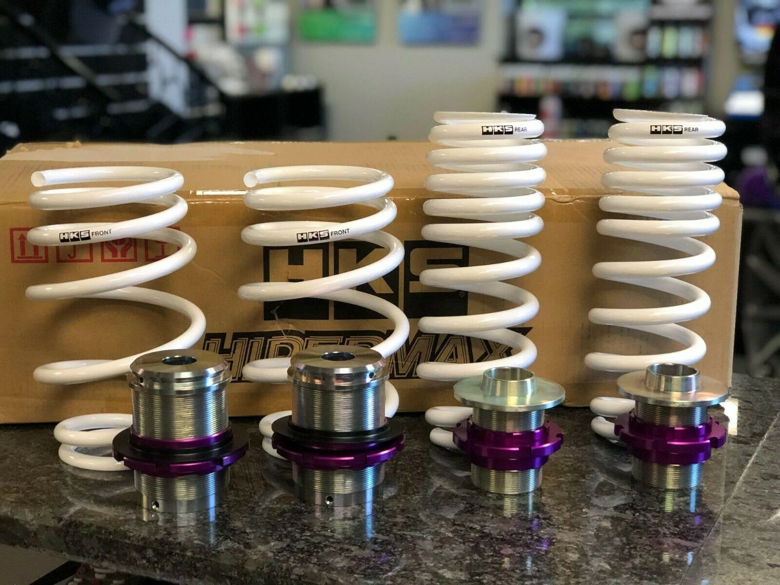

Ordered today the HKS Hipermax Touring kit
I think it is a good trade-off between daily ride and couple times on the track.

Just keeping my thread alive, HKS kit present:
Hope installation happens soon. Not the only car there where they are allowed to work on again :)

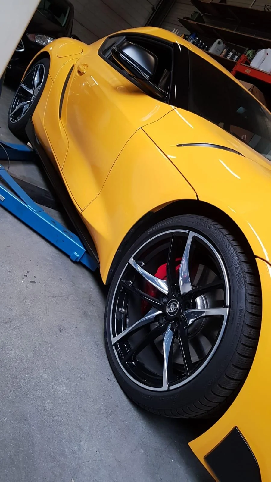

HKS Hipermax touring installed:
They expect that it will still get lower from the moment they start driving with it, springs getting little softer.
If it is not raining this Saturday, Custom Import Arts will take my Supra for a drive and on Monday check the allignment.
