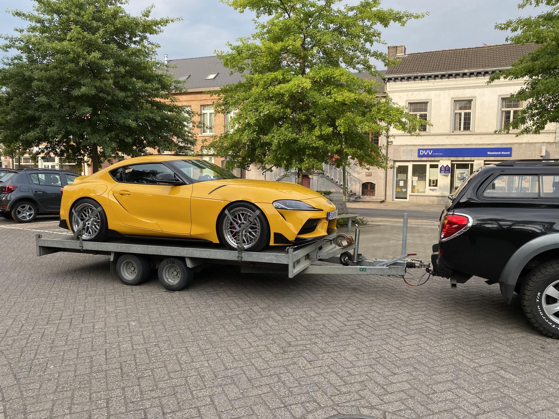

Sad news today... my engine blew up this morning :(
I was cruising on the highway and took the exit. While I was taking the exit corner, suddenly the car started vibrating.
First I thought there was something wrong with one of the wheels (I was taking the corner at a high speed). But in the straight still vibrating.
So second guess, its the engine, no longer running on 6 cylinders. So I stopped over and checked... yes engine vibrating not ok.
There was only a 'check engine light' for 5 seconds and it went off. No DTC codes were gicing by the car (I read it out with ecutek). REally the car just said... I am fine. Like WTF :eek:
Called custom import arts and they confirmed by just hearing the sound of the engine, that it is not running on all 6.
So I phoned Toyota assistance to tow the car, but they only wanted to tow it to a Toyota dealer, nowhere else.
Luckely Custom Import Arts was able to tow me and they done a first diagnostics.
It is the front cylinder that is having no compression any longer. The spark plug was fine, turbo is fine... one cylinder without compression.
Currently it is a guess what caused it. I did fuel up yesterday, so they will also send some fuel for testing (check if it is not bad fuel).
After calling around with some fellow tuners, it seems I am not the first one with the same problem. Other owners (even with standard non-tuned ones, or stage1 on full cat) are having the same issue.
Next actions
I already ordered a new engine from Toyota as off course waranty is voided anyway (they even had 5 of them on stock... strange for such a 'rare' car)
Once it arrives, that engine will go in the car and we will run a little less psi on it to be on the safe side.
In september/october, the current engine will be opened up and they start building it with upgraded pistons, rods,...
By then, we also hope that the transmission is cracked... to do some serious tuning in november/december.
P.S.: Since the beginnen I knew we would be blowing up the engine at some point, but not now. It was foreseen this winter, to test how much a standard block can handle on pump gas.
In the end, it sucks that the engine is blown up... not knowing why. In a couple of weeks I will be driving again in France and on the racetrack Dijon-Prenois. If all goes well, the car drives again by the end of next week.
Little frustrated as well, middle of the summer... but what can you do.
Really curious how many people/tuners had the same issue here. Or does it only appear on EU-spec cars...
To end... picture of here on the trailer :(

Oh mate that is frustrating news. At least there is some level of diagnosis that’s happening. Will be interesting to see exactly what’s happened to it.
Thanks. One car in the UK is having the same problem (engine block is not opened up there either to check which component failed).
First guess now is the piston ring that broke. But to be sure, engine block needs to be pulled out and opened up. And finding the root cause, who knows... as the ECU is not showing any fault codes at all and I was not data logging on my phone during my drive (which is normal)
The engine aint that expensive as one for a GT-R, but again... money is money and it is still plenty :)

Geert,
sorry to hear of the misfortune. Nonetheless, things could have been worst. All that really matters is that you are safe and sound.
Since you are putting in a new engine, once you disassemble the old engine and find out the damage assessment and the root cause. Let us know what you find.
Kindly document what choice of forged engine internal you will be going with ie. which pistons & rods choice ? Blueprinting and balancing the engine, cylinder head porting and polishing, valve springs, retainers, cams ?

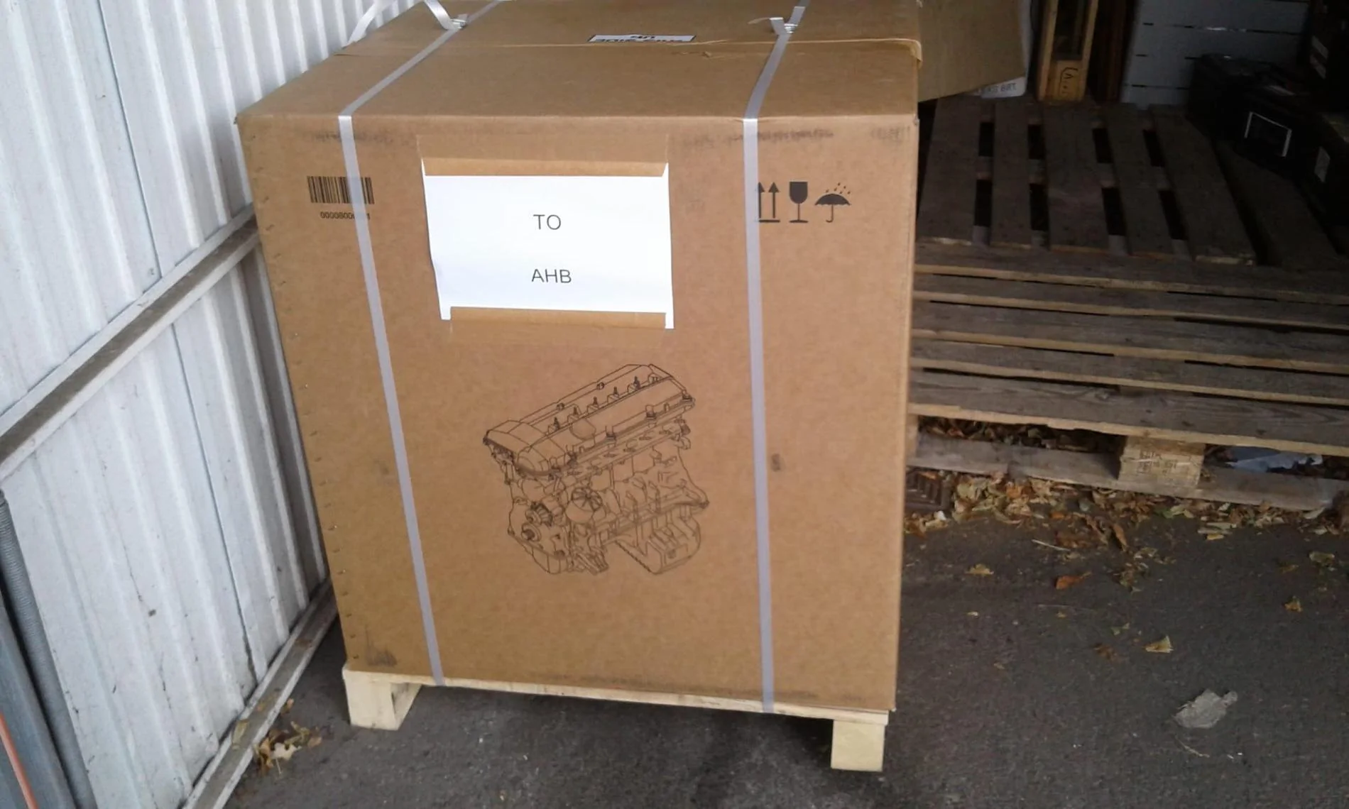

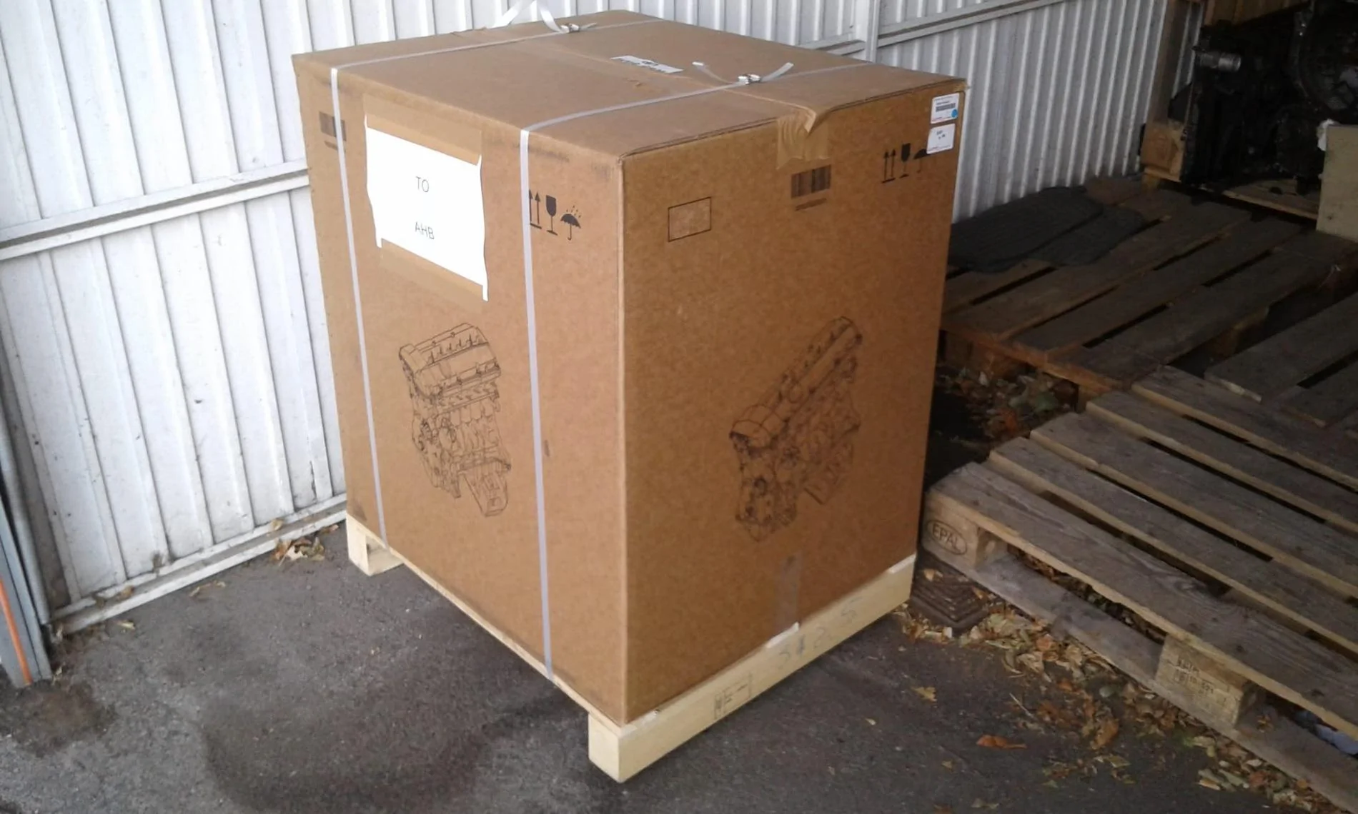

The new engine already arrived, damn that was really fast :)
It was ordered yesterday afternoon, arrived this morning.
If somebody want to know the price that I paid: around 7000 euro excluding taxes (Belgium has 21% taxes)
What was ordered (inlcuding part number):
* Long block B58 supra (19000-WAA02)
