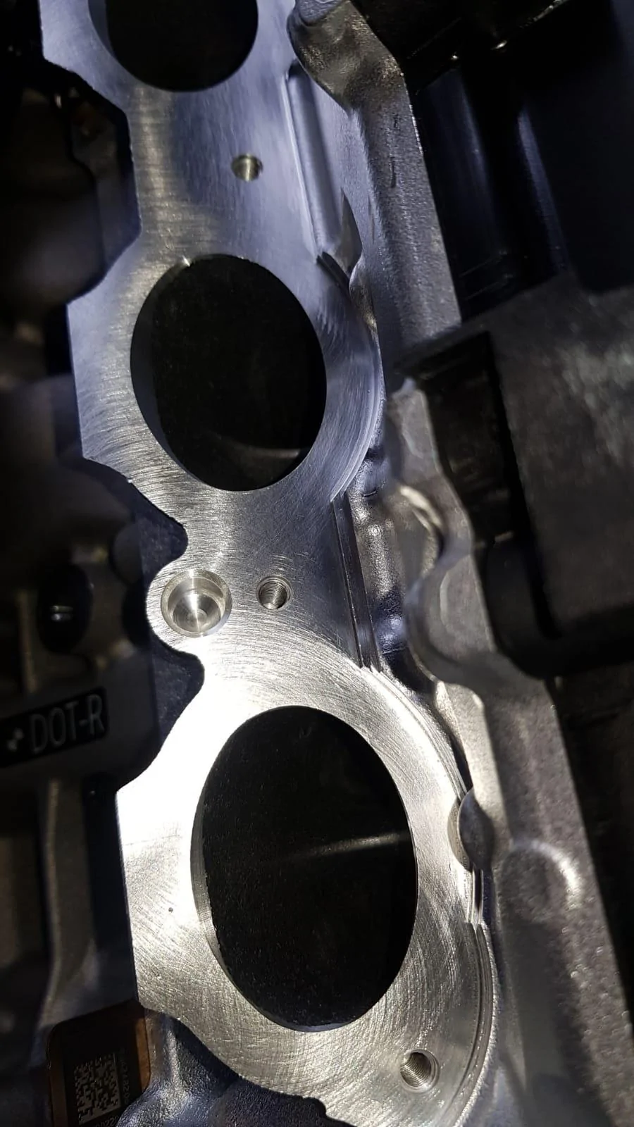

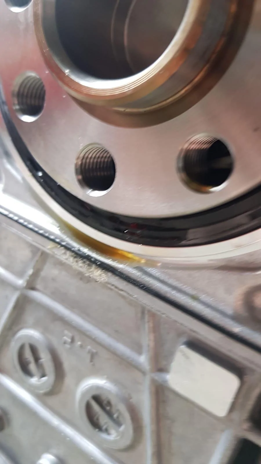

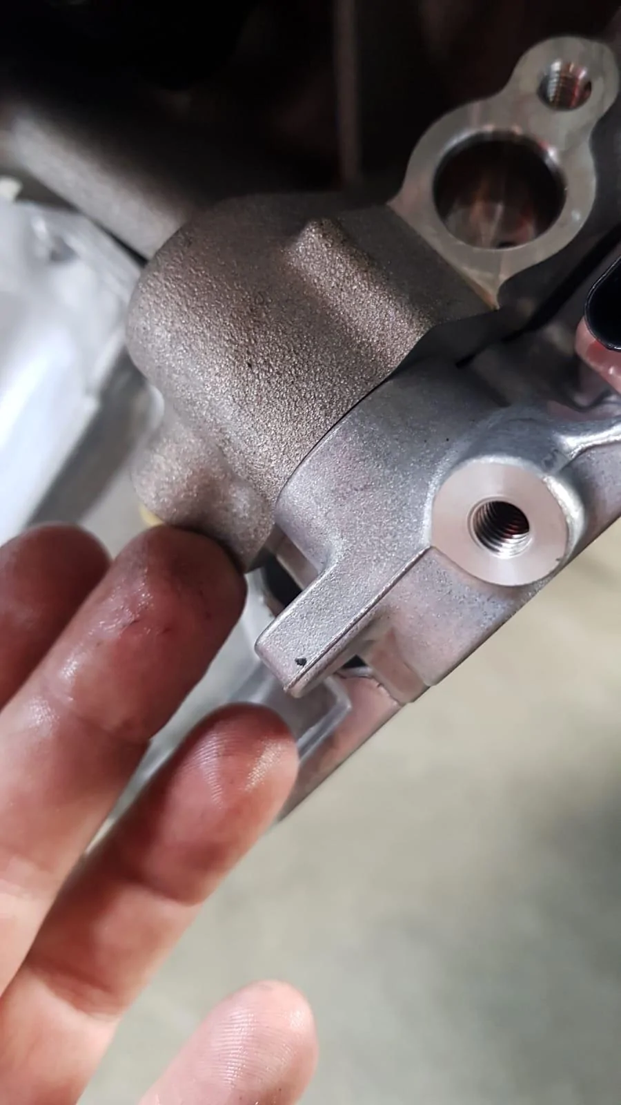

Ass planned the engine arrived yesterday. But again... problems with the engine.
After removing the plastics;
  • there was oil leaking out
  • sand on the engine,
  • the intake and orher holes where not sealed ,
  • some dirt on the intake holes (who knows if some is inside)
But we have no choice to put in this engine... as I need to drive next weekend for the roadtrip and track.
On monday, we will file an official complaint at Toyota Europe. Cause in no way, you can be sure that this engine will not break in 10-20K kilometers

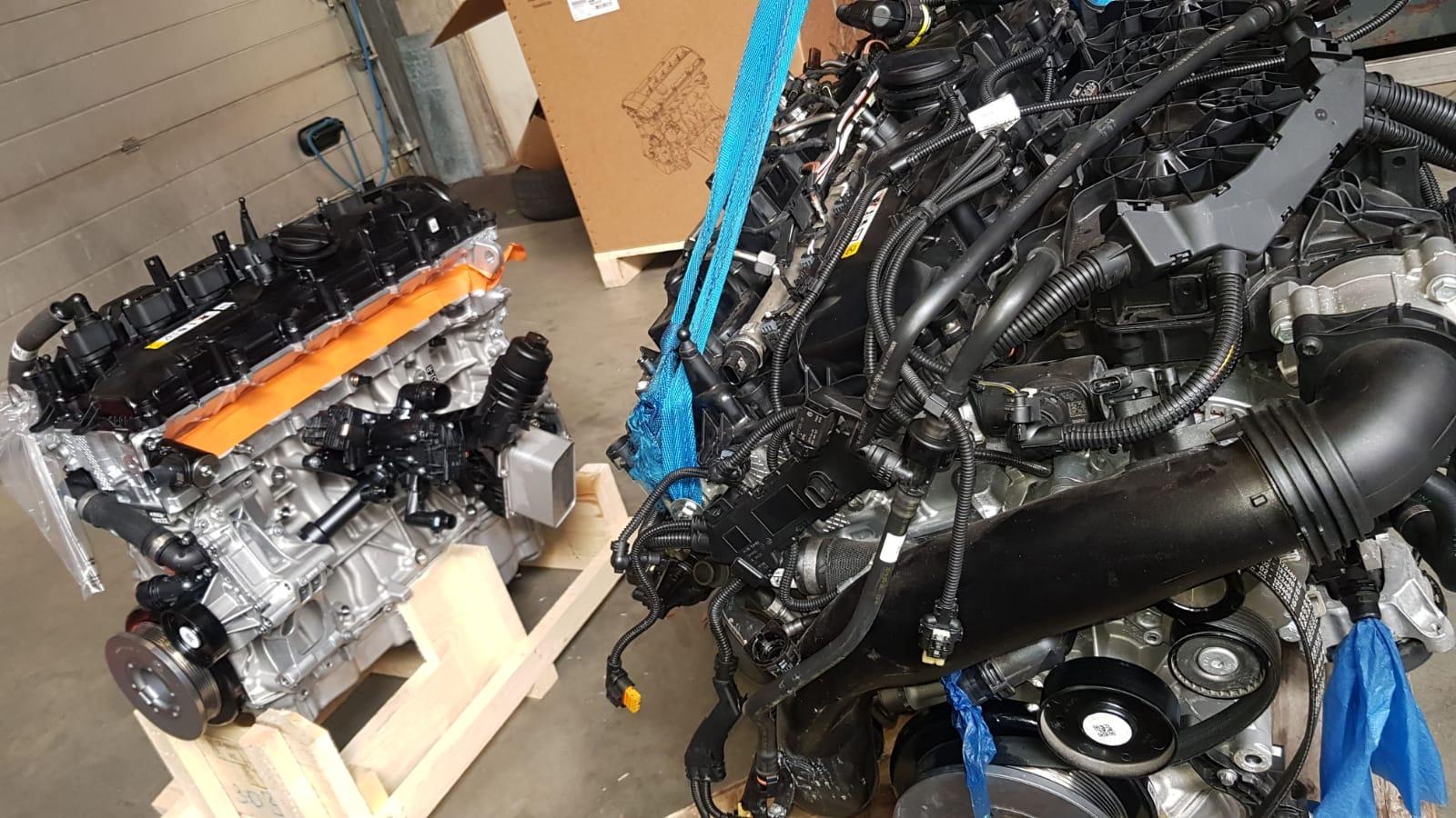

P.S.:
Without the plastic on, you see how they ship the engine. The bottom sits on tiny wood and the top has no support at all.
Then they just put in strap around the engine and off it goes to transport. No wonder this engines can fall during transport
On the right is my broken engine
