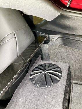

NV Specialties makes one right now that you can buy. It looks and works great.
-RJM

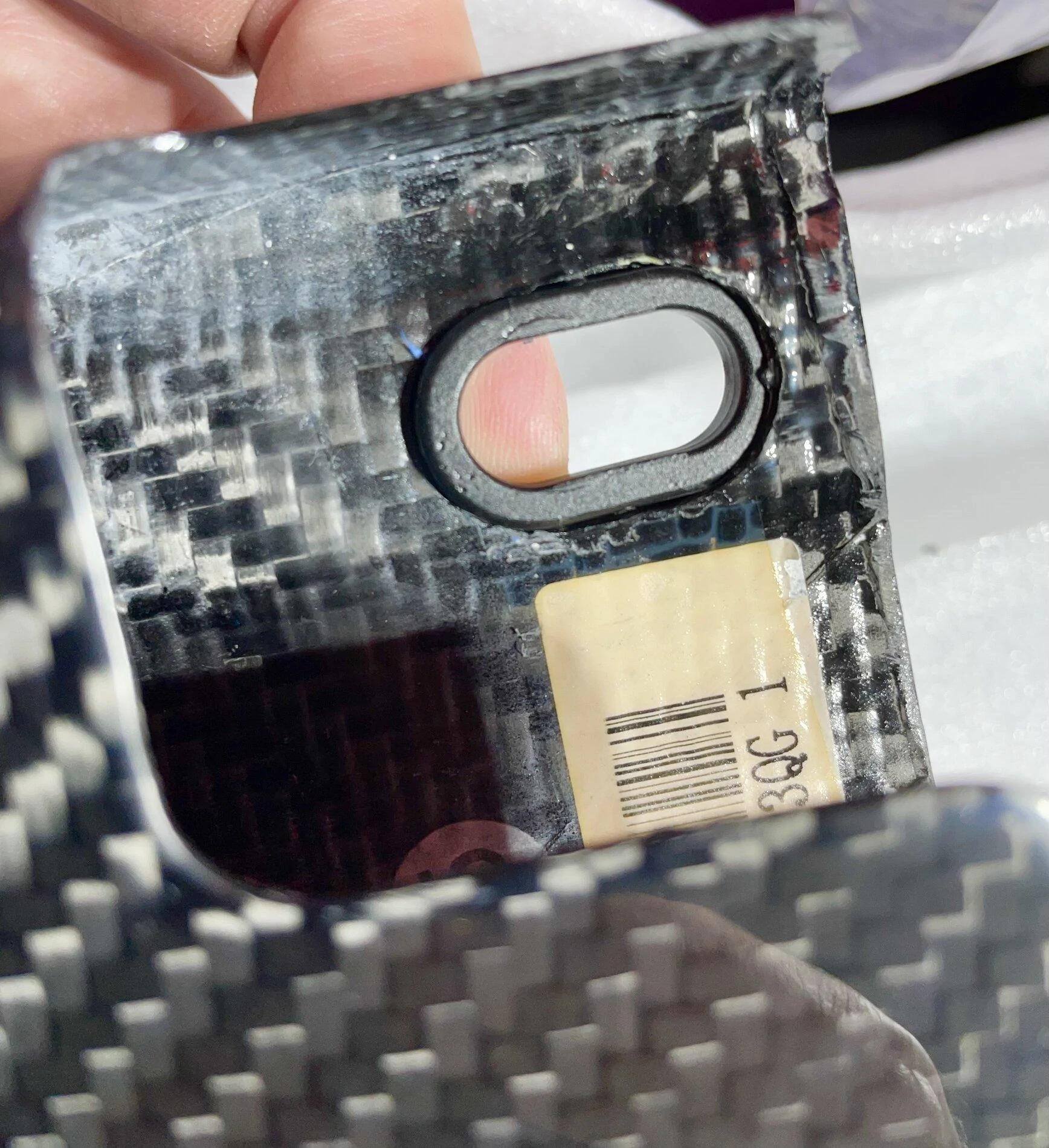

Does this flex up and down like the stock silver one or is it sturdy? Did it come with its own hardware kit or used the stuff from the stock "bar"? Old thread but I'm interested in this CF bar. Thanks
Loco38SUP
Feb 17, 2021
55
2,371
3,435
It doesn’t flex up and down. The brace actually slides back and forth as intended. There are elongated slots at the mounting points that allow the bar some give when the car flexes, see below.
You reuse the OEM hardware to mount it. The bolts aren’t super tight. They’re there just to secure it.
If you’re looking for a solid brace with no give then a metal tubing style is your best bet.
