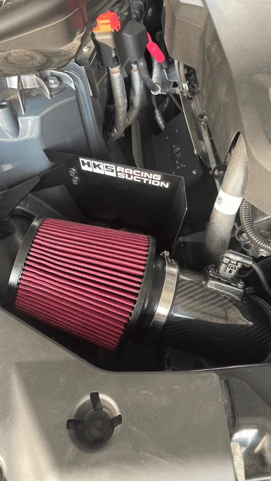

Luckily, you can replace the mushroom foam filter with what I believe is a 100mm/4" inlet cone filter, given that it's not too long and will fit in the HKS intake box. Worth looking into what would fit from K&N, AEM, Airraid, aFe, Green Filter, etc.
Someone in our local Supra group actually did just that with the MST filter from MST's Supra intake:

Sadly, any standard cone filter won't work if you have the enclosed intake from HKS. I am trying to find a suitable replacement.
Any luck finding a suitable replacement cone filter for the enclosed HKS intake?
Some possible candidates (4"/100mm inlet cone filter with the shortest height like the mushroom filter, and < 200mm/7.9" overall diameter):
K&N RC-5153 (the stubbiest and maybe closest to the HKS mushroom filter dimensions, very compact)
K&N RC-5057
Green Filter Part #2357
BMC FBSA100-110
BMC FBTW100-140
aFe 21-40505
GReddy Airinx

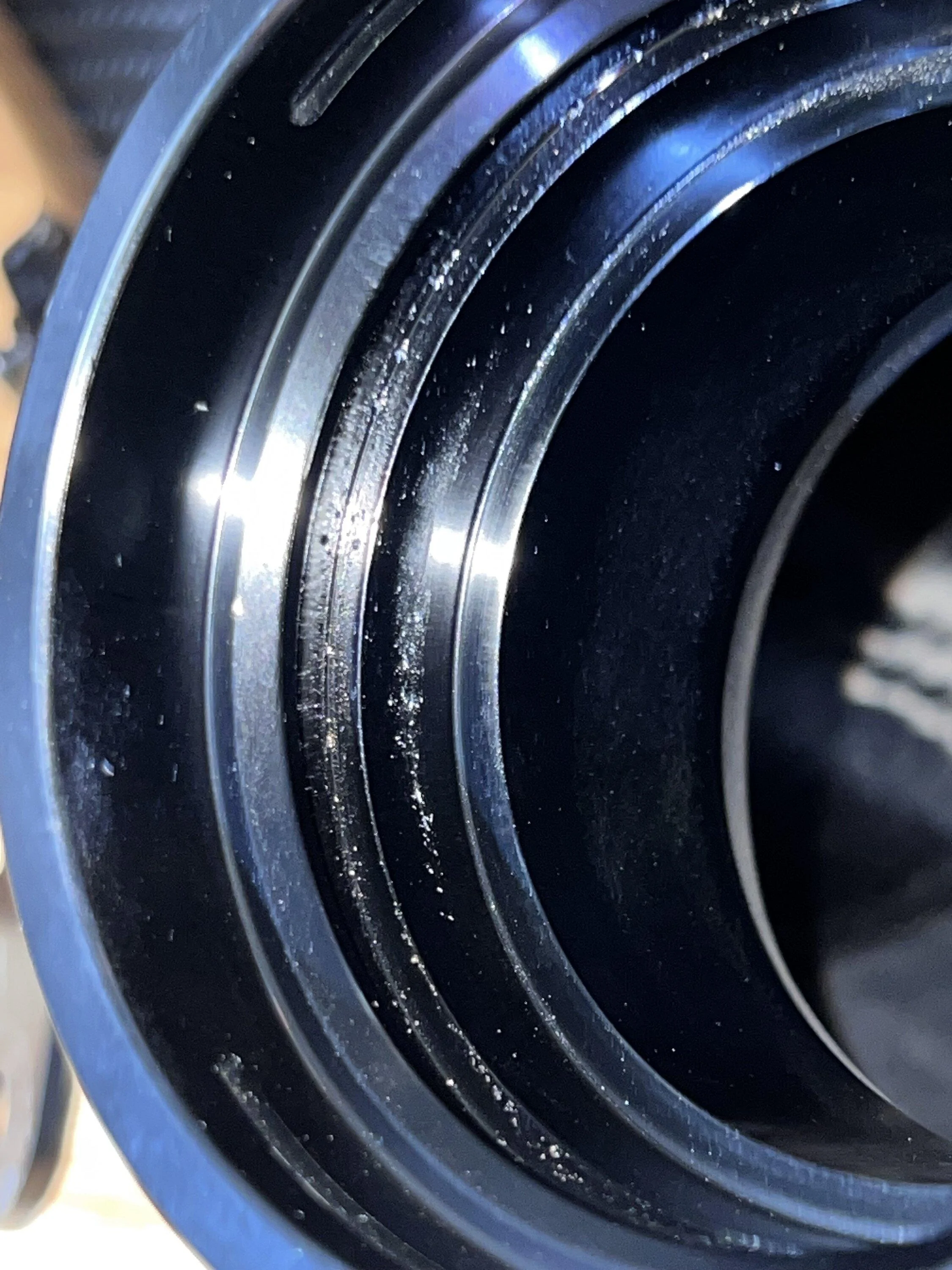

Hate to revive such an old thread, but I figured this was worth mentioning to others running the HKS Racing Suction intake as something to be aware of.
I recently re-installed my OEM intake and upon inspection of the HKS’ coupler, there was noticeable debris (dirt, sand?, particles). In the photo attached, I had already cleaned off the larger bits (0.5mm-1.0mm in size).
Though I love the craftsmanship and quality of the HKS intake, I’ve become skeptical about using these mushroom filters. These are meant to be changed at a much shorter interval of 2000-3200 miles and mine was due for a replacement. I don’t live in a particularly dusty area so I was surprised to see this after breaking 2000 miles.

Was it installed correctly?
Anyone else experience this? @NitroYellowMKV did you notice anything on yours?
I have not checked in a while but not that I ever noticed, I'll take a look when Im back in town.

What section is this? The filter to intake pipe connection? I know that seal is a pain to get on without finessing it a bit at least with the enclosed box version. If thats not seated you are asking for debris . Gonna see if the Greddy filters will fit in the box on my next filter change.
