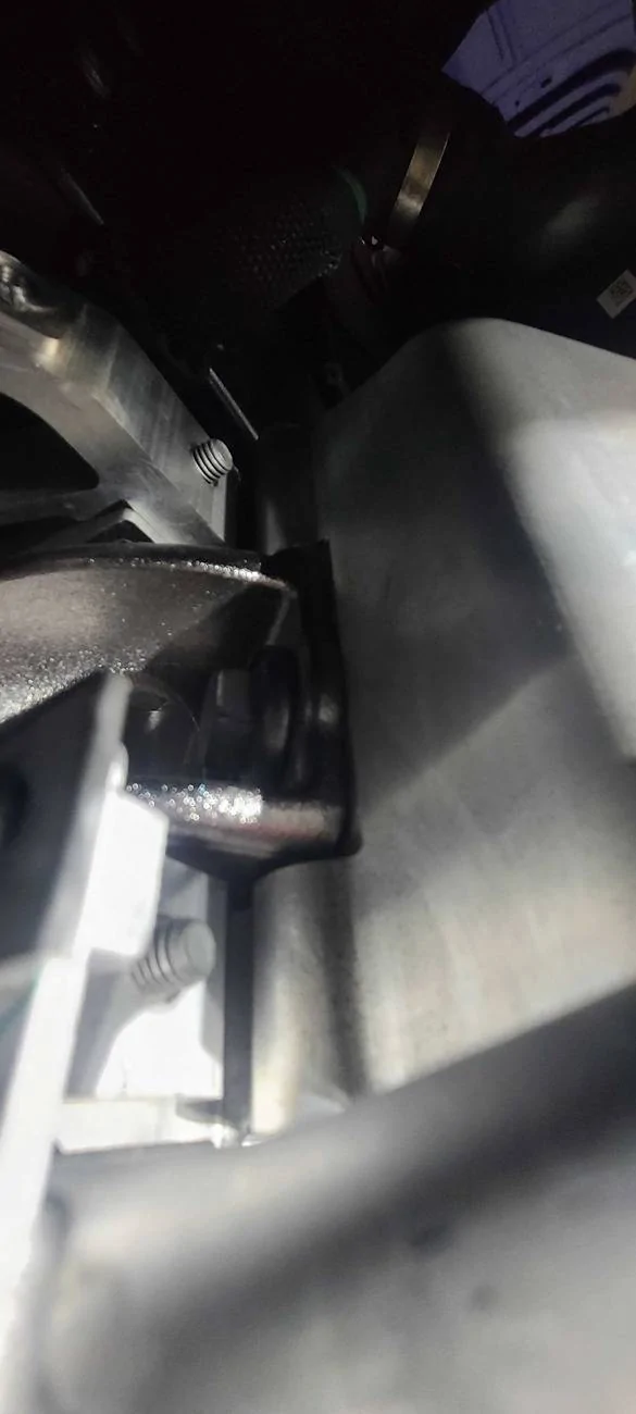

I'm trying to replace the caster arms with Verklines but can't figure out how to undo the bolt that attaches to the subframe as the clearance is pretty tight. Do I just get a wrench in there or a swivel attached to a socket?

Through the front with socket. Easier to take the bumper off but doable with it on. Watch your knuckles.
Thanks that helped a lot, managed to get it off.
For anyone trying to do this in the future a deep socket, small extension and swivel worked enough for me to barely get a torque wrench in there without taking off the front bumper.

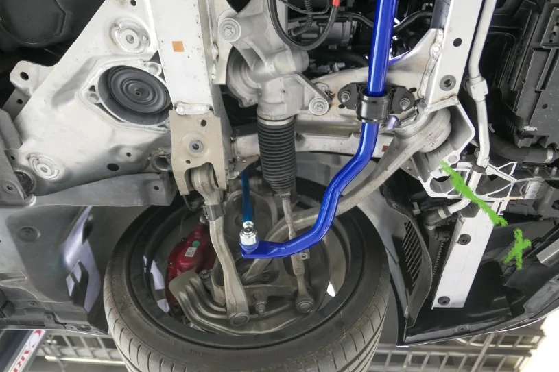

Removing the arm is really straight forward, just need to remove the under panels to gain access.

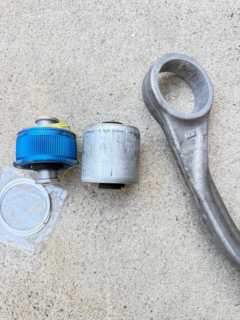

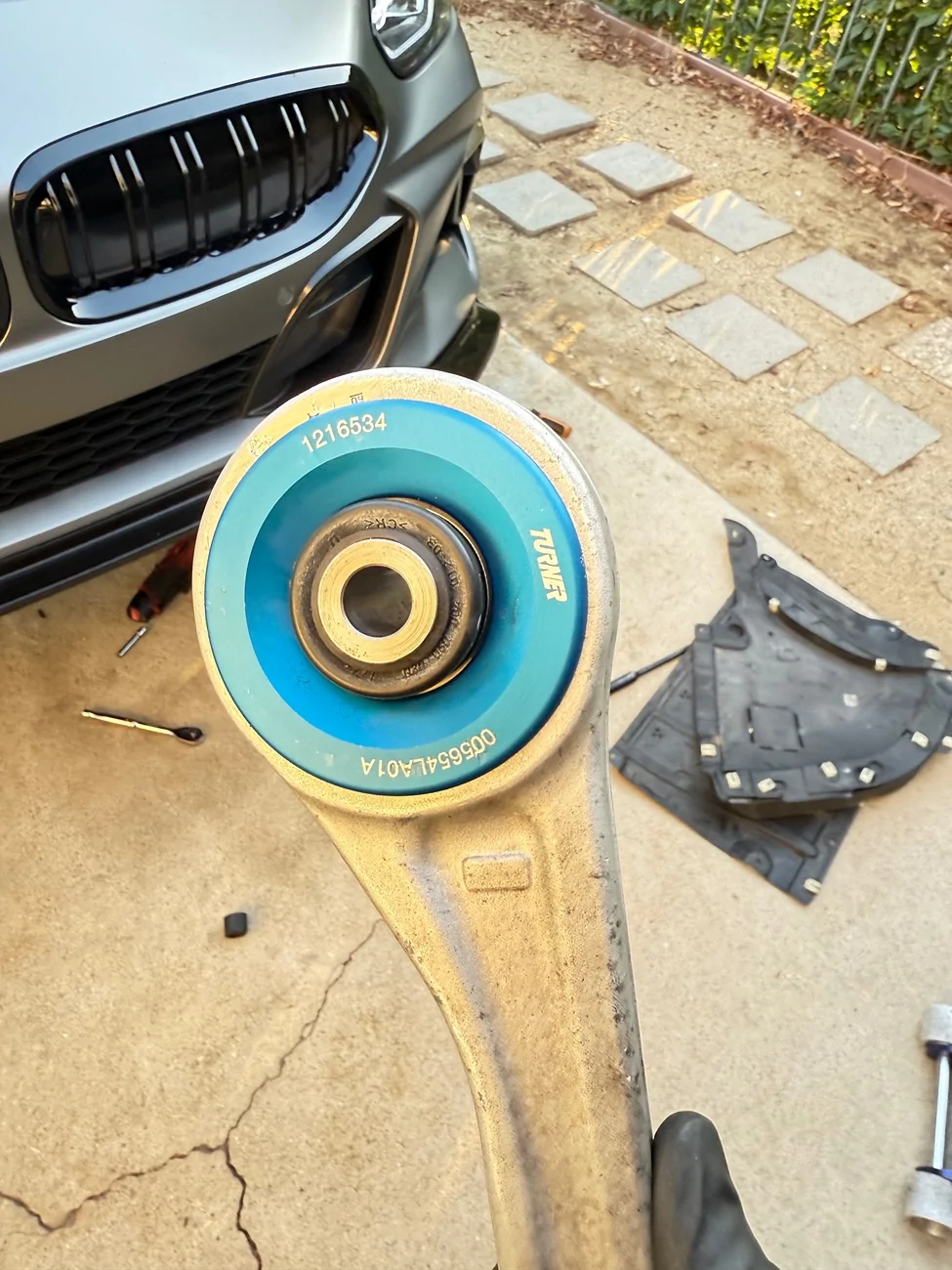

All the arms are tapered fit so they all should drop out without hitting/pressing after unbolting the 21mm nut at the ball joint. The 13mm is a little hard to access- you’ll need a few extensions and a swivel. I’d recommend purchasing the bushing pre installed if you don’t have a press since the bushing is HUGE.
access at the green X

That's not a photo of your actual Z4 right? It has the EU aluminum aux radiator mounts.

Nope, good eye. Just a quick google search for a photo to illustrate the access point.

I have access to a press, but I don't think there's many if any sleeves with it, will have to check on that. Thanks for showing the part numbers if I go that route.
