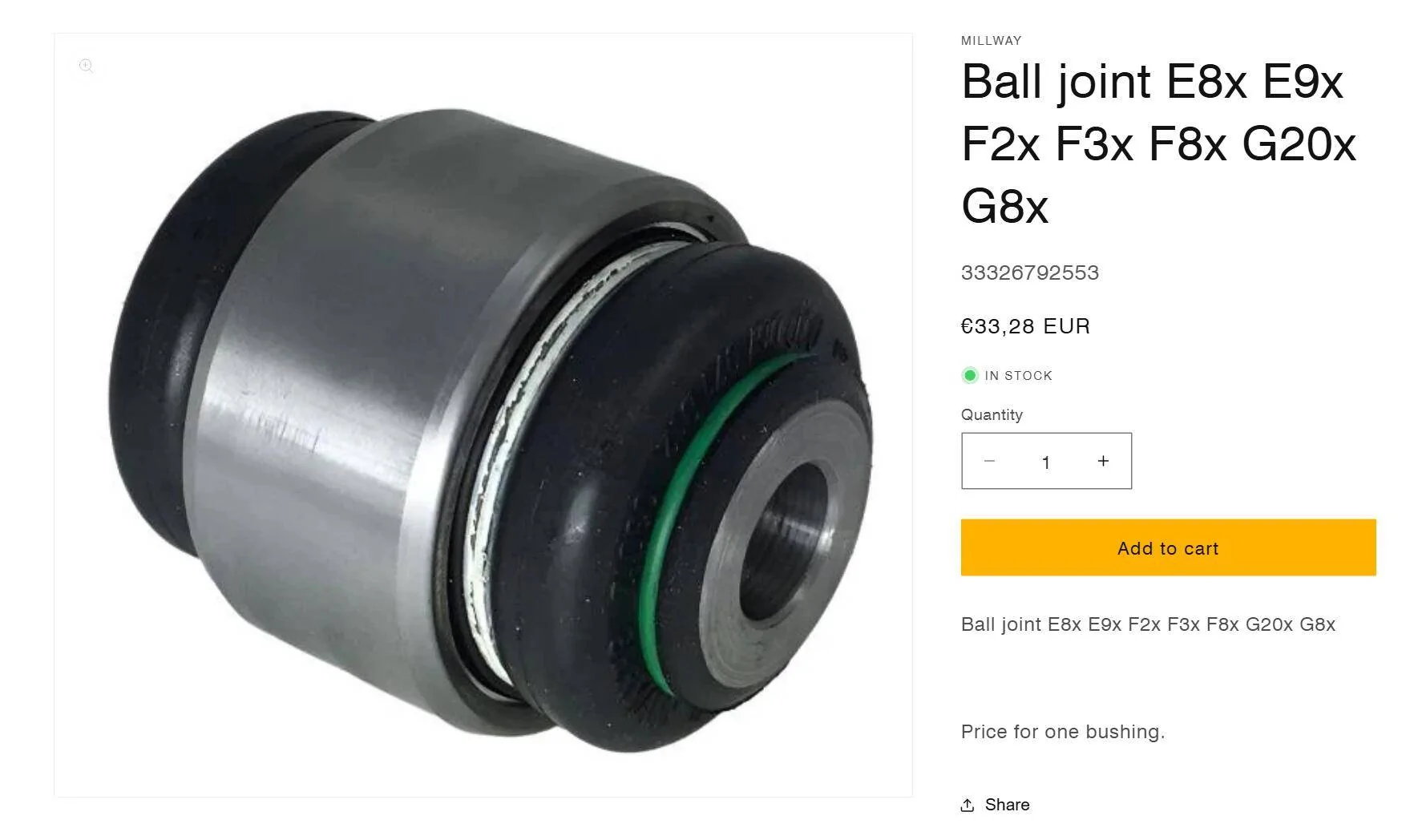

I'm also planning to get the rear toe arms. To me the allen key pinch mechanism on the SPL doesn't convince me that they will last. The screws are so tiny and can't tolerate high torque before the allen receiver get messed up. Even with locktite, I have heared multiple folks saying they get loose inevitably over time for track use, and need to re-torque frequently. The Verkline uses the old and robust centric nut mechanism which is much more robust. However both arms have the exposed monoball bearing, which doesn't have a seal to protect it from water and moisture. Might get rusty and fail over time, or need to check and apply some grease maybe every quarter? Does anyone have experience with this?
I wish there can be a sealed monoball bushing on the market that can be pressed into OEM toe link, so we can have a hard connection that does not compress, just like the Millway monoball front lower control arm and thrust arm bushings. Less than $200 solution and will last a lifetime. Venders and designers please make this happen!
Something like this with the correct size:
Correction: I double checked Verkline product page, and their toe arm's monoball bushing indeed have a seal boot.
  • Delivered with uniballs rubber boots for dust and water protection, which provides even better longevity
