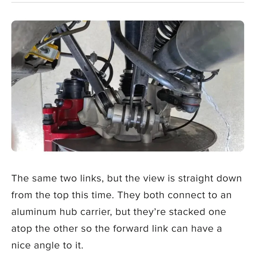

Unless you know what you're doing, you shouldn't adjust traction arms from the factory length. the rear suspension is a multi link where the top and bottom pairs form a pseudo-wishlink. if the top and bottom arent adjusted together, it will cause the knuckle to tilt and move in a weird arc. or, cause the bushings to bind up as the hub moves up or down.
