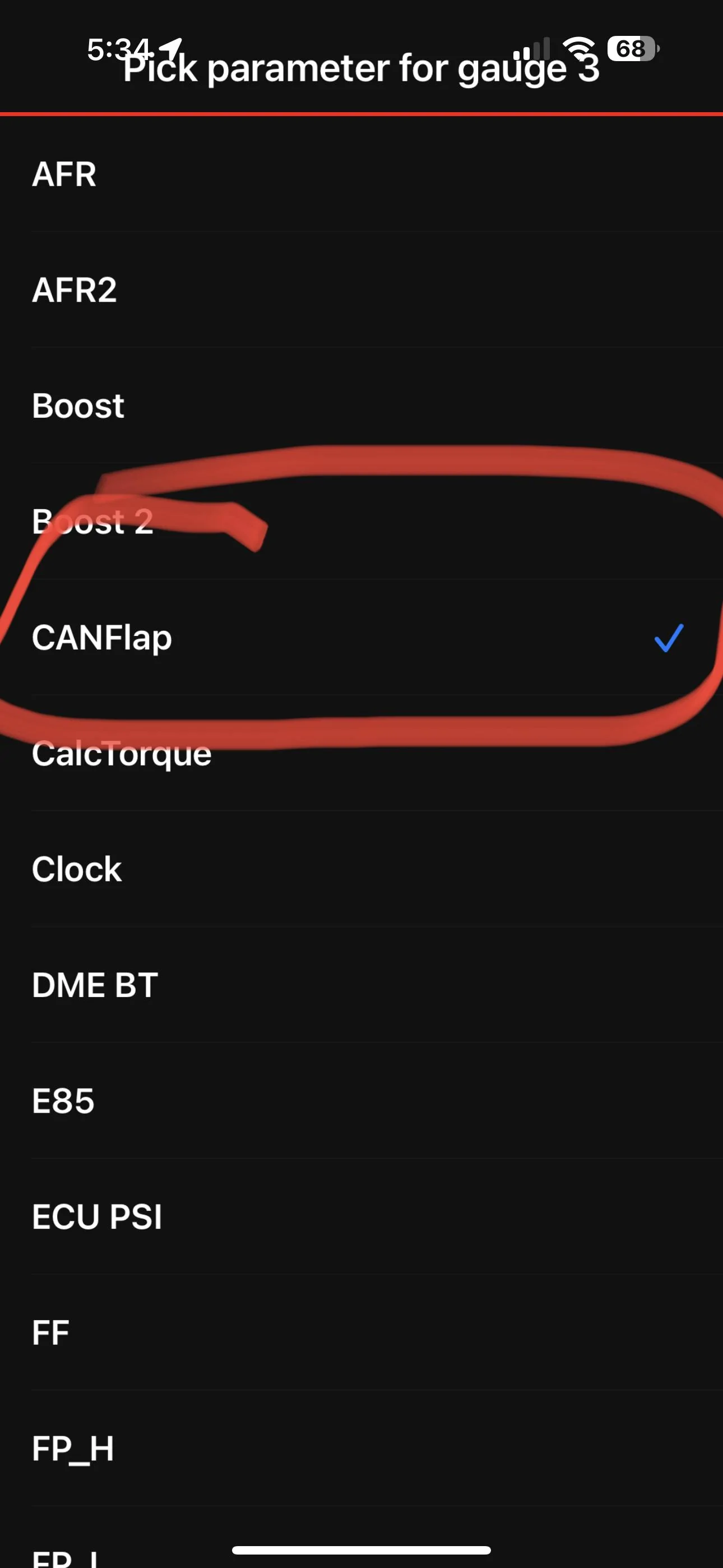

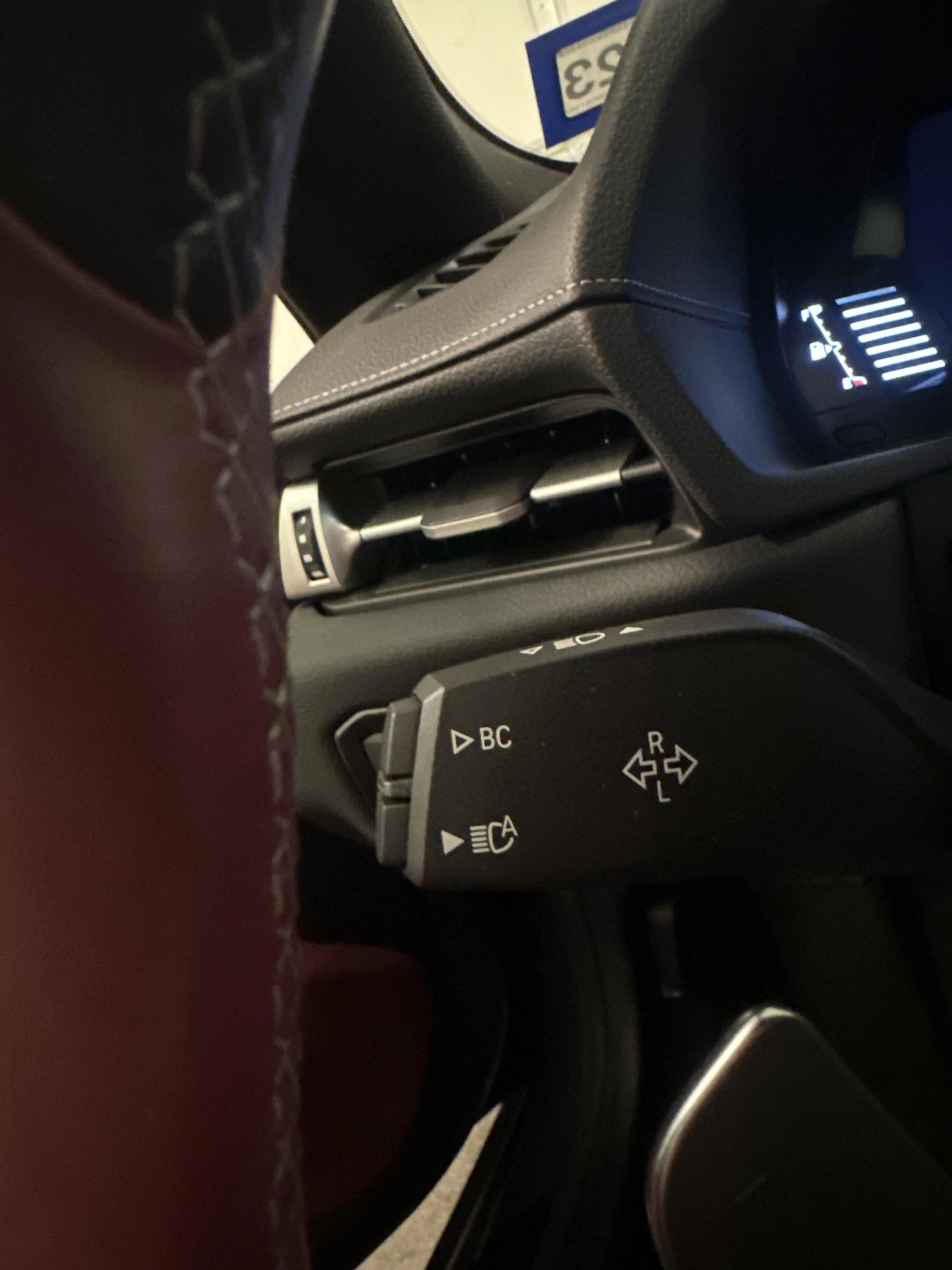

Itā€™s probably the exhaust flap. It greatly reduces burble when closed. I hardly hear mine when closed.
JB4 can control it in 3 ways
1. Always closed
2. Always open
3. Open only in Sport
You can adjust the setting in two ways
First Way:
On your turn signal stock - press and hold the ā€œBCā€ button until the turn signal flashes. A left turn signal = always closed. A right turn signal = always open. Both Turn signals = open only during sport mode (make sure youā€™re not in sport mode or itā€™ll get confused it seems). Repeat the process until you are on the desired setting. (Picture 1).

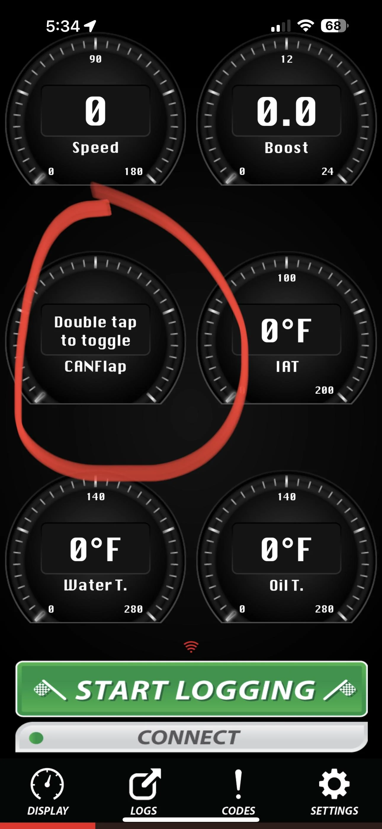

Second Way (pic 2/3):
Go into JB4 App while connected to the car
Press and hold down on a gauge you donā€™t use.
A list of other gauges will appear. Select ā€œCANFlapā€
Pressing the this gauge while connected to the car will have the same effect as the BC button, similarly with Left, Right, and Both Flashes.
Hope this helps.
