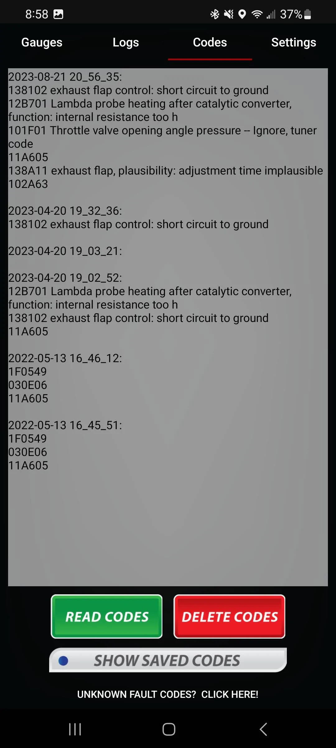

You guys getting any flap codes? Mine acts up sometimes and throws these.... Started after my first track day.

*JB4 has no affect on burbles except for exhaust flap*
It has no control over timing or fueling. If you're not getting burbles it's literally only exhaust flap, or you're not in sport mode but that should be pretty obvious.
