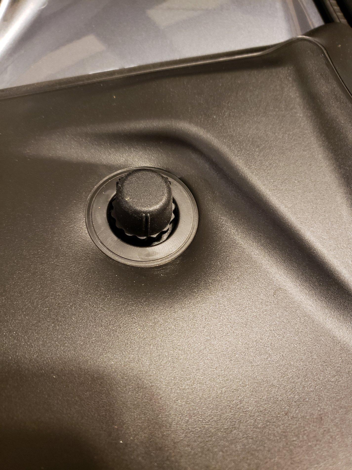

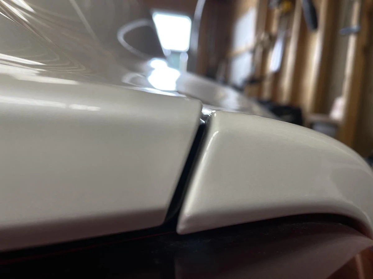

I had to turn my adjuster knobs quite a bit to reach a point that worked. So much, that the panel gaps were off significantly on both sides. And, the release was very, very tight with a huge "pop". In fact, on one occasion during adjustment, the latch didn't fully release the lid at all. I had to hit the button again to get it to pop, it was that tight.
This is a fine idea if it works for your particular car without these issues. On mine, both these concerns render this solution less than ideal. I'll live with slowly closing the door plus the occasional key-fob opening of the hatch when needed.
Wow.. yeah that looks way over adjusted!
As I mentioned I found that mine were pretty much bottomed out and I don't think mine were adjusted from the factory....I didn't really need to adjust too much for this to work well!

This worked great for me and fixed the problem....Mine were pretty much bottomed out and I don't think they were adjusted from the factory....I didn't really need to adjust too much for this to work well!
kudos to @Spiguyver for posting this video :thumbsup:

Did the knobs today. Works like a champ. Just gotta get them up high enough to make the difference. Just like the video shows, the ”clunk” when you hit the open button is also much more distinct.
