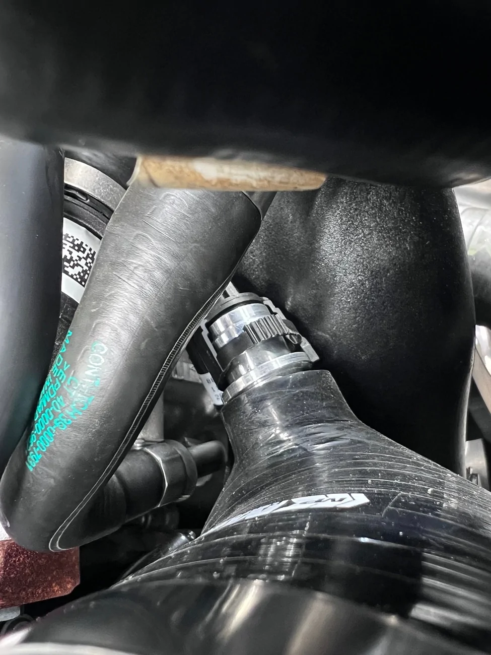

I have the MST V2 Intake. What do you think is leaking? The intake or the downpipe? Gonna go to a shop tomorrow

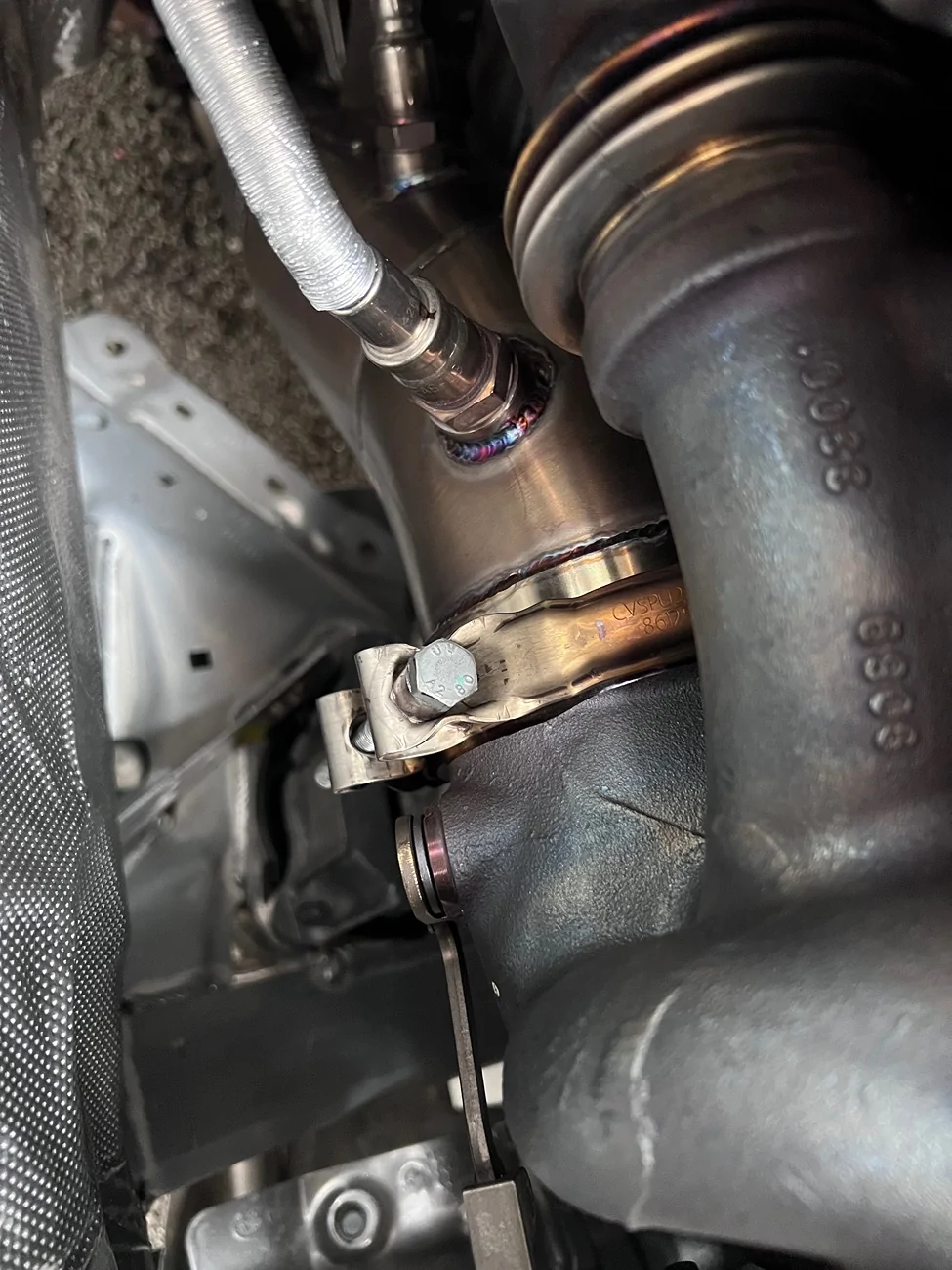

Question. How tight should this v band on the downpipe be? I read online 18 pounds. So that’s what I did it to. Should I tighten it more?
8,618
16,901
You need to rotate the clamp part to below the wastegate arm pivot point. How you currently have it will block the full articulation of the wastegate arm.
Technically flipping the clamp around will make the above easier but you could probably get it done how you have it.

thank you I had no idea. I rotated clamp downward and out of the way. Hand tightened it nice and snug.
