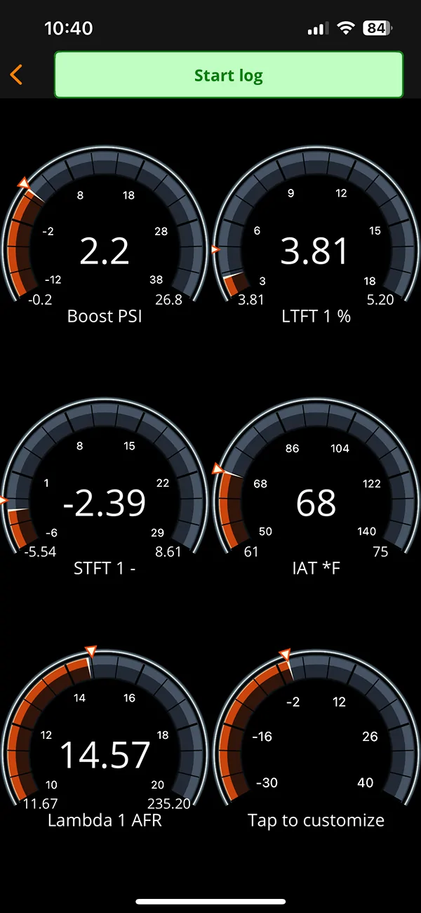

Beginning of my drive this was my Ltft and stft but then later on the ltft went up a bit. I think 15 at idle
