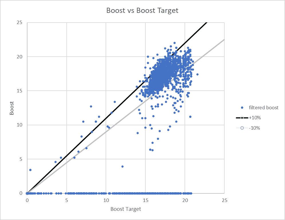

Just a question with in the thread of questions, does down pipe without a tune lead to a possibility for boost creep? Or can the stock ecu tuning account for that extra increase in exhaust flow?
i have AWE touring and a modified catless downpipe that hooks up to the AWE 3.5 inch connection instead of the factory 3.15
definitely a pretty drastic increase in flow and i've been running this without a tune for the last 45-50,000 km's with no real issues other than occasionally if i do a WOT pull into 6th gear in cold weather it will throw a drivetrain error for overboost but it self clears with a key cycle. probably due to the huge flow increase and the dense air ( i'm talking 10C/50F and below) Air.
