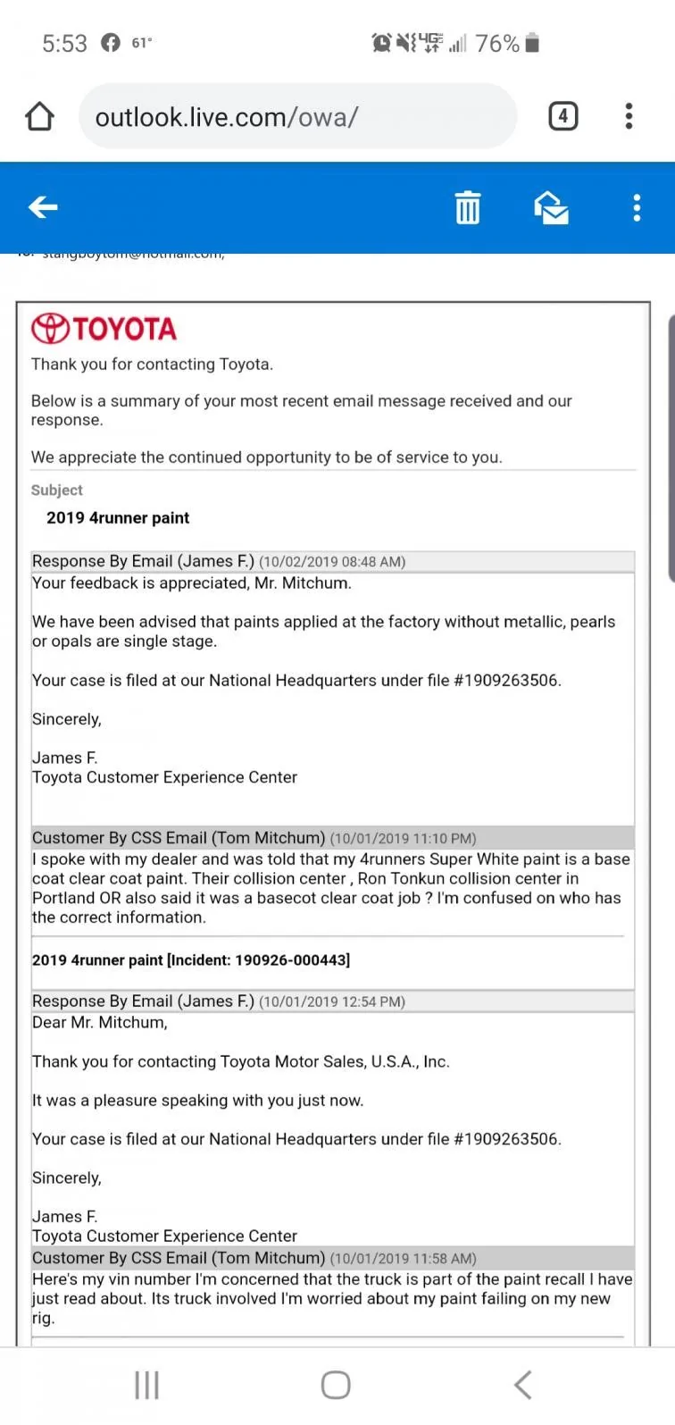

I work in the paint shop at a toyota factory, 040 super white is single stage, (no clear), on all Toyotas. Whether the black is single stage or base/clear depends on which plant the vehicle is produced at. I work at the Georgetown Ky plant (Camry, Avalon, Venza) and we use base/clear while some of the other plants do not. Why? Beats me. I've been askin that question since I've benn there, 17 years. As for the 040, It's just cheaper that way.
2016:
I called Toyota and confirmed directly from Toyota that superwhite on my 2015 4runner does not have a clear coat. It is a single stage paint with "the clear mixed in" as I was told from Toyota.
2017:
None of the other colors are single stage for the 4runner. I paint at a Toyota bodyshop.
Super white can be blended with base/clear and it should look perfectly fine if the painter is decent.
2018:
Super White still is only Single Stage paint. I have/had a letter from Toyota Corporate to prove it. this has been gone over on this forum many times. it has a mid clear mixed into the paint, but it isn't the same as spraying base coat then spraying a clear coat over it.

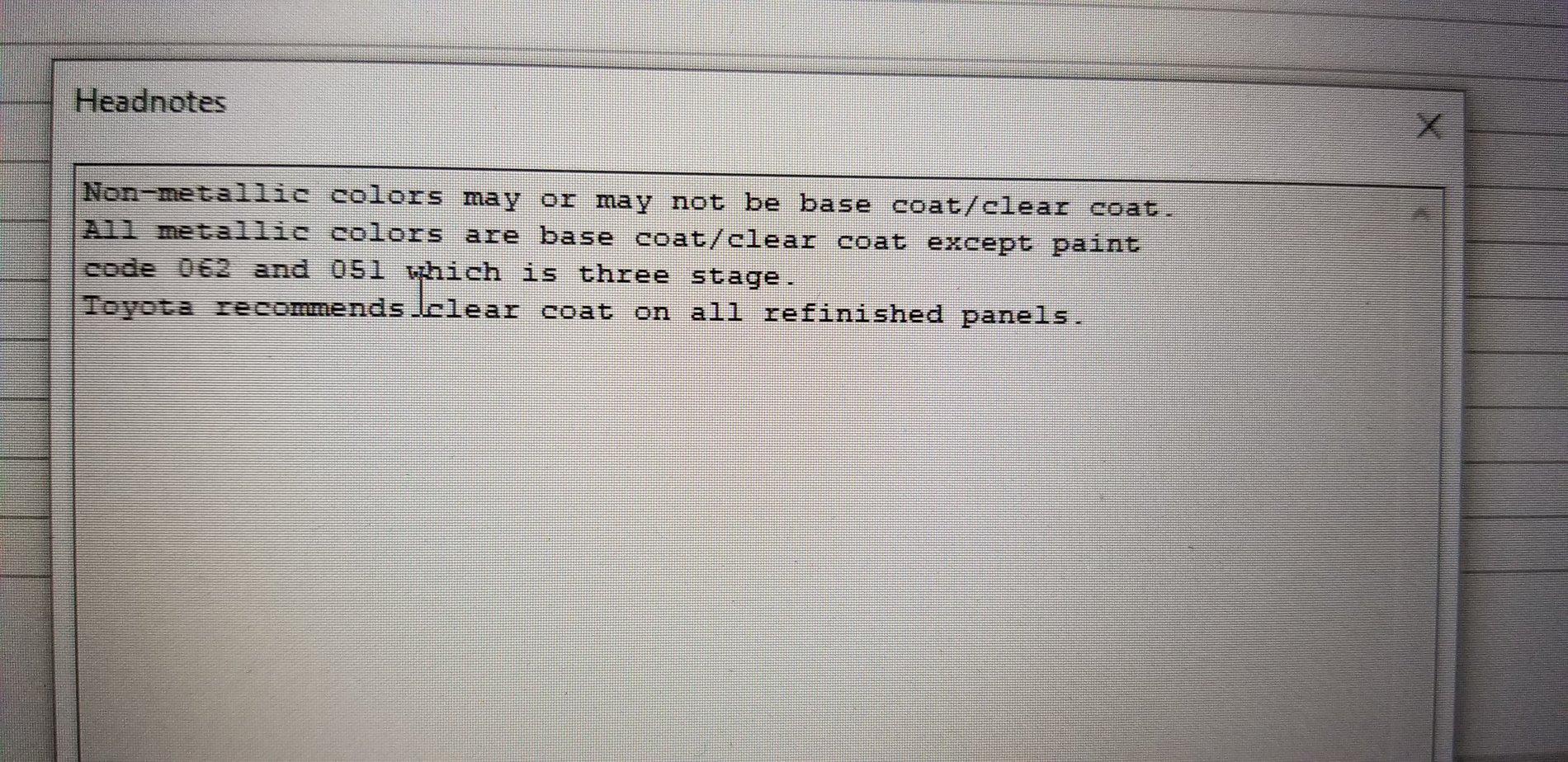

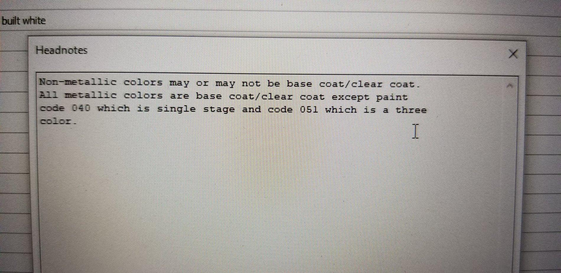

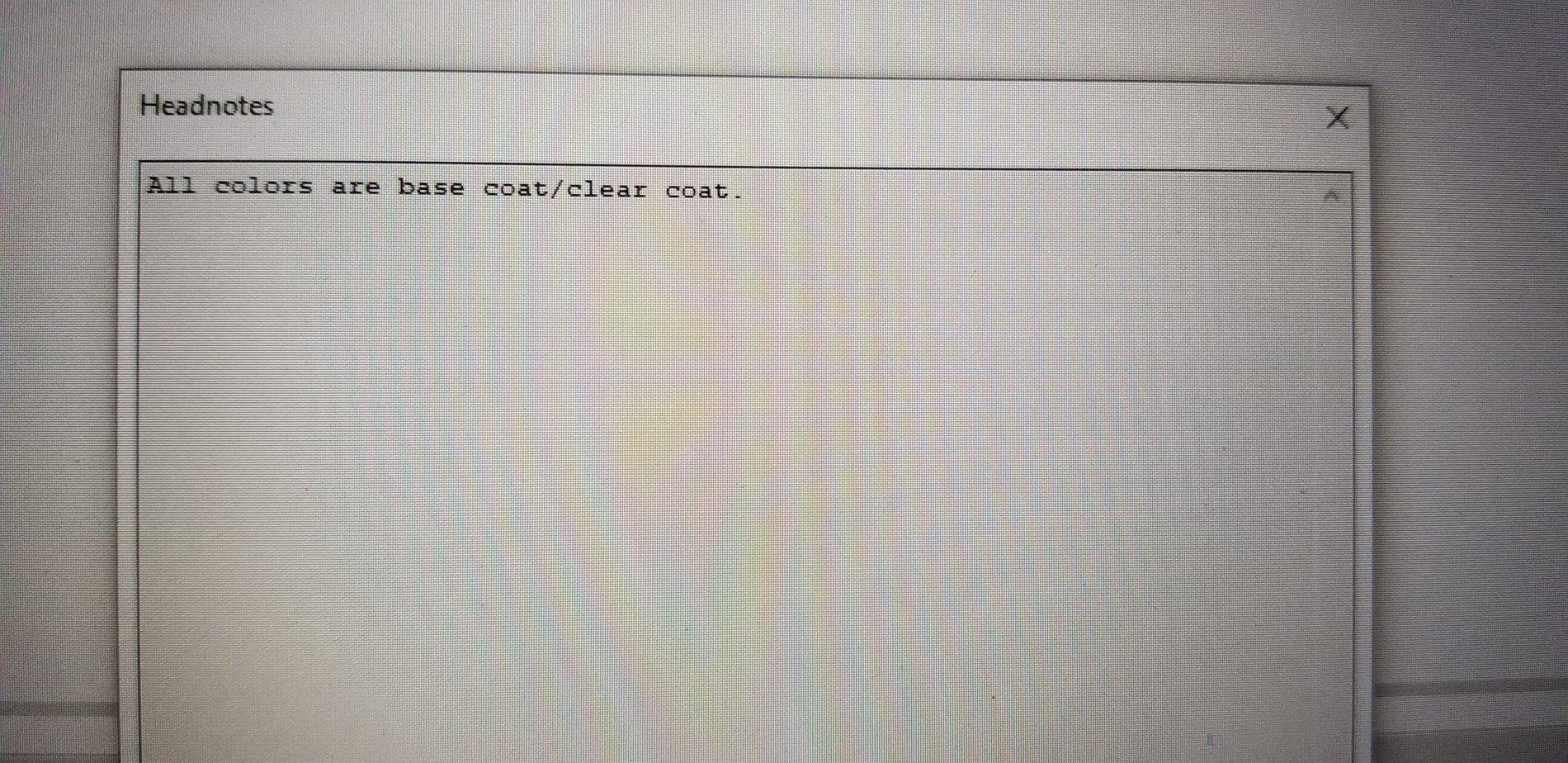

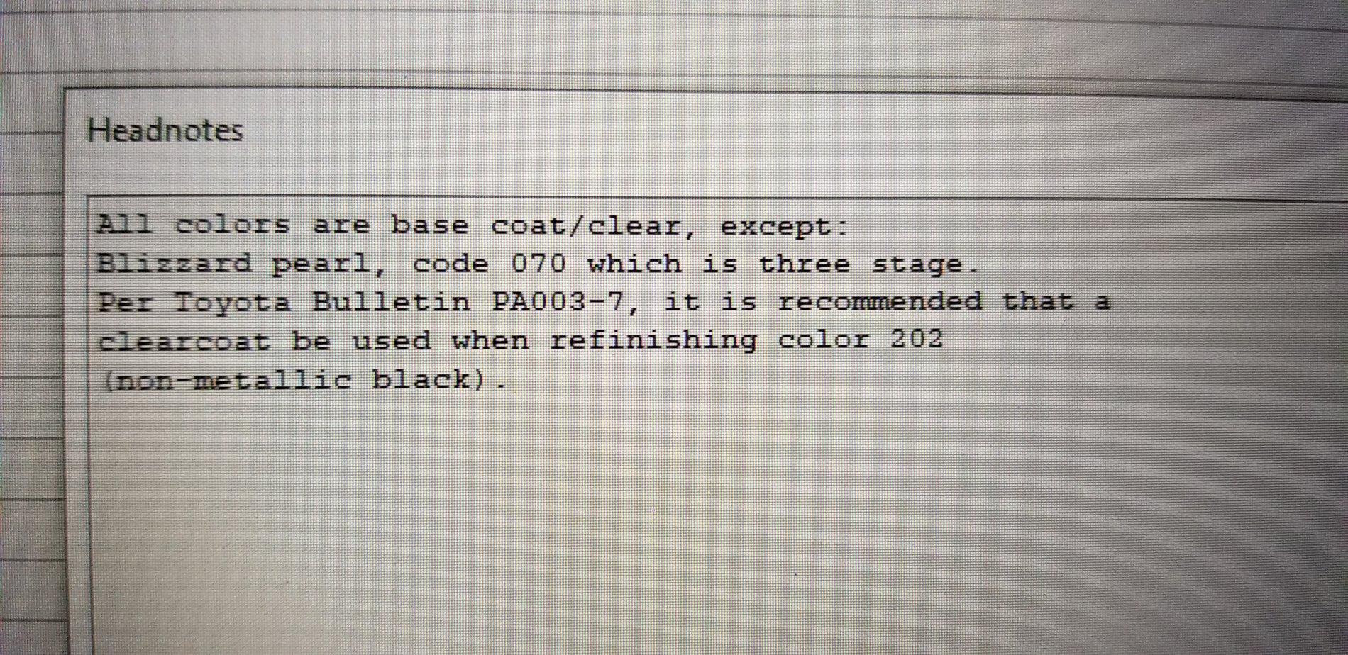

We get refinishing guidelines from the manufacturers and it seems Toyota's transition to base coat/ clear coat was around the mid 2000's. You can see how it changed throughout the 2000's. I am surprised how some of their cars were still single stage as you pointed out.
Here's a note from 2010:
2007:
2006:
2001:
