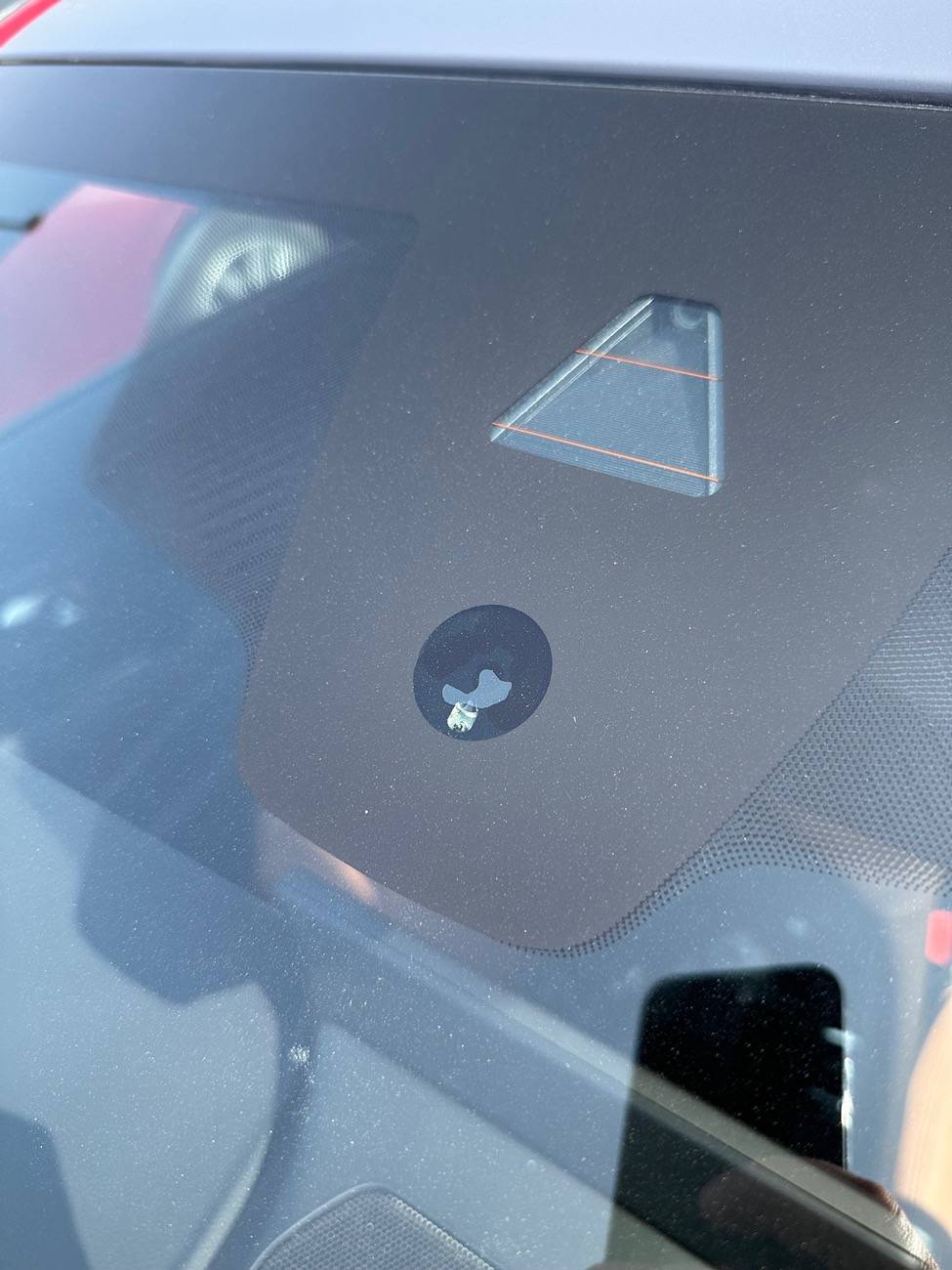

I had my windshield replaced 3 months ago with a Pilkington aftermarket. I did not noticed any difference in clarity.
FYI it is normal for them to drive a few miles to calibrate the front sensors. I'm surprised they did not let you know up front.

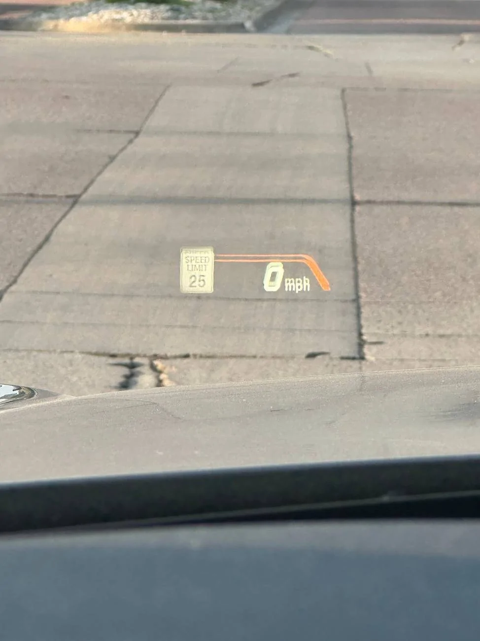

Polarized sunglasses make it damn near invisible.
Night time driving with it results in the whole square/rectangular screen being visible as a reflection.
I do enable it on track just so that the speed can be seen on camera.
Definitely took some time for me to get used to as nothing I've had before this had it. I really do like it now and use it all the time.
I do agree with the sunglasses bit if they're polarized it is much more difficult to see the HUD on the windshield though. Also noticed the annoying glare I get on the windshield from the square cutout of the HUD screen as well. Been thinking about trying to get something I can stick over the edges that are more of a matte finish or something to stop the glare from pinging off the glass in front of me. Will let you know when I find something I like

I just set my #1 button to enable/disable HUD. quick and simple. I dont really need MPH shown in my face at night...because I'm just cruisin' for boba.

Thank you. It looks like the dealer made an expensive mistake.
I think you’re right. I’d have them come and get that bubble out. Iā€˜m on my 4th windshield. Didn’t matter the brand. I’ve had both. Homestead (track) is particularly rough on them.
The solution for me, I finally convinced a fantastic PPF shop in my area to put a permanent protection film on it. No problems since. But I doubt it’s something you’d want to do if you don’t track. The film company recommends you don’t use your windshield wipers and use only water or a special cleaner once it’s been applied. Windshields for this car aren’t cheap. So, for me, I’m happier than a pig in ?

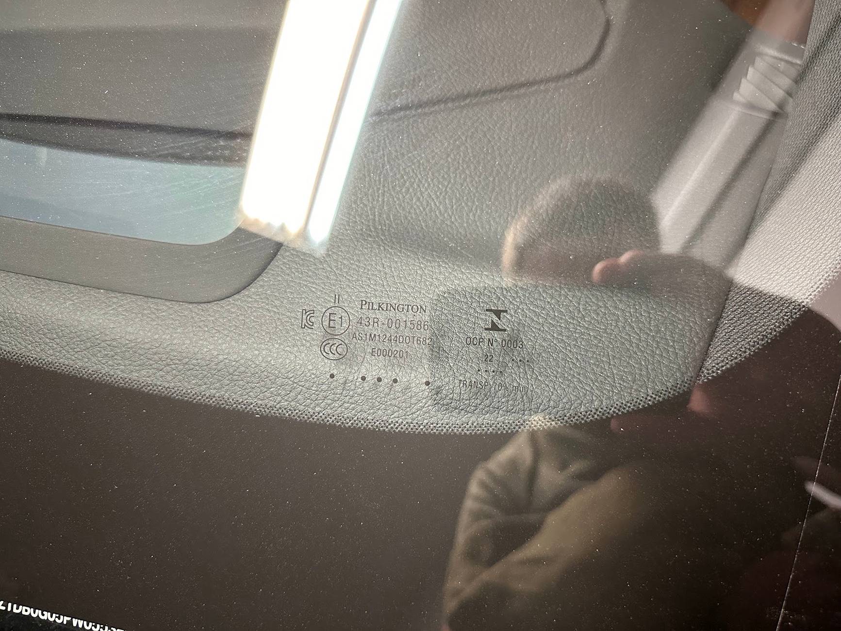

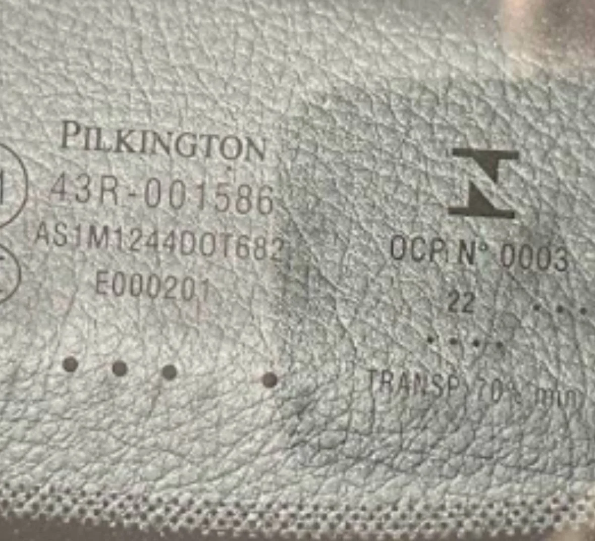

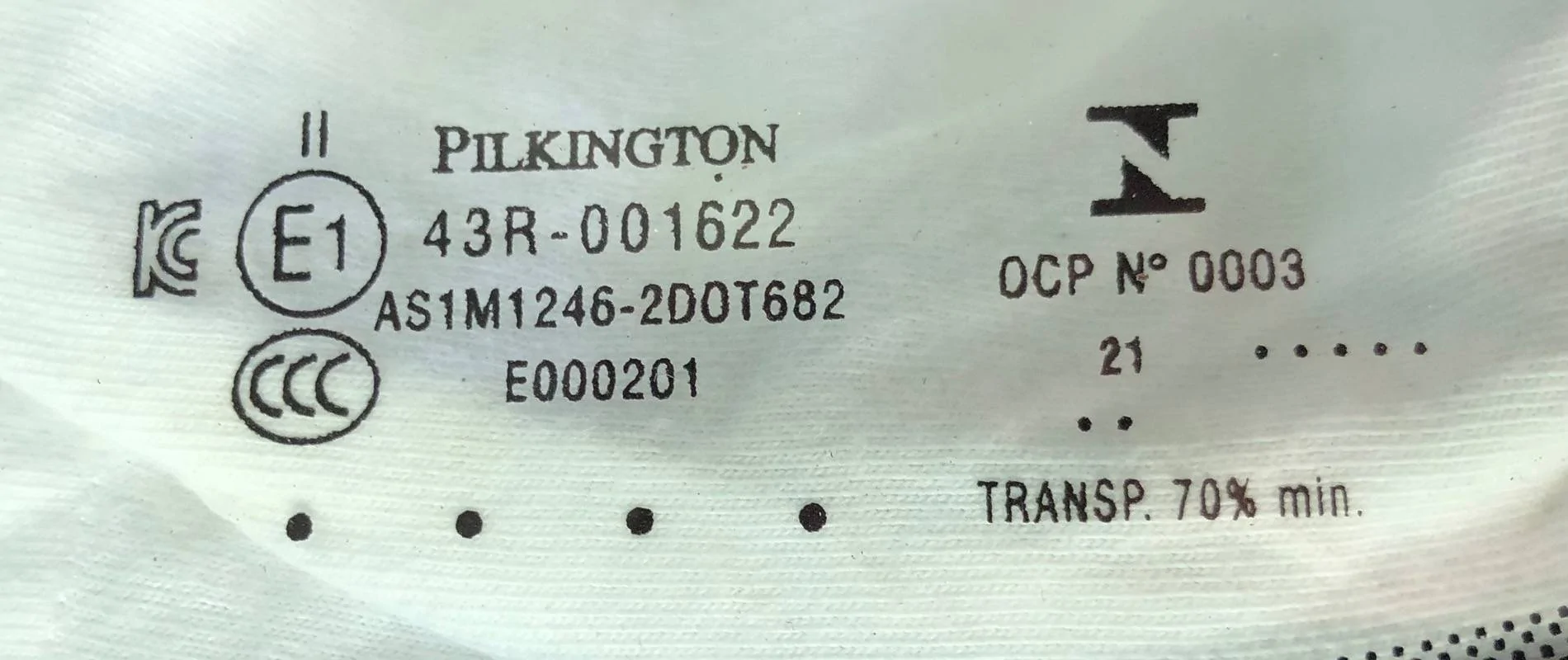

I was looking around and saw your thread. Lucky for you, I am an auto glass technician, and I own a supra. Like what the others said, there are two windshields for the supra, and one of them doesn't have HUD. Some companies use the one without HUD since it's half the price, and the HUD would be blurry or not as good.
There are some tags on the windshield, specifically starting with FW052 or FW052.
I can confirm if the windshield comes with HUD or not if you can get that.
Also, for people asking, there are windshield protection films (which last a couple of years only; the technology is not good yet). If you are replacing your windshield, I would request the Pilkington brand or PGW, as those are the best on the market.
