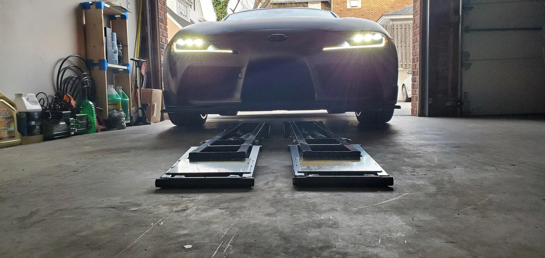

BL-5000 SLX. it fits just right.
That’s what I was thinking. Thanks for confirming. Collapsible height I believe is 3 inches on that one. Are you lowered at all? Wondering what the total clearance on the sides is after being lowered?
I'm not lowered at all. so I cannot comment on lowered car. as it is on my car when I try to put the jack on jack points, it has about 1.5 inches to move around. if you are lower than that, perhaps you can fabricate 2x8 or 10 to roll on so you get clearance.
Yeah good idea. Just ordered the BL-5000SLX and wall hangers. Had $100 off promotion thing. Looking forward to its arrival.

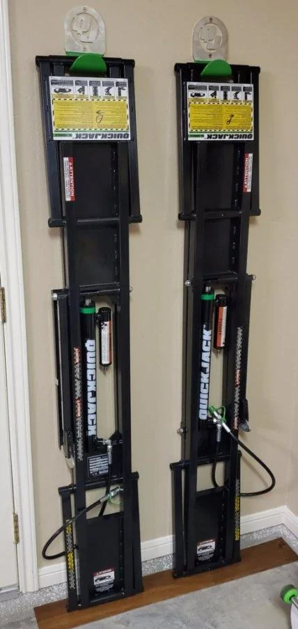

On the wall hangers... Let the weight of the Quick Jacks rest on the floor and have the wall hangers just keep 'em up against the wall. You can surely use 'em to hang the jacks but they are heavy and I wasn't going to take a chance. :thumbsup:
I will do just as you did! Thanks!!

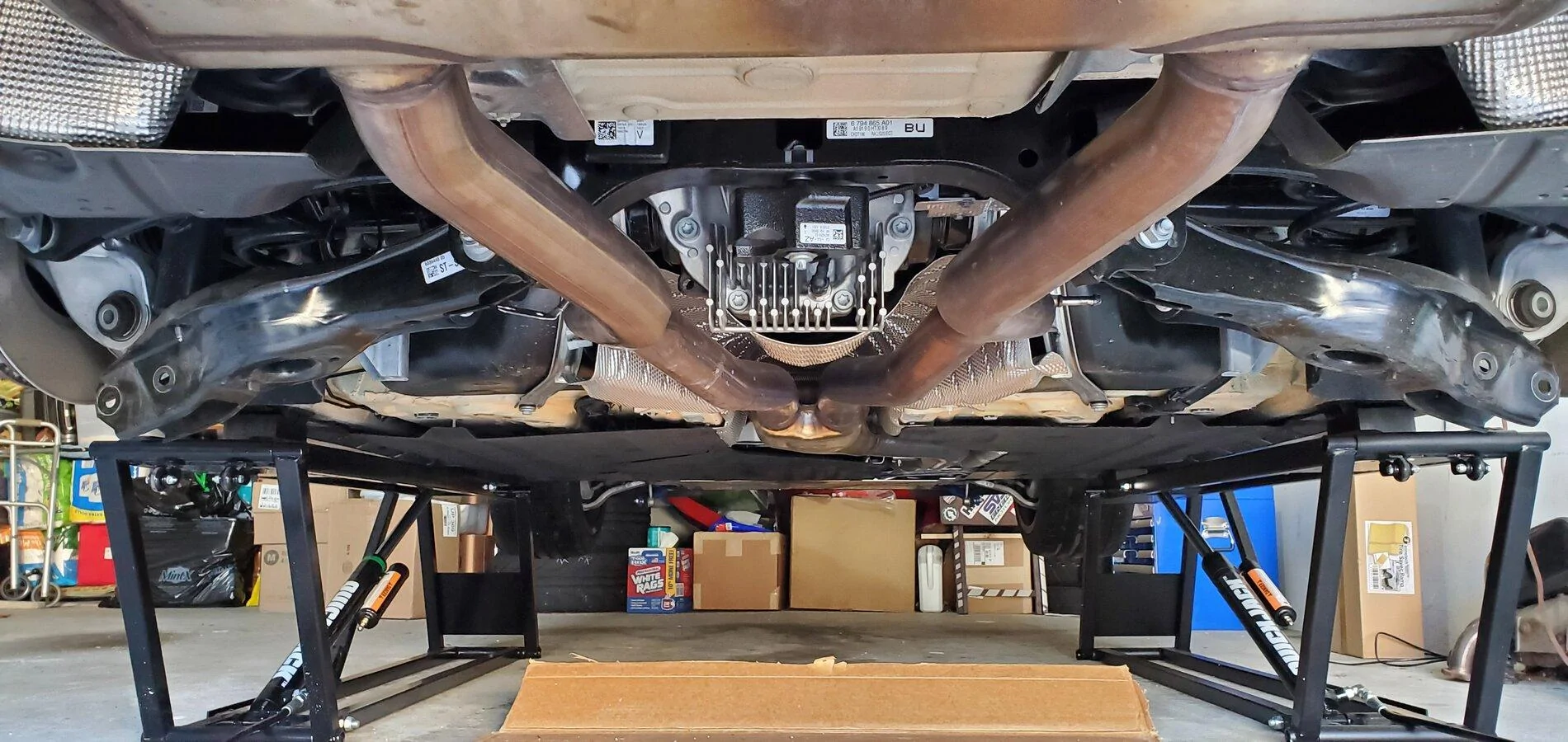

Meant to ask.... is the BL-5000SLX wide enough to allow you to actually place the lifting blocks on the lifting points of the Supra? Just watched an assembly video of a guy who has Subaru FRS and his lifting points were wider then the QuickJack could go. Not sure what model QuickJack her got though. Thanks!

If you have some budget, I recommend quickjack.
I had concern on storing it but it fits under stock height supra.
