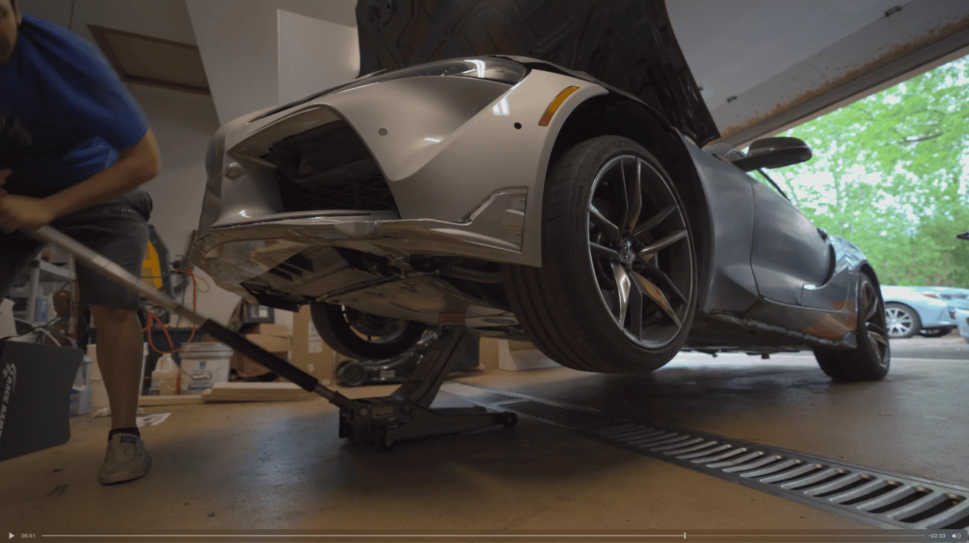

I’m at stock suspension with a Pitssburg Low profile jack and there’s no way it’ll reach. The edge of the jack is still only at the black plastic guard and about a foot away from the indented area with the bolt.
That's the same jack I have! I just keep sliding it back until I get to the jacking point. You will only be able to move the handle up and down a few inches, but as the car goes up, you'll get more space to jack the handle.
Here's a screenshot from a video of mine:
You can see there isn't much room to move the handle, but as you raise the car, you'll get more space.

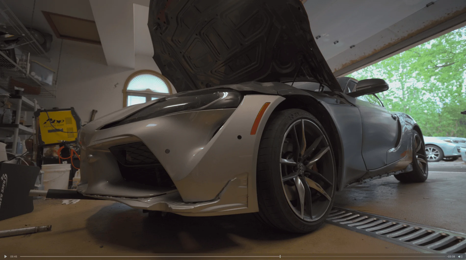

Ahhh so you’re pretty much bottoming out the handle just to get it under. What a wonderful design. Thanks for the info!
Yeah it's a little annoying but not too much of a struggle, makes getting the car up in the air very easy, esp because you don't have to deal with using the jackpads on the sides.
