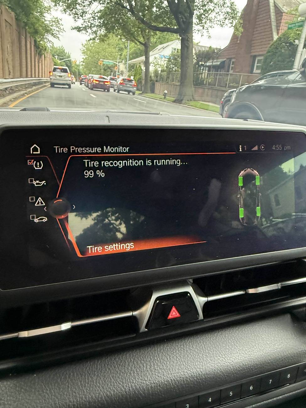

Just got a set of TE37SL Black Edition III's on my 2020 supra, even on stock suspension I love how it looks. Drove it around for a while and no problems at all with TPMS or tire detection, and the car had readings of temp and pressure on all 4 corners, but on the way home the TPMS gave me a warning that it needed reprogramming, and to drive it around so it could learn. I proceeded with this and it got stuck at 99%. I tried putting the tire detection on and that got stuck at 99% too, even after about 8 miles or so. There's no warning light or anything on the dash but I'm just confused that they both got to 99% pretty fast but then just don't budge from there. The guy who sold me the wheel/tire combo said they were on his supra no problem, so I'm not sure what's going on with mine.

I think this is about your tires. When I switched from oem to ps4s I had the same issue and just had to manually set things.

Don’t do automatic detection, do manual and set it, they will finish. Had to do the same thing with rays G025 Ltd and PS4S’s.
