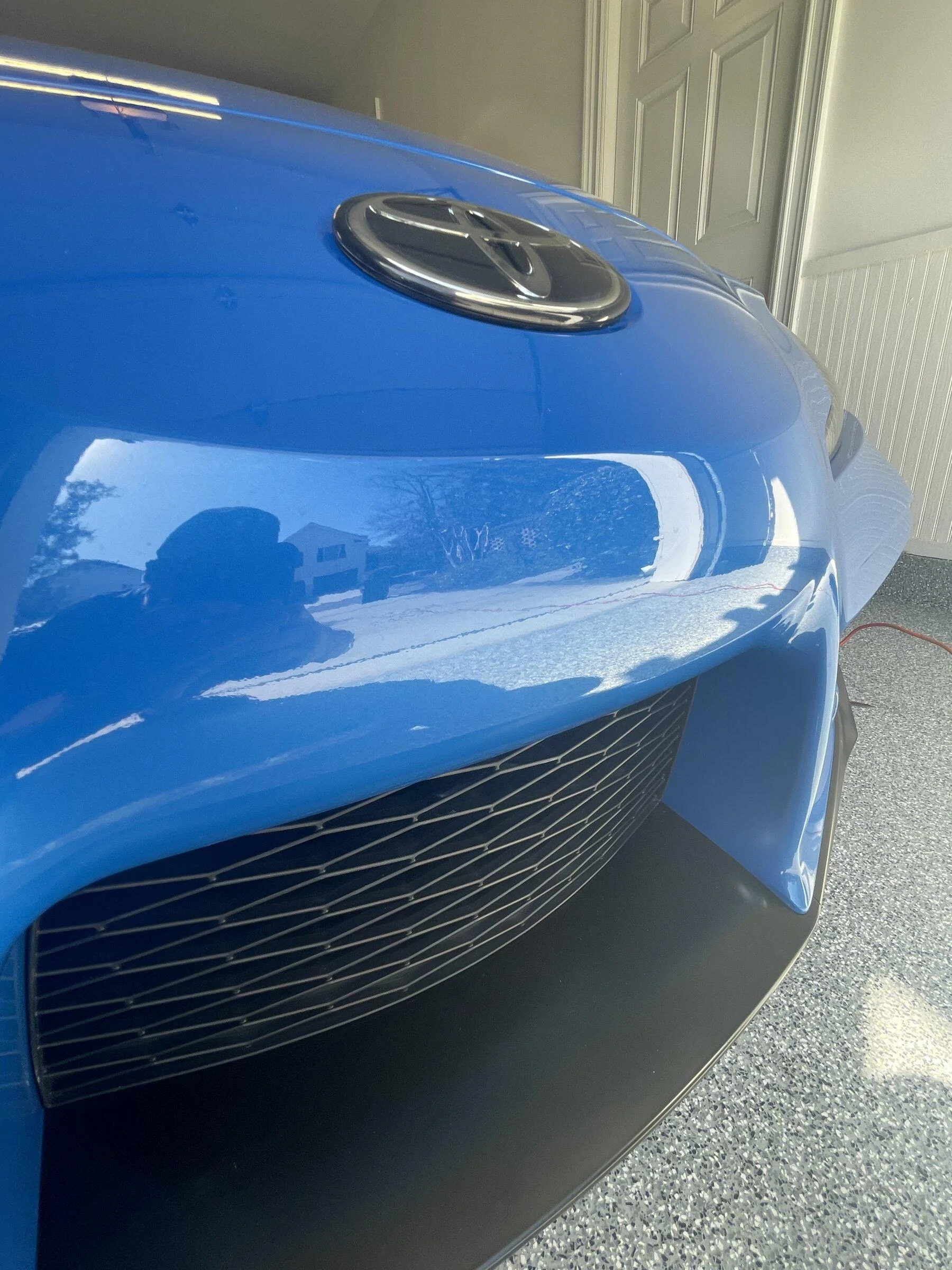

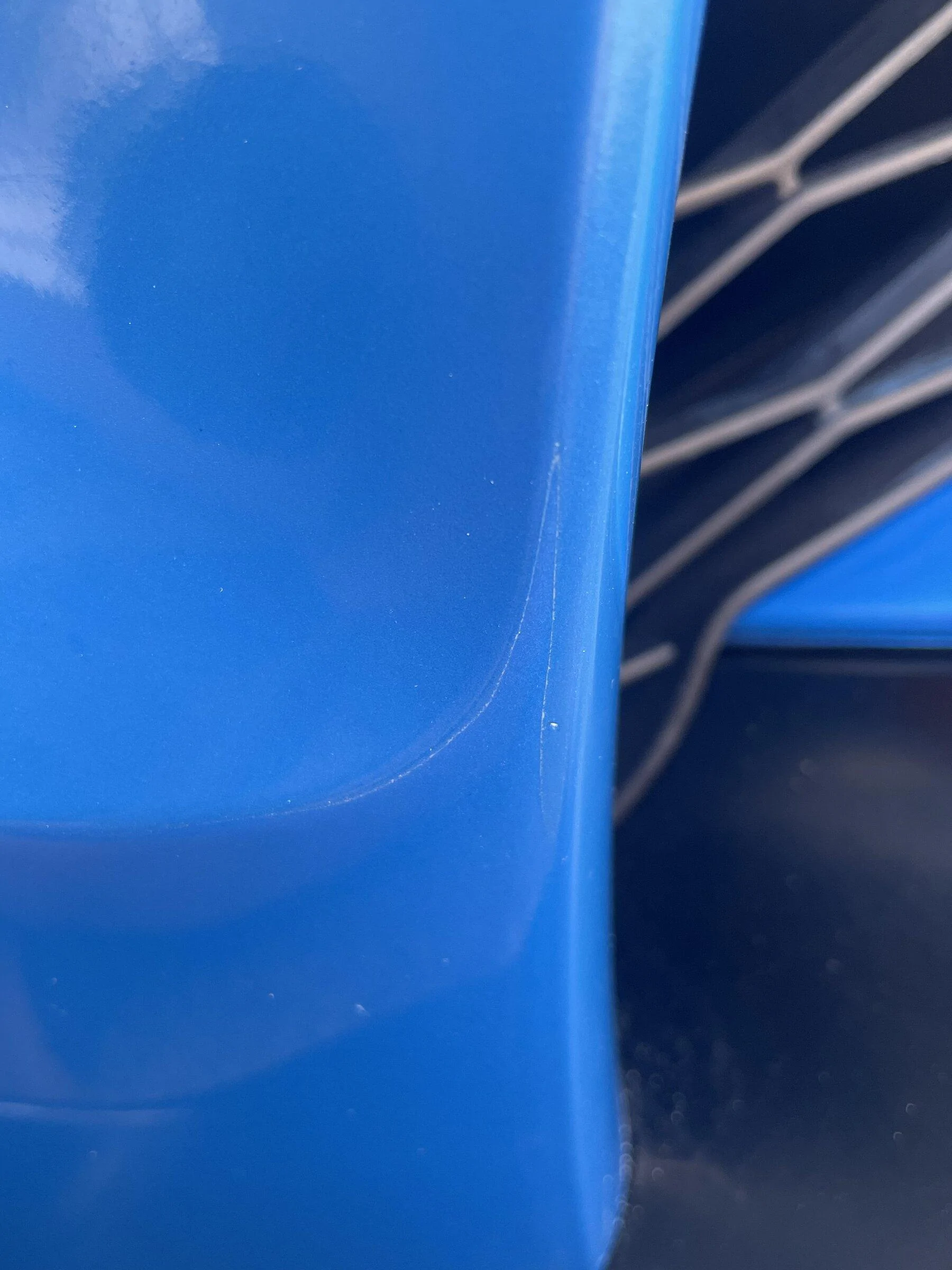

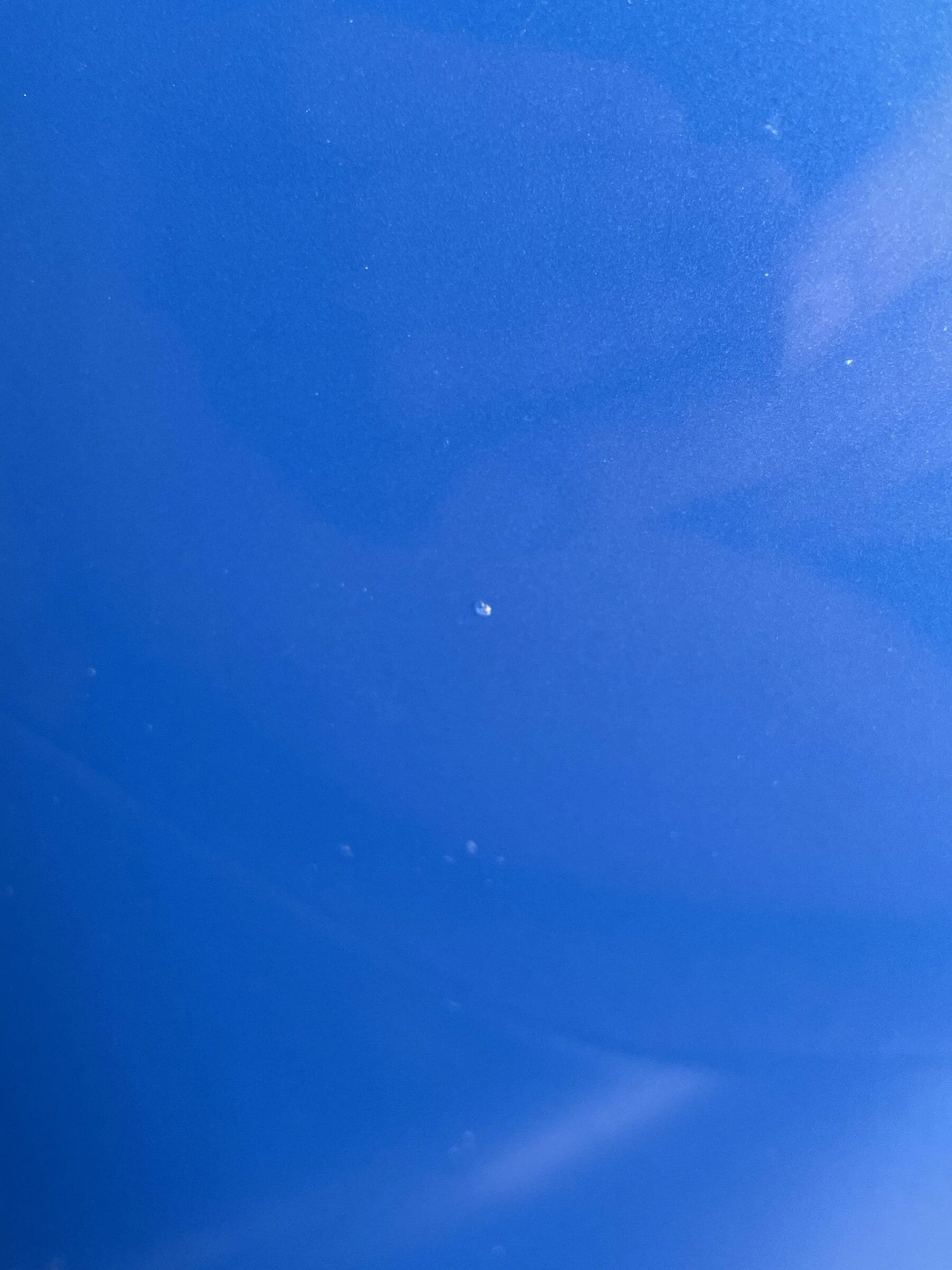

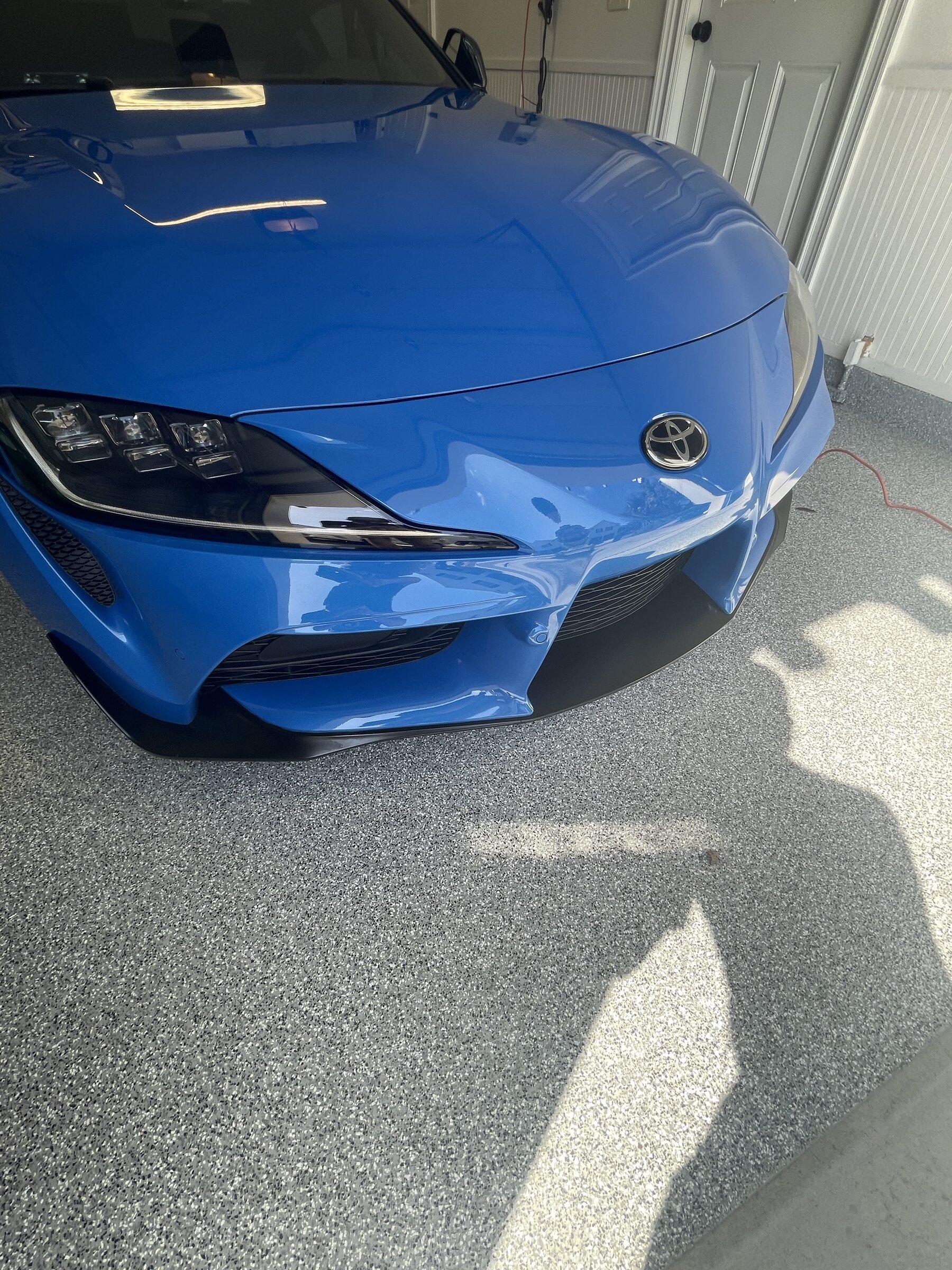

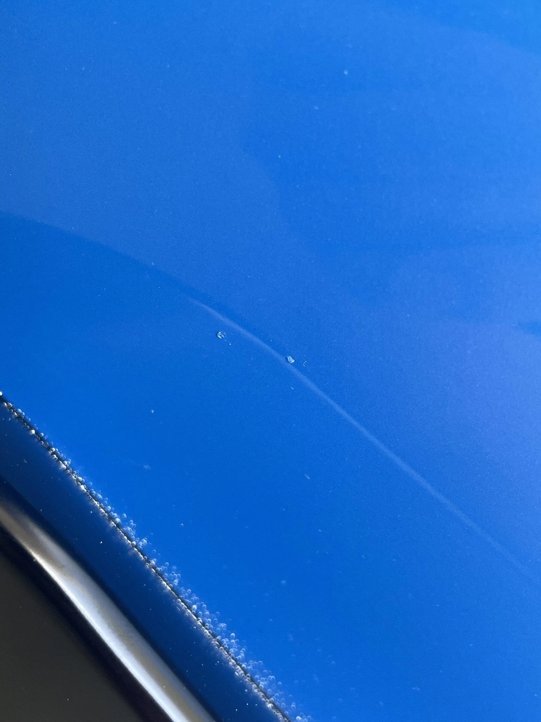

Just got front bumper reshot. Thoughts?
Aug 8, 2018
2,989
3,270
if you'll take it back.

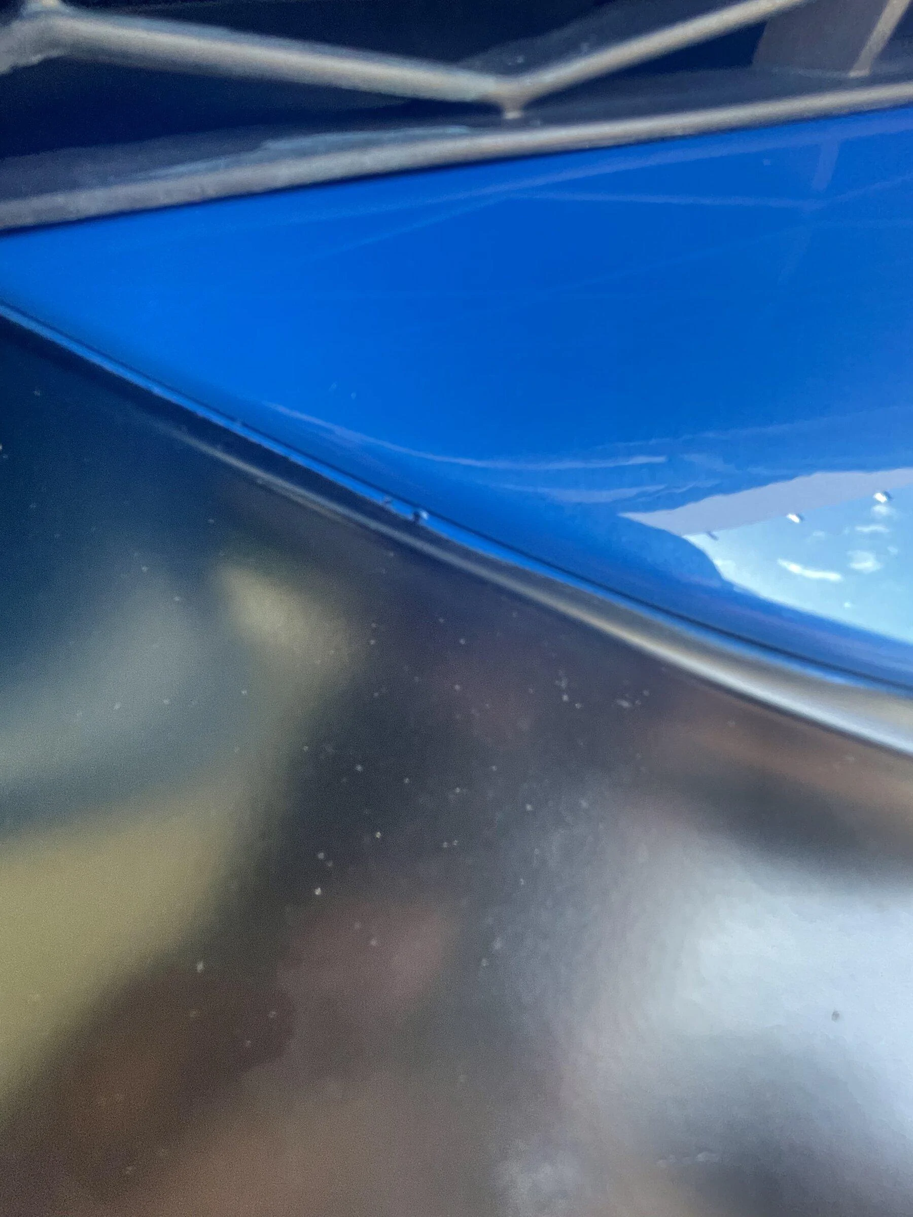

1) tell them to take the 3 lower panels off without breaking the tabs along with the harness and the side reflectors (with heat gun, easily removable) or take these off yourself and give them the bare bumper. Since paint matching is done, they can re-use the same mixture.
2) tell them to clean the darn room and close the door while painting or at least close the room as it's curing/drying.
3) have them sand and putty the imperfections.
If you will take it elsewhere, make sure you specifically mention 1, 2, 3 to them and get quote accordingly.

Yea… that’s crap work at best. Not worth what you paid. I would definitely be complaining. Until either they re-do it right. Or give you cash back for a huge correction project. PPF is just going to make that look worse.
Not sure what the bumper looked like before but that is shit work, imo.
At least they got the paint to match…

Sorry to see this man. It's the reason i parked mine for a month to get the PPF done. Personally, i'd take it back and tell them to do it right. I cannot believe they didn't separate the black trim pieces from the bumper to spray it, for one thing.

First pic looks OK as most paint does from less then up close. I have done my far share of paint correction and I know up close and photo zoom/microscope all paint is flawed but for 1100 I would not be happy with that. I would get them to fix or heavy discount. I would also be interested to see what it looked like before as that plays a roll in price/work.

Update: I have raked it back and they are reshooting it. I’m sure they read no manuals on taking off the bumper so I took it off myself, grilles, black piece and all. It was real easy. These guys are lazy. He even tried to convince me the black spiller was welded on ?. Hope for the best guys.

I was going to suggest just that. The bumper is not difficult to remove. Take it there and repaint it. Hope this application is more successful for you!

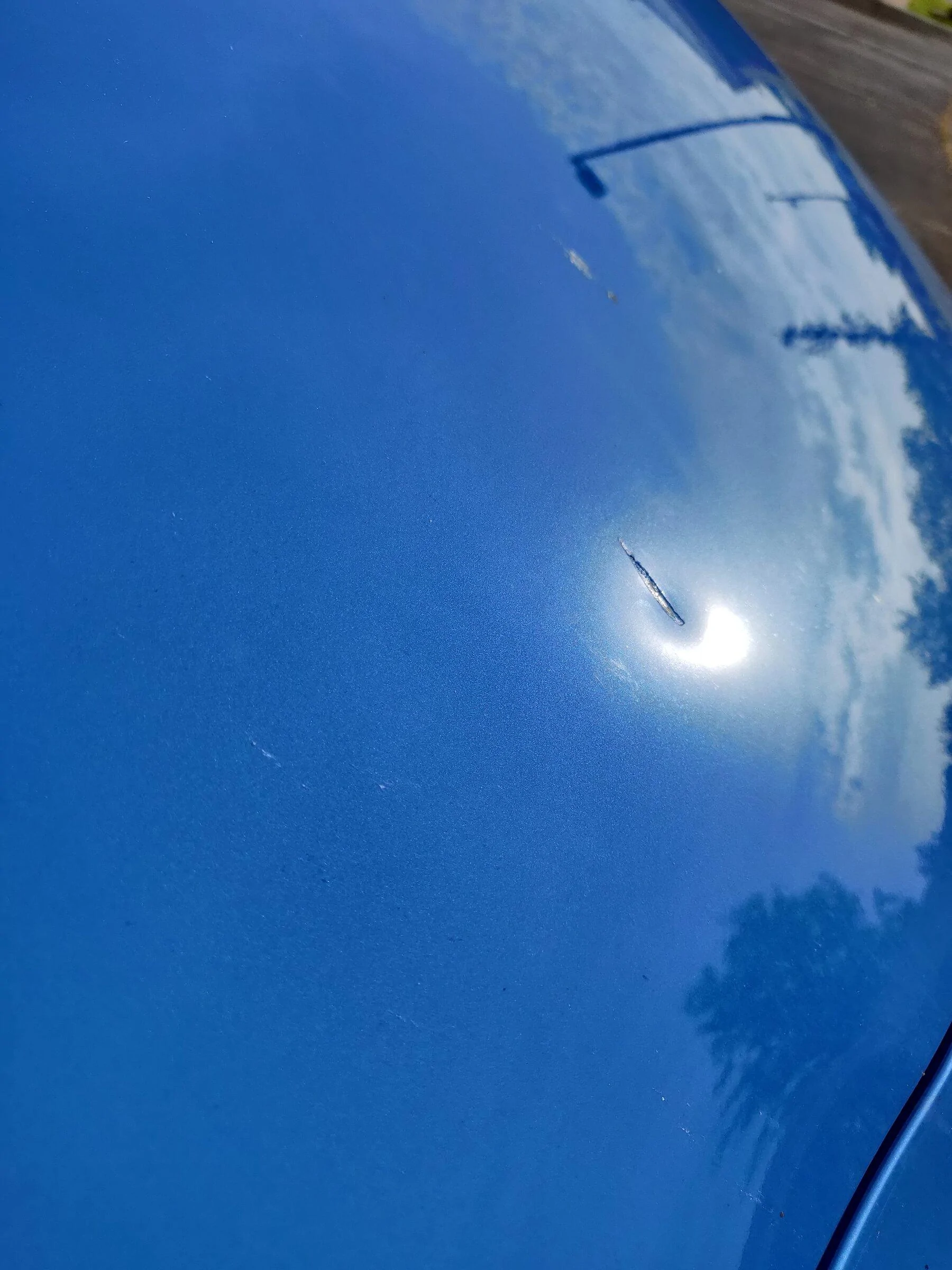

Photo of what I had repaired for reference:
