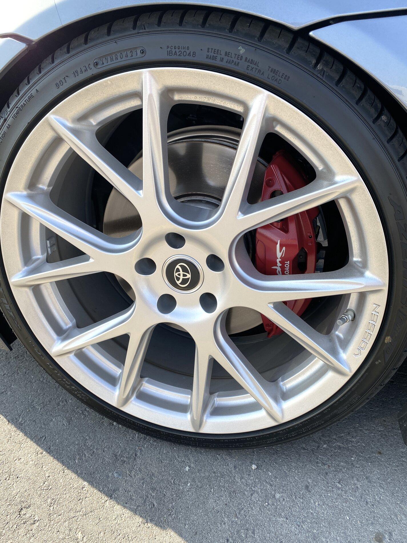

After 3 weeks and about 300+ miles, wheels are still clean! There’s still some minor brake dust but significantly less than the factory metallic pads.

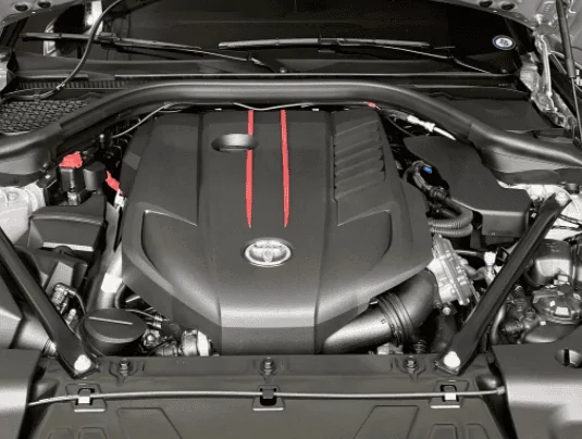

How do you clean the cover?
When I wipe it with a microfiber towel, it catches.
I simply power wash the engine at the quarter carwash with the soap and then rinse. I dry all of the other engine areas off less the main engine cover.
You are right the cover can’t be wiped down due to the grabbing material its made of. I sure wish it was made of a smooth black finish.

Once I find out the status of my Supra (oil burning issue), I’m going to have to get the low dust pads. Just amazing how much dust comes off of those things.

You won’t regret the change! I can go several weeks without washing now and the wheels are still noticeably clean.
