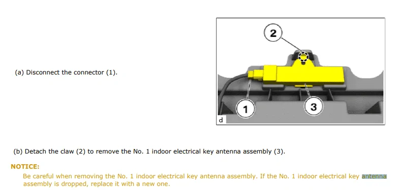

Yeah the dealer followed the manual:
Swapped rear antenna which was reported as faulty. Nada.
Swapped body ECU. Nada.
Took apart interior and swapped antenna. Nada.
While re-assembling the car a technician noticed the wire of the connector to the antenna in the rear was loose. He recrimped and voila. Works!!!
It works every time for the last 8 months. As new it never worked this reliably. Clearly crap quality control at the production site.
