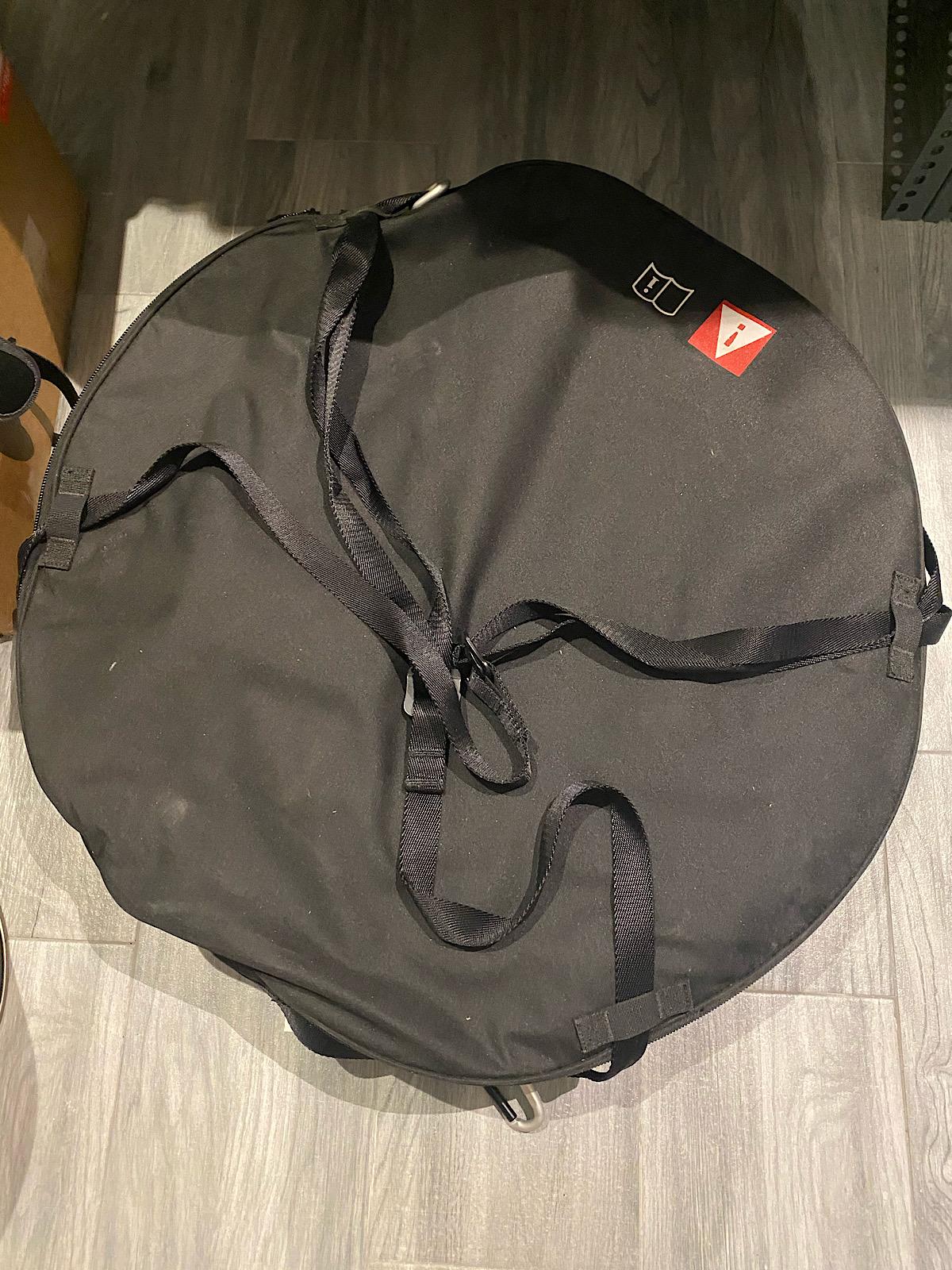

It looks like this is the BMW X1 spare

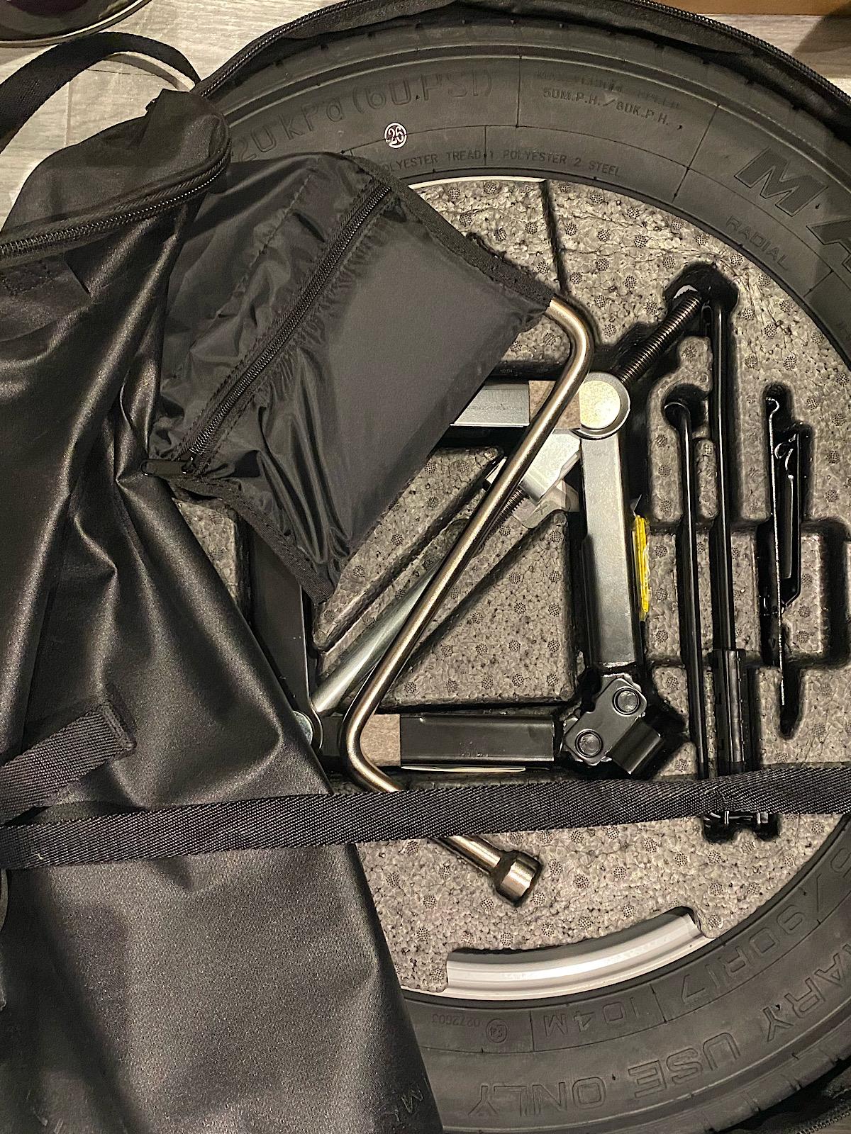

Tied down via straps
Does the bag strap the whole thing down tightly to the floor cover/board in the trunk?
Can you post if it has any part numbers on it? I've been looking into the modern spare but need some way to secure the bag...
a90moe
Nov 9, 2019
802
809
Earth
MKV Supra
Yes it straps down to existing trunk four points, I can't find any parts numbers

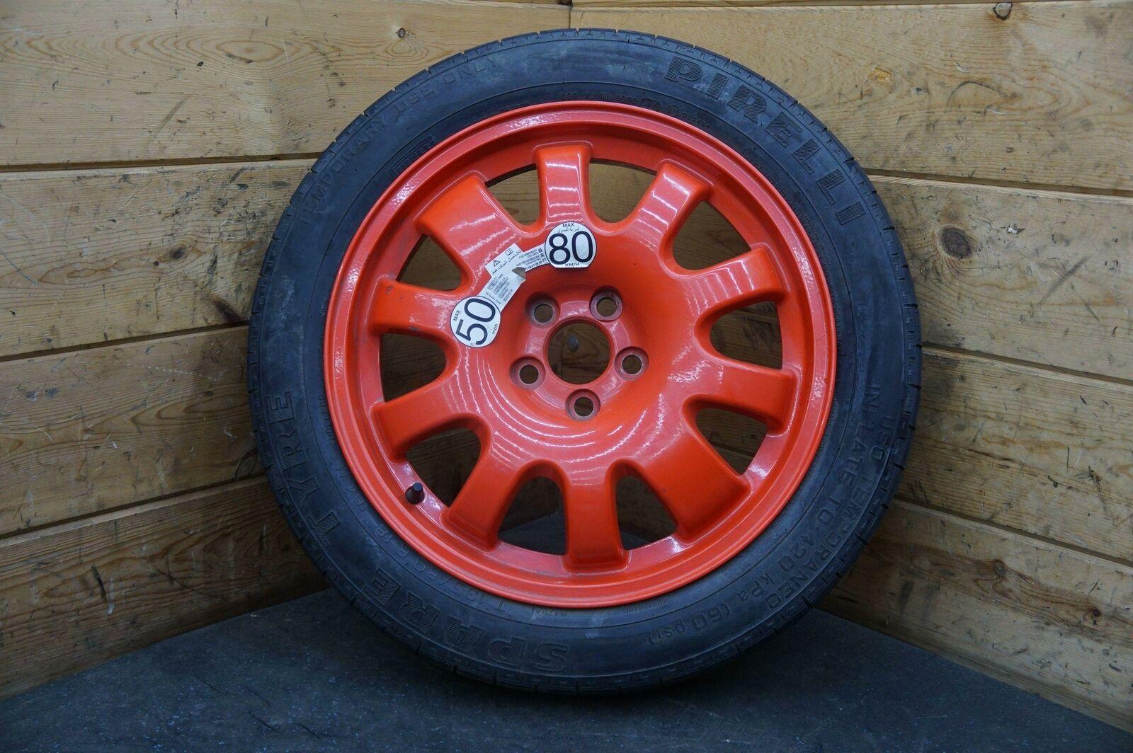

Interestingly enough, I found this: https://parts.toyota.com/p/Toyota__Supra/Wheel/78452560/42611WAA07.html
This is an 18" wheel, supposedly an OEM Toyota part for the 2020 Supra.
I had a blowout on I-45 right outside Dallas on the passenger rear. It was New Years eve at 4:45pm. Not to mention we were in a horrendous thunderstorm. Ended up calling a bunch of tire shops, all said no luck since they were closing. I ended up finding one guy who felt bad for me. Sent one of his shop guys out to come to me on the side of the freeway, pull the wheel off, take it to the shop, swap on a used MPSS he had laying around, and then come back and install it. For $100. Christmas miracle if I've ever seen one haha.
But I'm not testing my luck again. I think I'll pick up one of these spares and just throw it in the back and take the L on luggage space. I drive far too much cross-country to chance it again. I'll have to figure out a way to strap it down too, but I'm happy that these exist at all.
