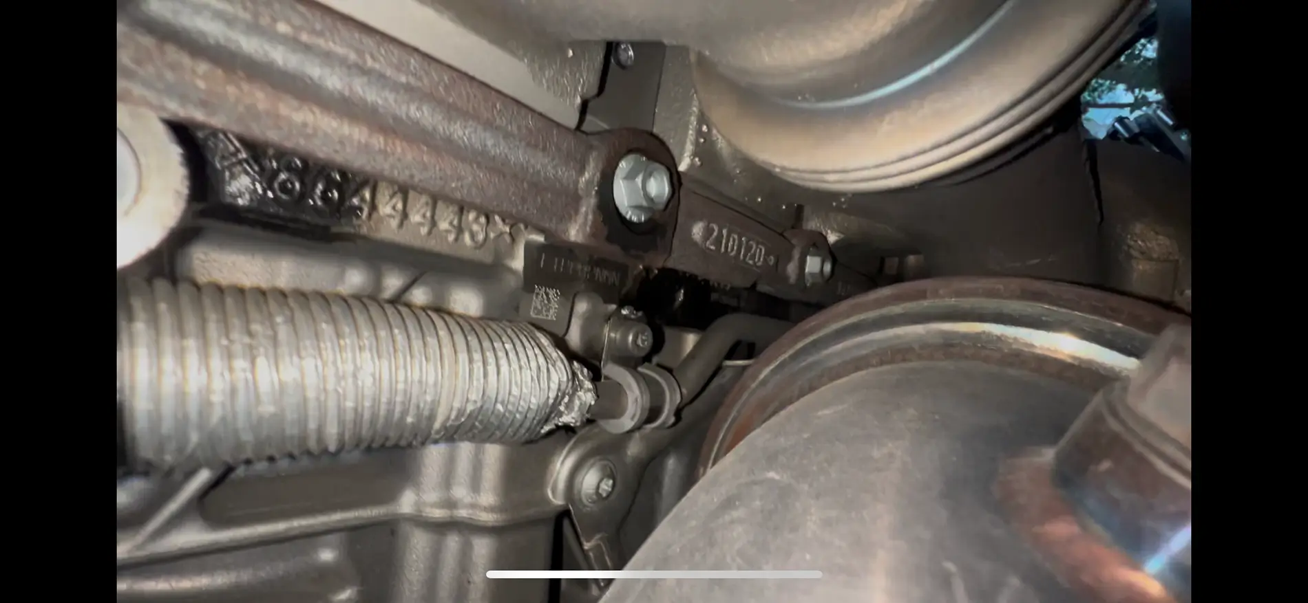

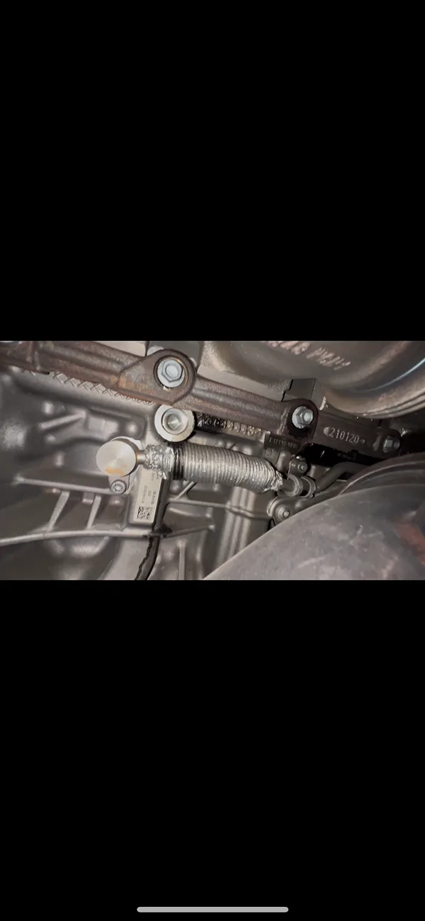

Hello all,
I have a b58tu with a Pure850 and I have some sort of leak after 1 year of ownership of this turbo. I’m around 32/33 psi in 3rd and 4th gear and 5th gear I see up to 35psi (stock trans I don’t go in 6th gear).
Can someone please look at these photos and let me know what you think?

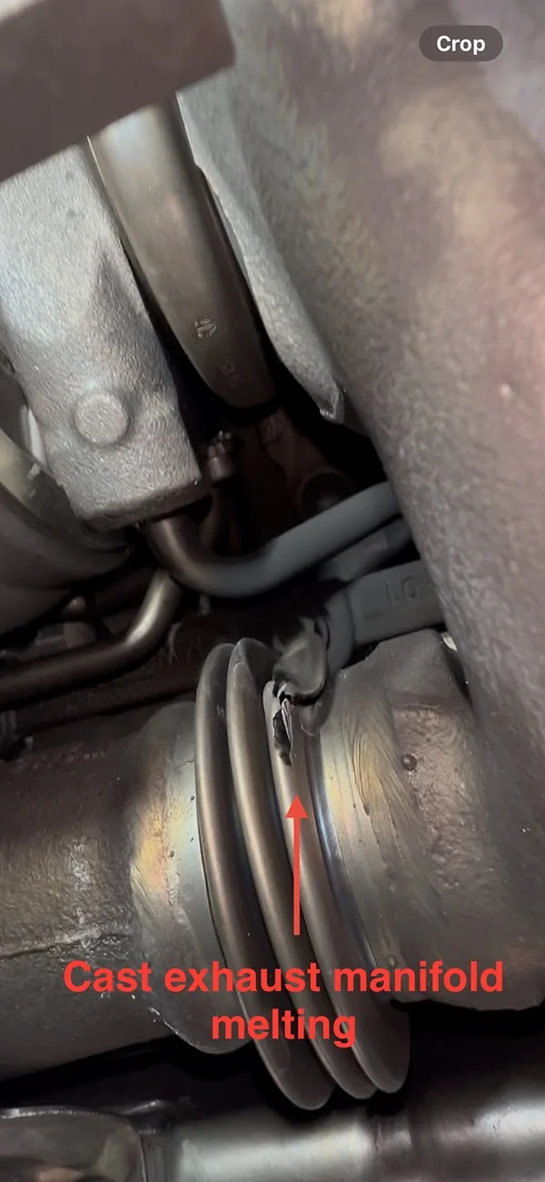

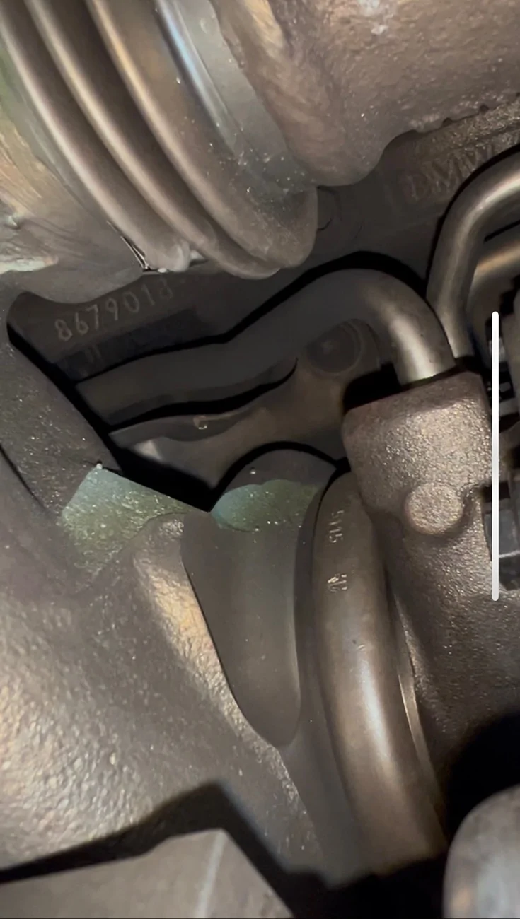

There is oil at my drain plug area everytime I do an oil change but it’s not a crazy amount. Also my exhaust manifold seems to be melting 😳. The hardlines connected to the pure turbo seems to have signs of an exhaust leak?

Three thoughts:
1) Was a new gasket used for the manifold?
2) Was a tightening pattern followed when bolting down the manifold?
3) It looks like your manifold has cracked due to thermal cycling stress. Hard to say if it's a metallurgy problem, a material thinness problem, or a weld failure.
But you absolutely have a leak between the block and the turbo, judging by the soot pattern.

It was installed at a professional shop that works closely with PureTurbos, so I’m not sure how they installed it.
What makes you think the exhaust manifold is cracked?
This looks to be a gigantic crack in the manifold. Is the picture deceptive?
But yes, you have several leaks between the block and the turbo. The shop should revisit the work if it is under warranty. You may need a new gasket, but those are inexpensive.
8,840
17,335
that expansion joint actually looks like it was damaged prior or during install. It wouldn't fold over itself from heat.

I don’t see a crack on the exhaust manifold. But regardless, Pureturbos is saying that expansion joint can be welded. Thoughts?
weld should be ok but gonna be some mickey mouse job lol should push for a replacement

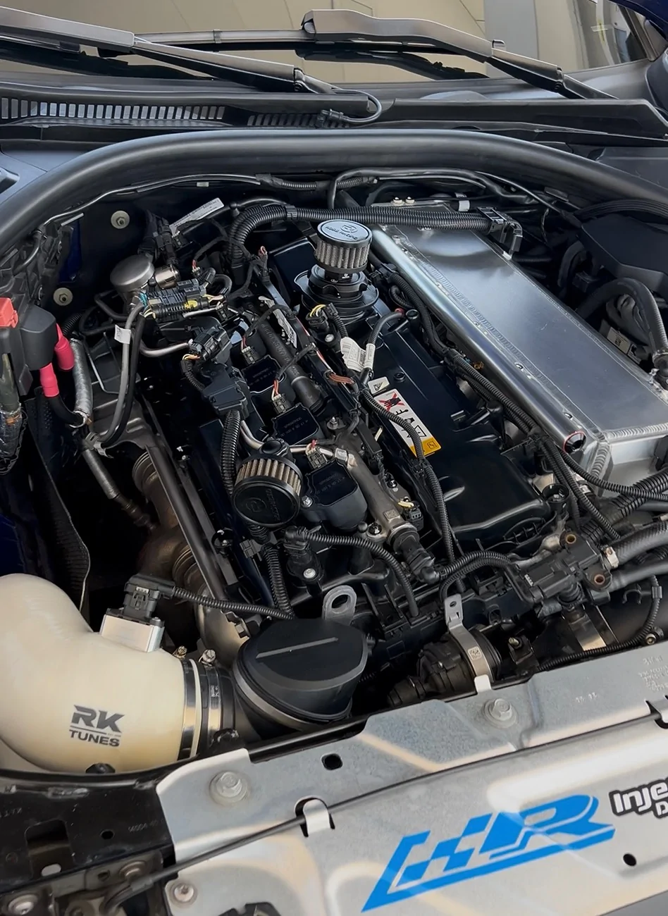

Crazy amount of boost btw. Have you got cooling mods and catch can? If not, i would suggest having a security blanket. Hope you get it sorted. My aim is to run a larger turbo and no more than 20psi to induce a little lag vs my stock turbo, reduce temps but provide a more linear power delivery for circuit work. I cant decide between pure turbos or TTE ( i have used them in the past with no issues)

I have the PCV block off pins from bmr with Ross racing oil cap breather and banjo fitting/filter at the PCV. I like this setup because you don’t have to maintain a catch can, just Vent to atmosphere. My engine bay doesn’t get oily at all.
