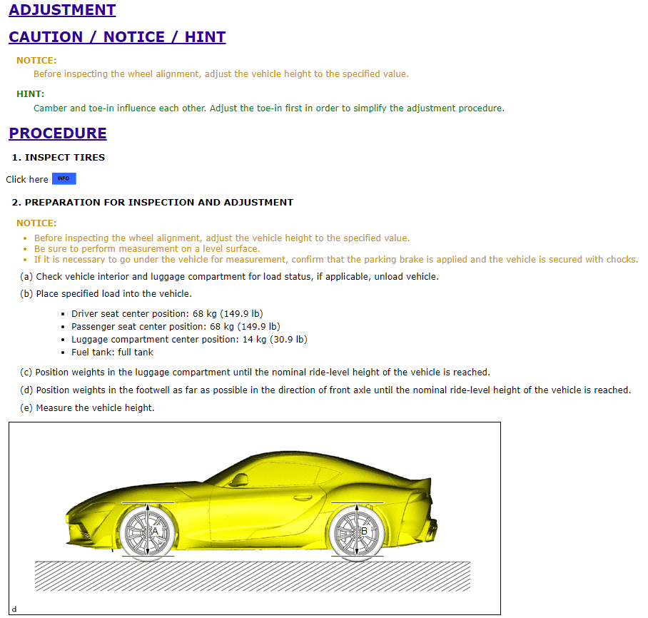

What is the dealer talking about that they need the "BMW tool"????
Not too sure about that either, but I recall many BMWs want these specific-weighted bags (or equivalent) on the seats & cargo area to simulate the weight of an occupant or two. Apparently the MKV is no different...
That's just a high quality "right" way to do an alignment on any car, as if someone is actually driving the car. Good motorsport shops have you sit in the drivers seat or put equivalent ballast in while aligning the car. That said, you really don't have to be that precise.
