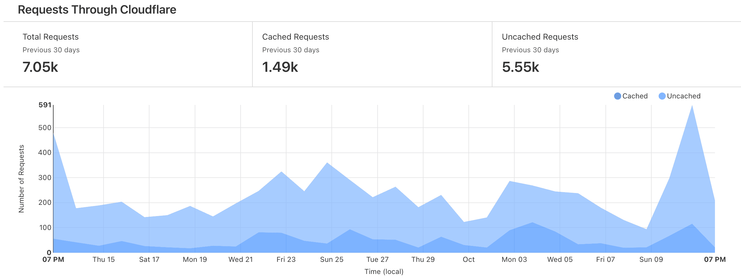

IS NO ONE PAYING ATTENTION?
You can partially unlock the 06.2020+ ECUs. I've said this 200 million times. lol. The partial unlock allows read/write access to the Calibration Table area of memory ONLY. To write to the SWFL layer and bootloader areas, you need a < 06.2020 ECU and have your 06.2020+ ECU data cloned onto it.
The SWFL area of memory is where custom software is written, the cal tables are data only. This means, flex, map switching, boost solenoid control, etc. cannot be done with the Femto Unlock only. You need a clone. A clone requires two ECUs.
having to say this 2000 times makes me feel absolutely insane. I even put together a handy website. https://willmy062020plusecugotorussia.com/
I have almost never seen any mixed information. It seems so incredibly cut and dry all over the forums. You want an OTS map, or a custom CAL ONLY map using MGFlasher, WinOLS, BM3, or MHD, you just need an unlock. You want flex, launch control, big turbo/external gate, flex, etc. etc. etc. You need ECUTek and a clone.
It's not like the site isn't getting any traffic.....
Wait a minute... do you mean to say that a 6/20+ ECU will have to go to Russia and will require two ECUs?!?! I had no idea. You should have mentioned this before. :p You should probably post that somewhere.
