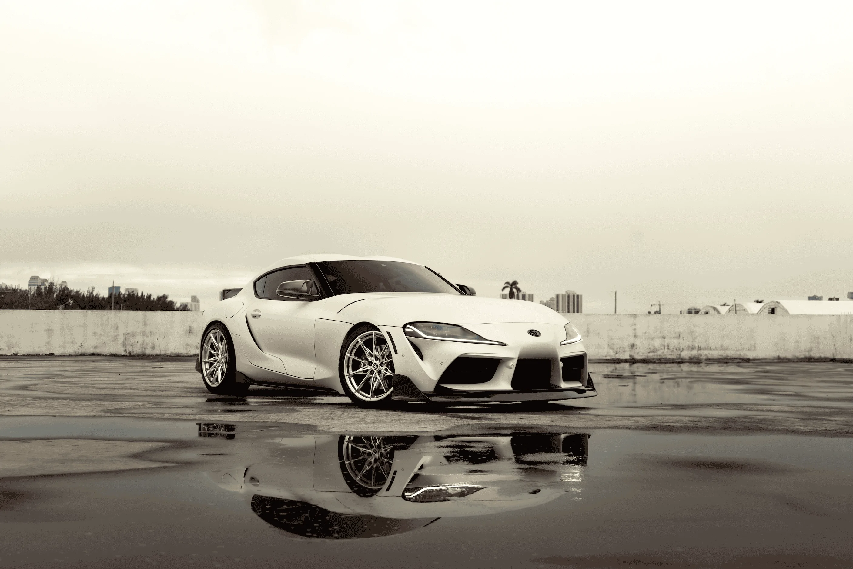

My A91 MT on the HKS adjustable, this is prob 1.5 inches give or take from stock.

How do / did you like the HKS adjustable? Are they the Hipermax touring springs? I'm considering them with a 1 - 1.2" drop.

Aesthetics is definitely the main factor for me. From what I have read thus far, the HKS Hipermax Adjustable Touring Springs have pretty good reviews for ride quality. I don't expect them to be the same as stock, but I'm willing to sacrifice a little of the ride quality for a better stance.
