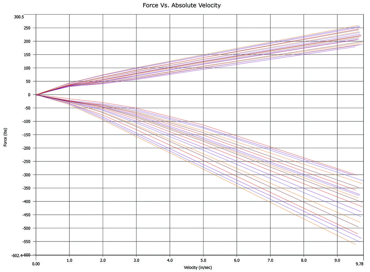

1 way gives you rebound dampening adjustment, 2 way gives you rebound and compression. I never had adjustable suspension on a car I took to track so I am not sure if I would need compression adjustment and the $1k in savings would be nice not gonna lie.
My suspension understanding from dirt bikes:
Increased dampening is slowing down the shaft movement in a shock. The more dampening, the slower the shaft moves and faster it gets out of oscillation. Compression is when the suspension is compressing, rebound is when it is extending. Slow/High speed is when the shaft (not the vehicle) is moving slowly or fast. A sharp bump at slow speed would most likely still trigger a high speed circuit where a gradual whoop/g-out at 100mph possibly would valve through slow speed circuit. Overly damped compression was bad in dirt bikes, it would make the bike run on the top stroke of the forks and caused a harsh ride, overly damped rebound would slow down shock too much and the rear wheel would not extend fast enough to make contact with ground after a compression stroke, losing traction etc.. etc..

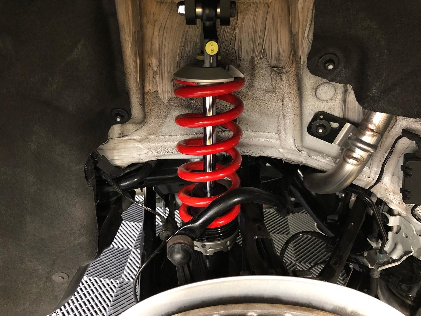

Both very capable. Just depends on how you want to tinker. The adjustment in the rear is kind of a pain to get to you, you have to jack up the car. It's either at the top of the strut or bottom, depending on how you mount them. I would go for full coilover conversion in rear, makes things much simplier, imho. No issue with chassis mount strength.
I've used over a dozen different coilovers in my life and the MCS are by far my favorite thus far. Worth every penny if you are serious about tracking.
One thing to note (if you care) is that it's cheaper to upgrade to a remote system if you get the 1WNR, compared to the 2WNR. I inquired this last winter and it wasn't far off from just outright purchasing 2W Remote brand new. Basically the 2WNR internals are completely different.
Location of the rear adjustment. Some people mount them the other way and they are even harder to get to as they are basically hidden in the lower arm crevice.

MCS told me it's cheaper to upgrade the 1WNR to 2WR because of the internals. The 2WNR have totally different internals because both Comp/Rebound are in the body, and I believe the 2WR have one adjustment in the body and one at the remote canister.
I only messed with my adjustments a couple times this season but I am kind of hard headed about not making too many adjustments all the time. I currently run: Front 5comp/7rebound, Rear 6comp/9rebound with 650lbF/600lbR springs with Verus aero. Last year I ran 550/500 springs with no areo.
Remote reservoirs have advantages that they have more fluid, so heat effects them less, and also since they have more fluid, they can have better ride quality with stiffer springs. That said, my 2WNR on my Supra is the best riding "track car" I have ever owned.
