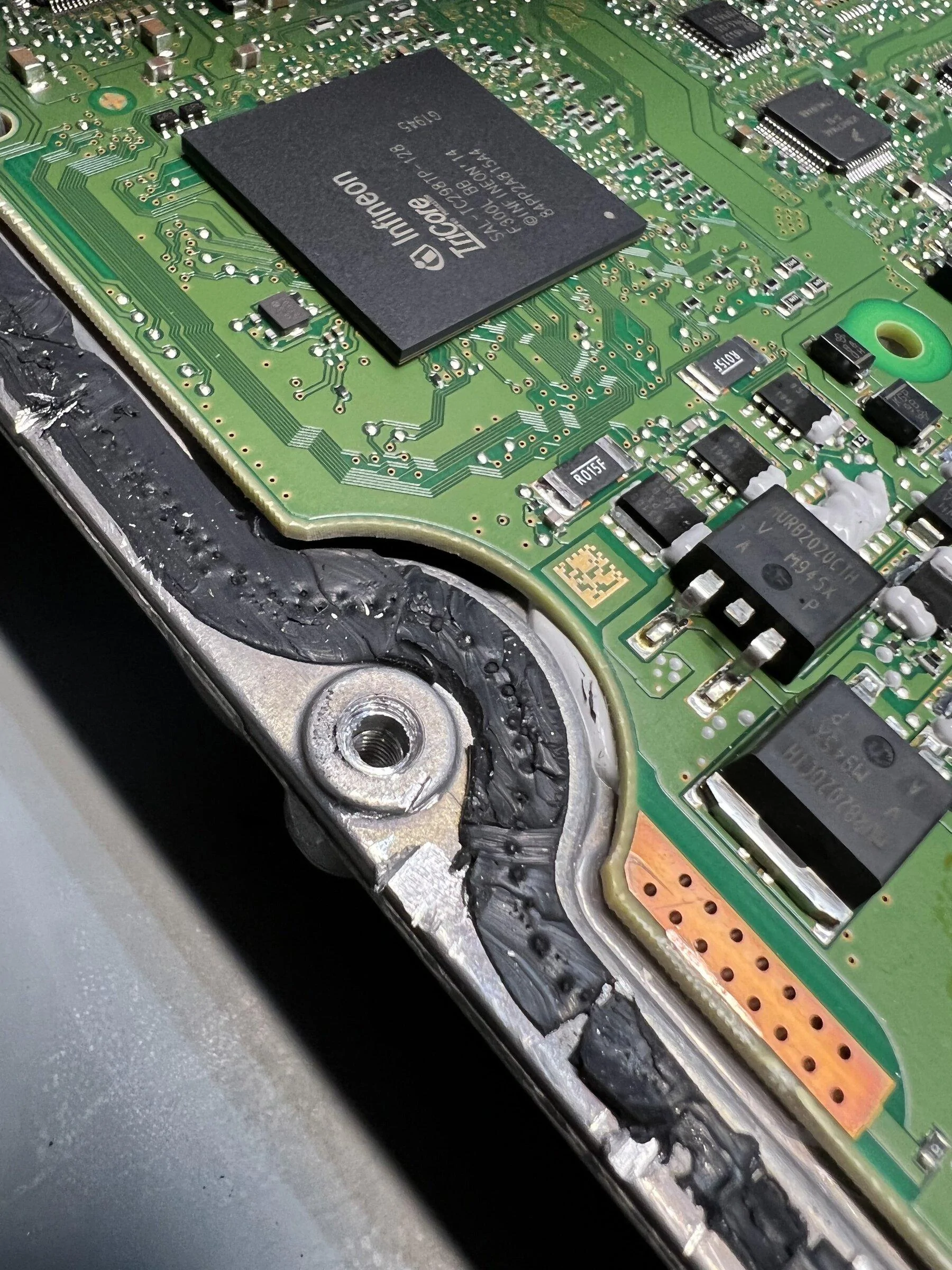

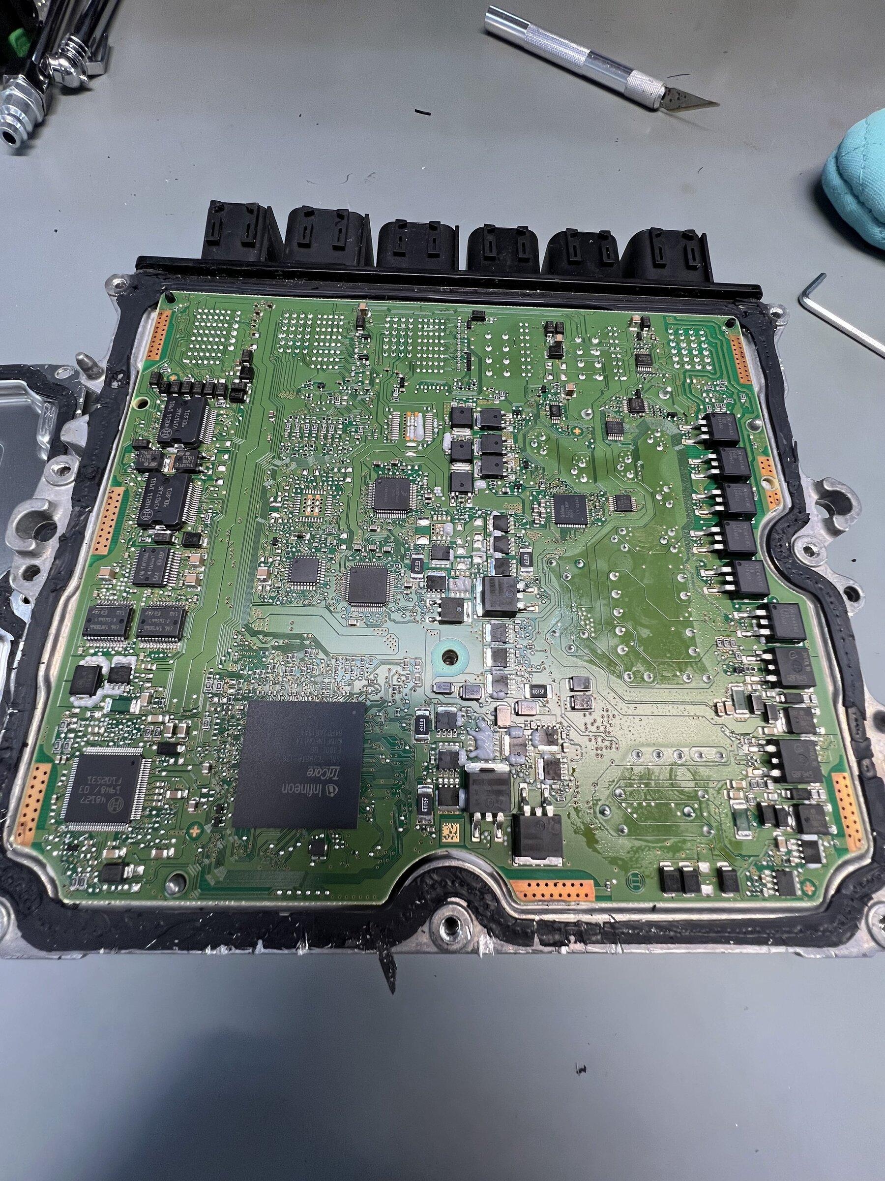

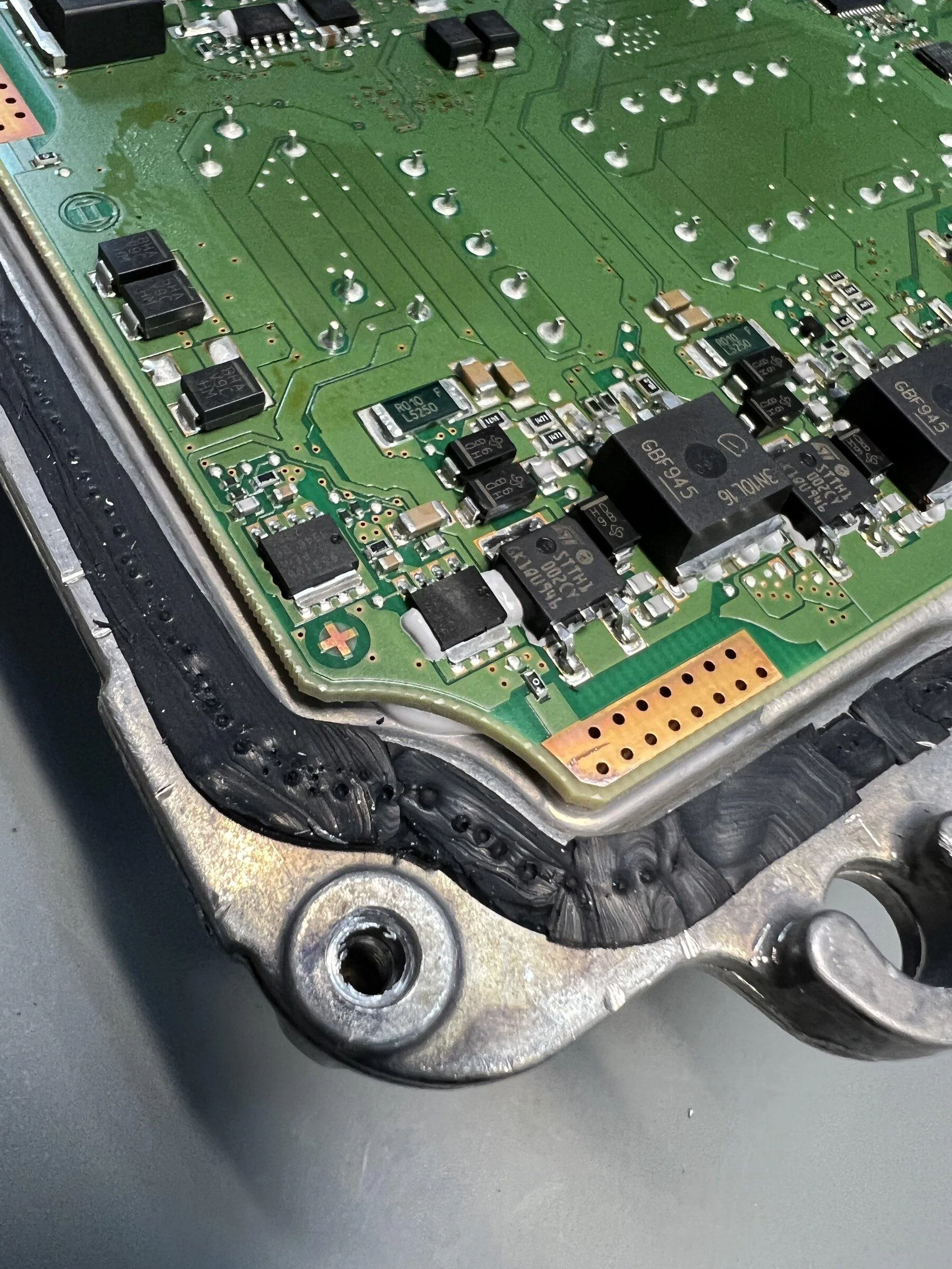

In the above video he used some "special lid extraction tool" or whatever he called it. Not at all needed. We used M5 screws and the trick is here that the OEM threads are smaller than that, but the hole on the lid of the enclosure is just big enough the M5 threads grab on to it and pry it up from the bottom half. We took it slowly, applying heat with a heat gun, slowly screwing down the M5 screw, then getting in there with a hobby knife to cut away at the silicone. Once we got all three sides that we could reach cut away from it's silicone bonds the lid just gently lifted away from the bottom half of the enclosure and we are left with this scene:
Once we reached this stage we stopped to do some light analysis and inspection immediately we noticed a small component fall out from between the PCB and the bottom half of the enclosure. This signaled to us that the extent of the damage must only really be observable from the other side.

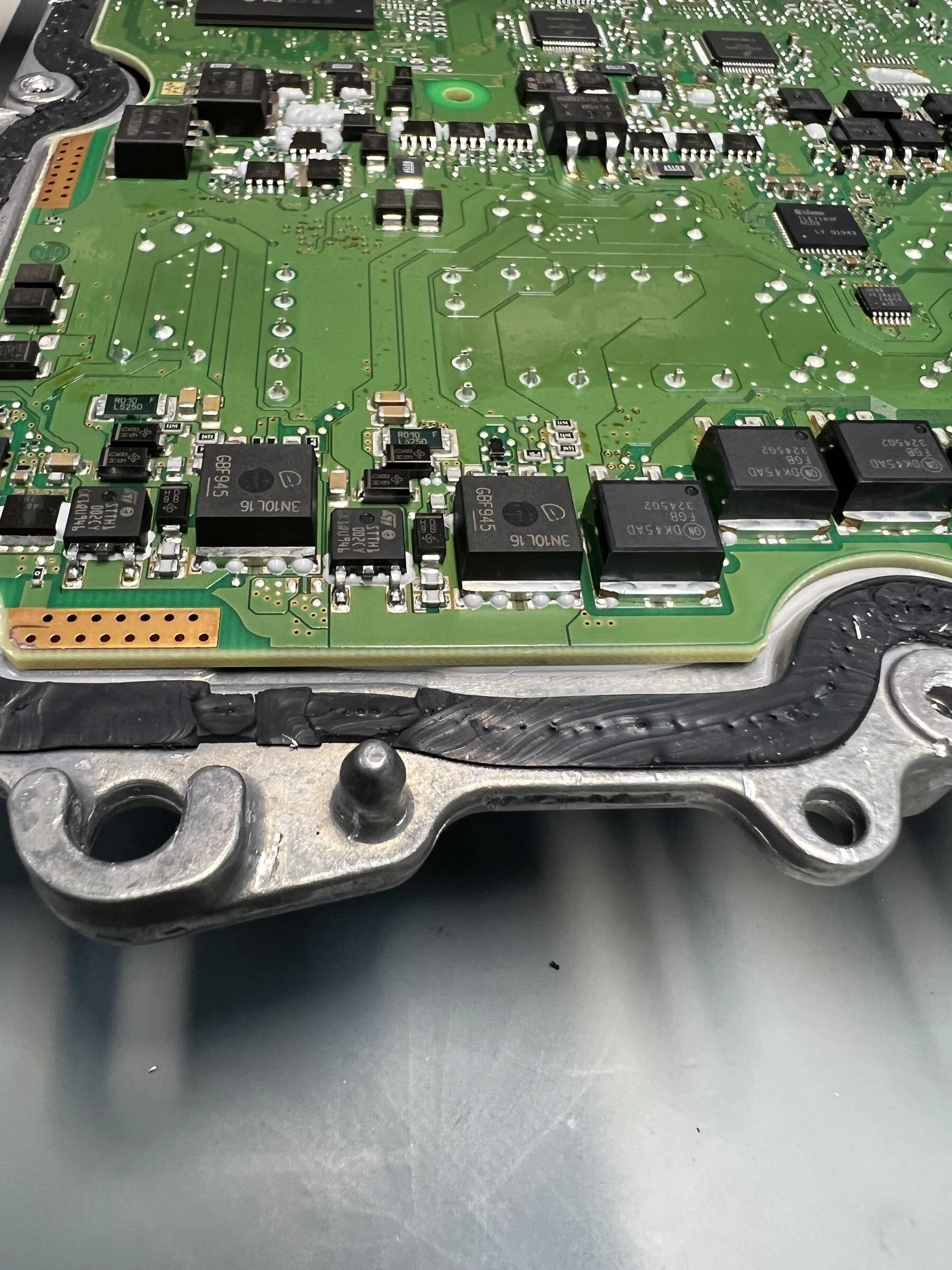

This made us conclude that we wouldn't be able to just reflow the solder from this side, and solidified the need to remove the bottom half of this enclosure. Now we begin to face some real challenges. After exploring some more we found lots of deposits of what appears to be a silicone based thermal paste (The white/gray looking stuff). This stuff is EVERYWHERE! And there is a HEALTHY amount under the PCB, adhering the PCB and the metal enclosure together. See some macro shots below:
This stuff is soft, and very very sticky. We hope not to destroy the PCB when trying to pry it out. We can also see some additional black silicone glue that is holding the top connectors (the plastic covers for them) directly to the exterior metal of the enclosure. This is going to be tough. We have a plan to try a two pronged method here.

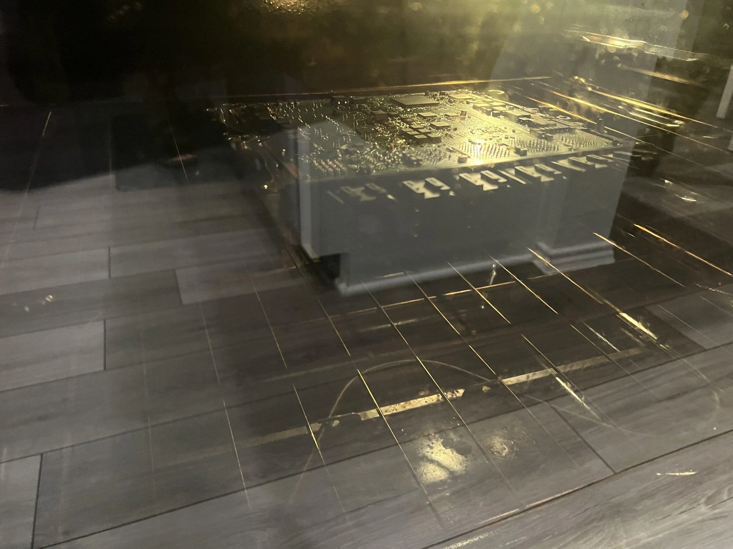

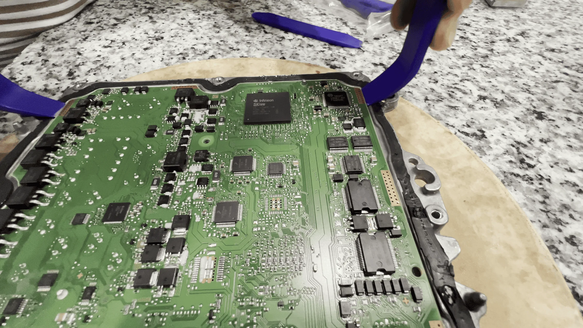

Well we decided yesterday to give the ECU to the oven. This went about as well as expected.
We initially tried the lowest heat setting, doing our best to avoid heat exposing the plastics too much. This turned out to be not nearly enough. We moved on to using a 250F set temp, with about 10 minutes decided in the oven so it would get nice and hot.
So we pull it out, blazing hot, and the black silicone along the outside edge is now very malleable, but the white/grey silicone all over the board and underneath won't budge a bit. Our plastic pry tools seemingly could do nothing to budge the PCB.
What a bummer. This stuff might be some sort of silicone-based thermal paste in here. If that is true then the temperatures at which this will give way will be much higher than we want to heat the entire ECU. This leaves us with the remaining option of solvents.

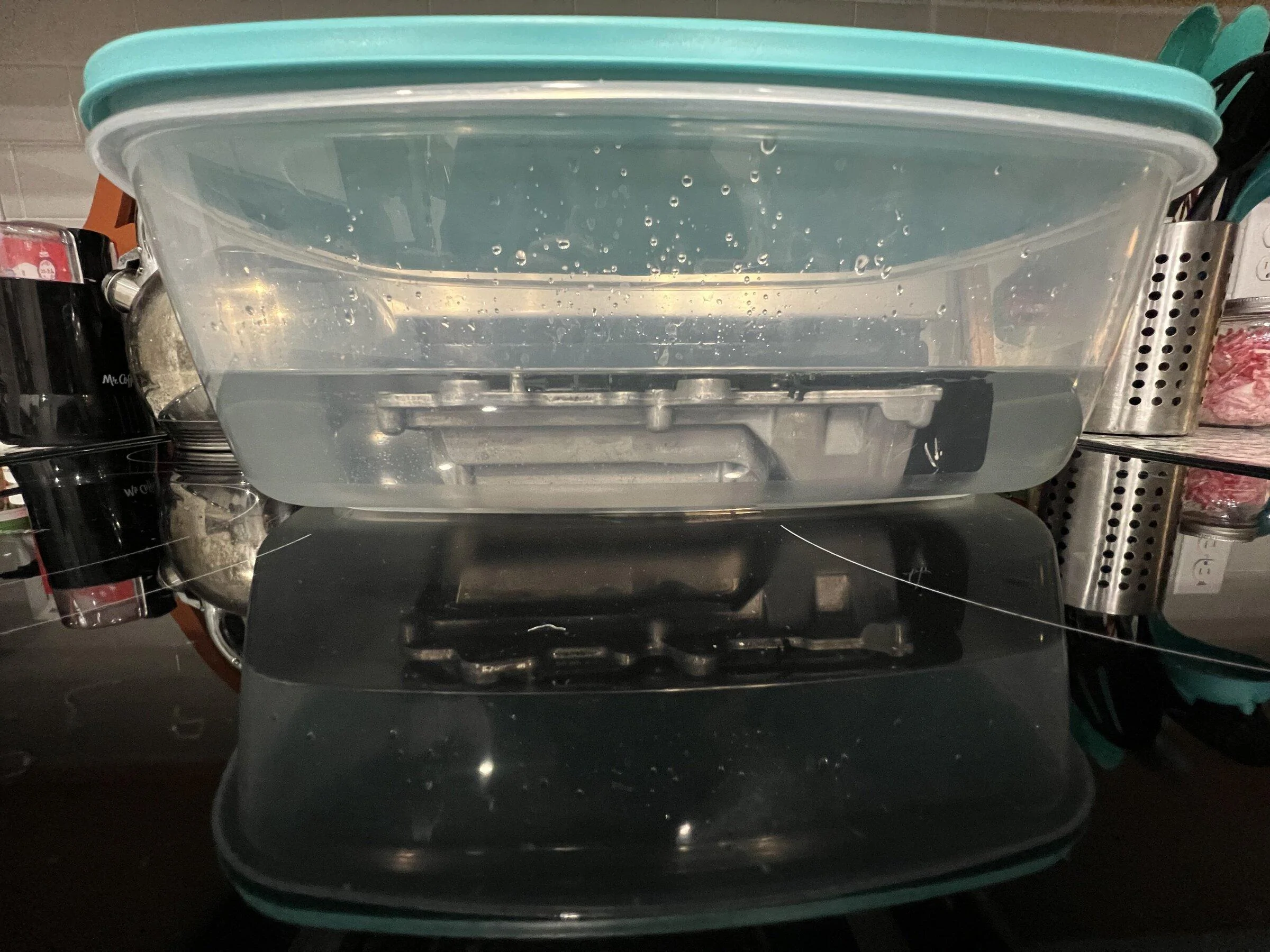

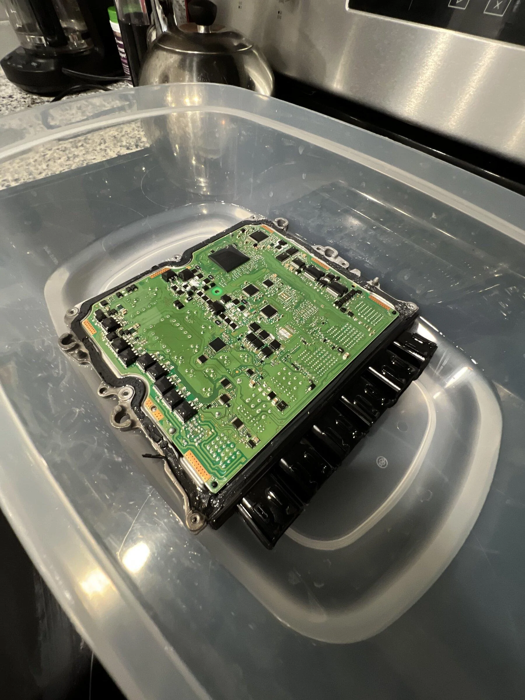

No we didn't do this lightly. We really think our only chance to get under here was to blow $80 in 99% ISO to get in there and dissolve the thermal paste. This will stay in it's container for 24 hours and I will drop another update if we get movement. Already the morning after I noticed some bubbles forming, so hoping for the best.
Please chime in if you think you know what this stuff is, or if you've cracked one of these open before.

New update above... things didn't go well last night. No progress was made, but we've set it in some ISO hoping for enough to break free we can lift it out of the enclosure.
Have you dealt with this crap before?

It is some type of really interesting stuff. I can cut away at it after 48hours soaking in ISO. But the difficulty now is actually getting a blade underneath the PCB, between the enclosure.
I can’t seem to pry the PCB up enough to cut away this material, and I’m concerned going stronger with solvents will destroy the PCB unless I pick the magic one that is meant for work on these boards.
I’ve heard some people out there try solvent baths in ultrasonic tanks, but seemingly this will just rek the components in the process of dissolving this shit.
I sent some pictures over to a few ecu repair facilities that work on sub modern Bosch ECUs hoping for candid feedback, but I’m stuck in research mode until I can find a new attack angle here.
