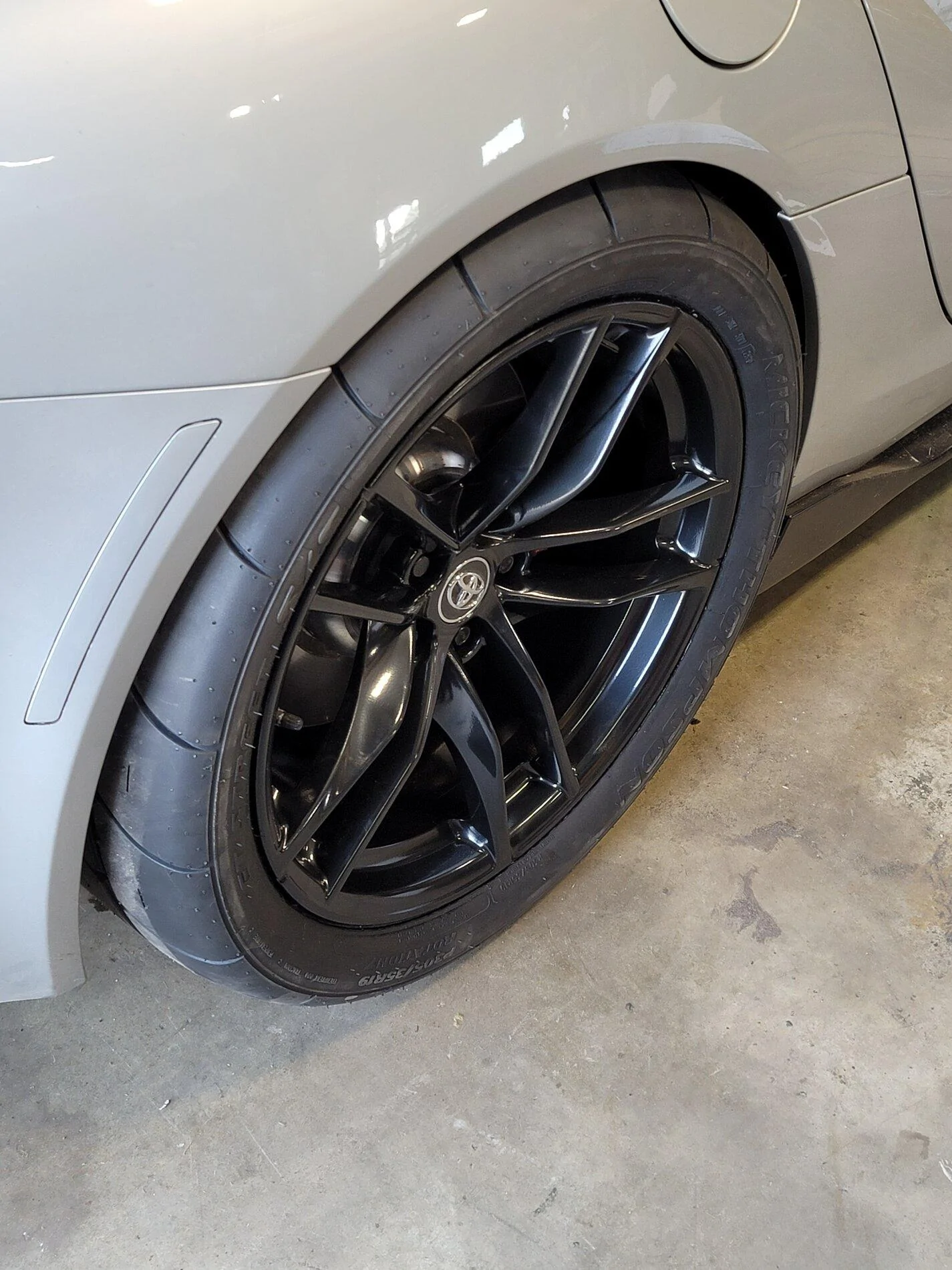

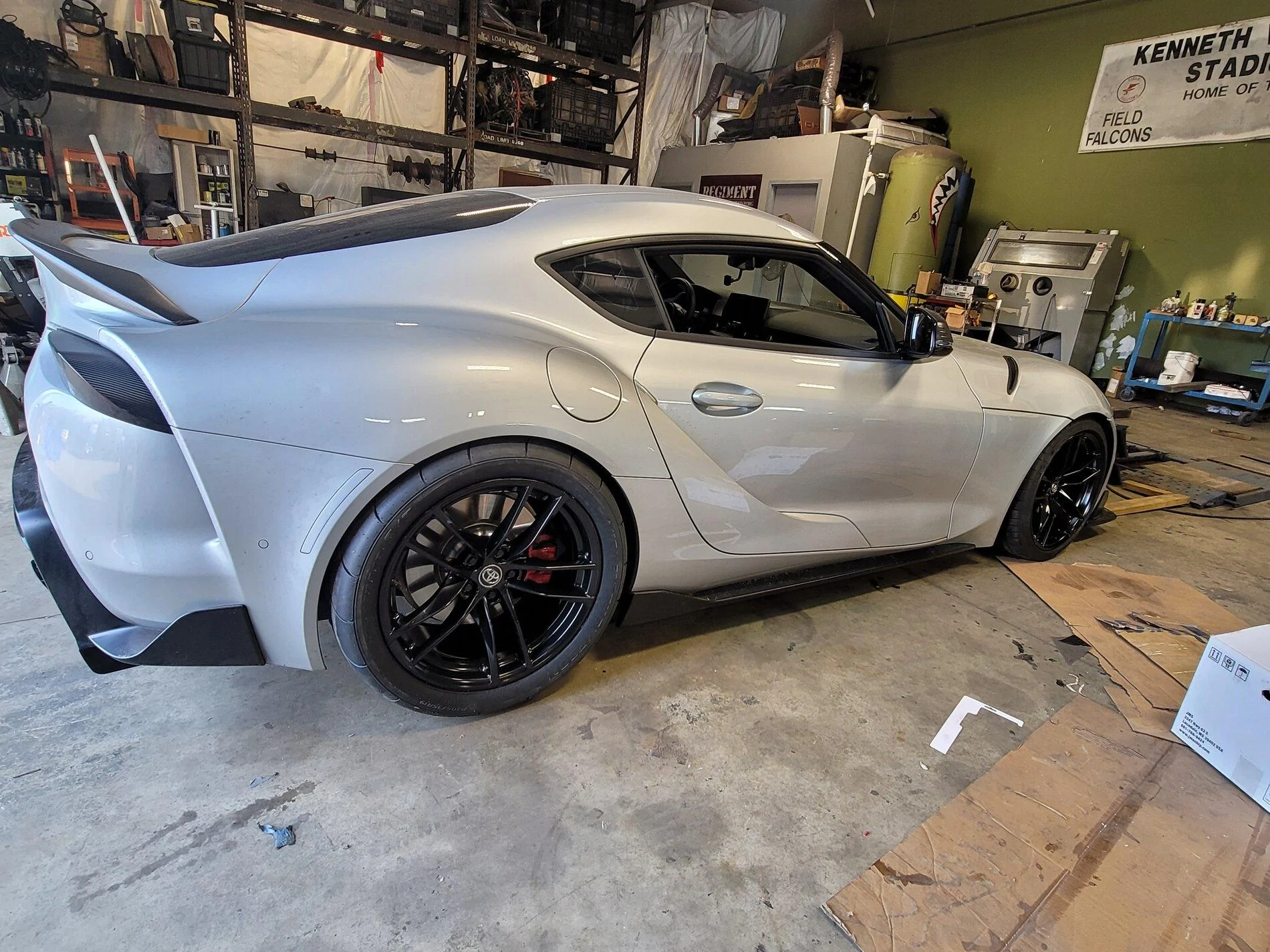

Szokdogg
Rob
May 30, 2020
36
Garrettsville Ohio
2020 Supra, 2018 Jeep Trackhawk
Cars at the shop right now. They are telling me it's definitely going to rub with my 15mm spacers installed. Having them take the spacers out and try without. They def look a little too wide for the stock rims... It looks better in person than pictures tho. Kinda wish I would have went with the 285's.
