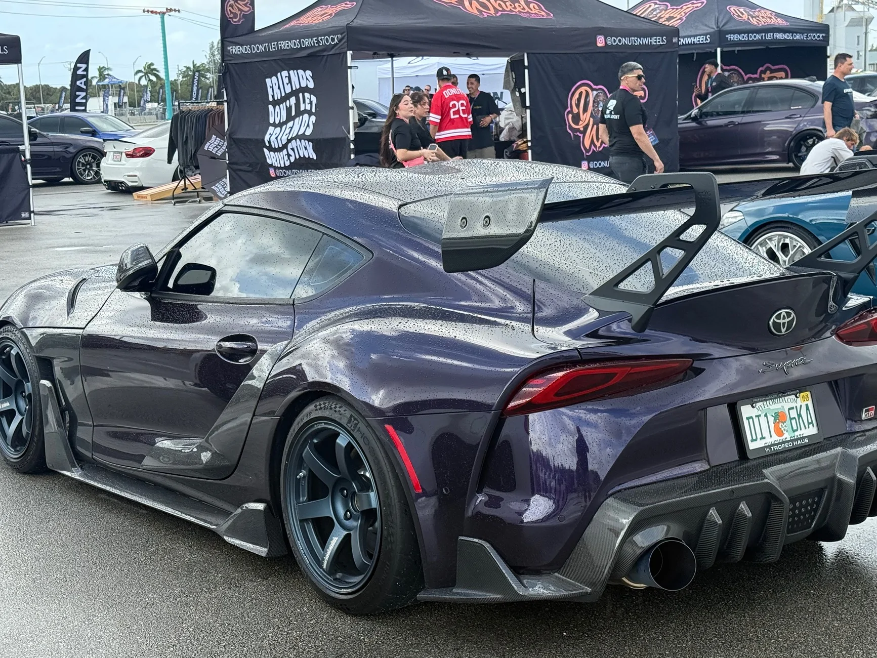

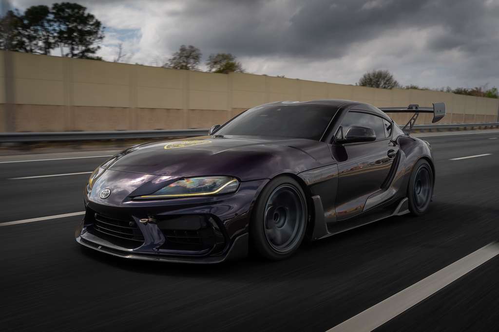

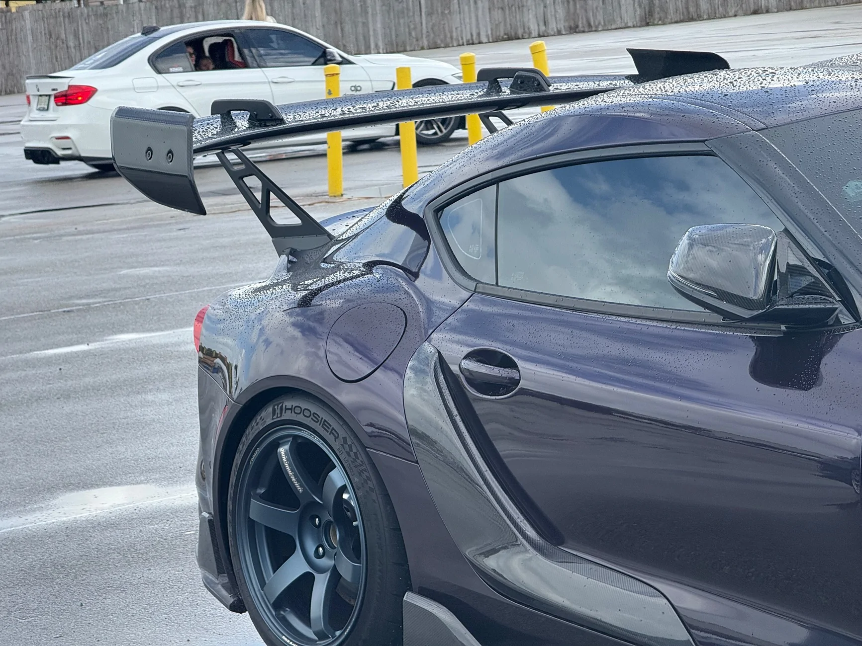

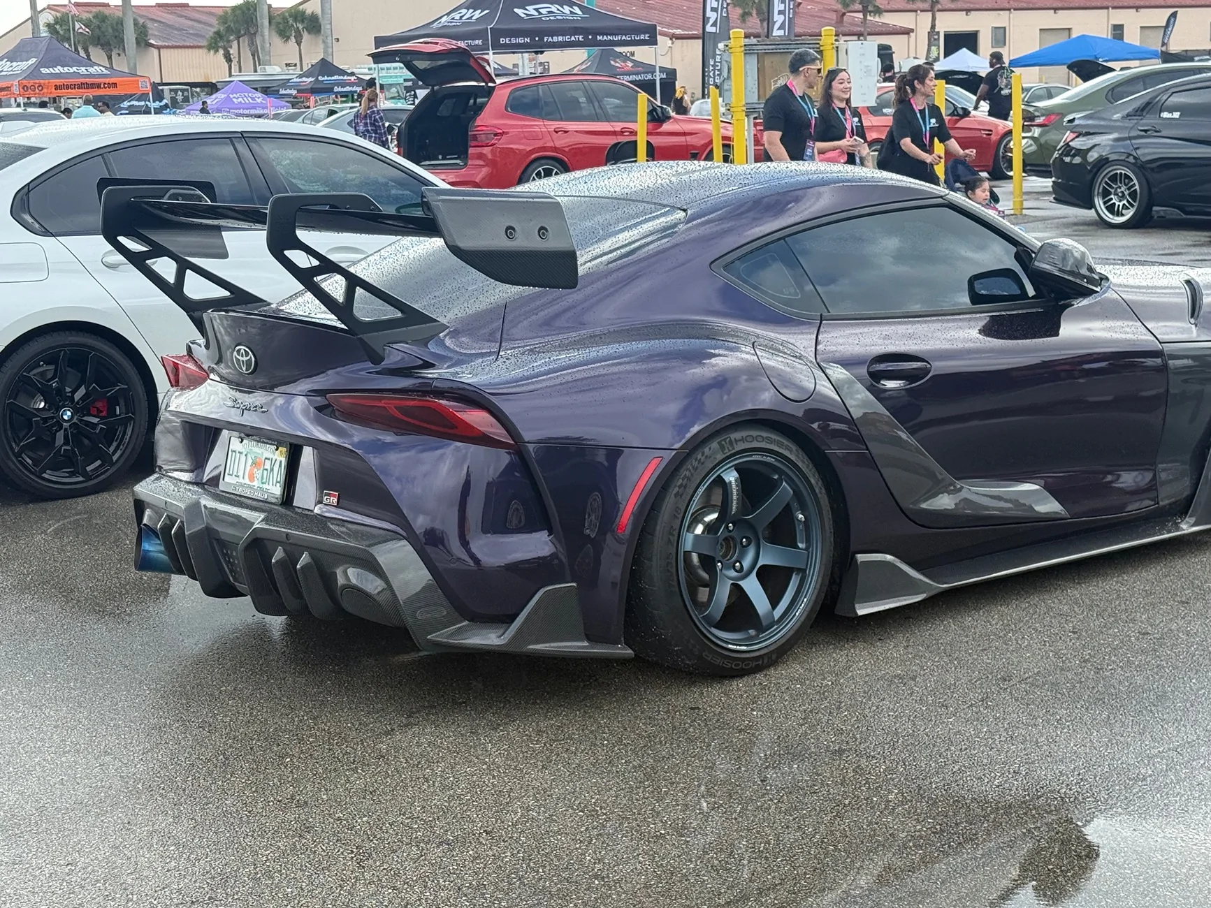

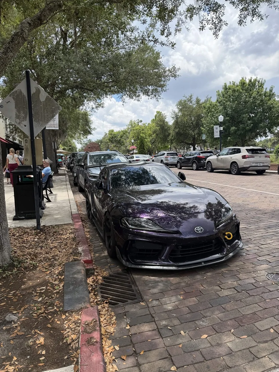

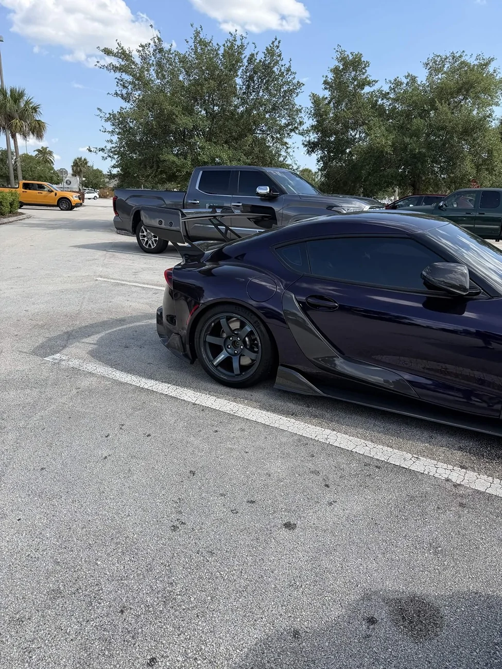

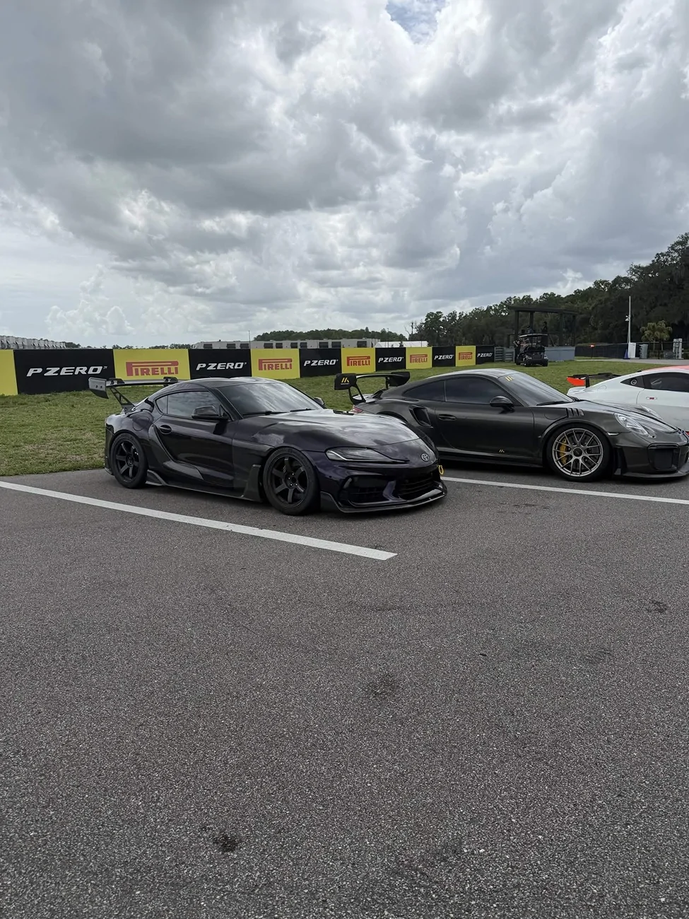

The Supra I speak of (i will get proper pics one day, this is all I have as of now) :

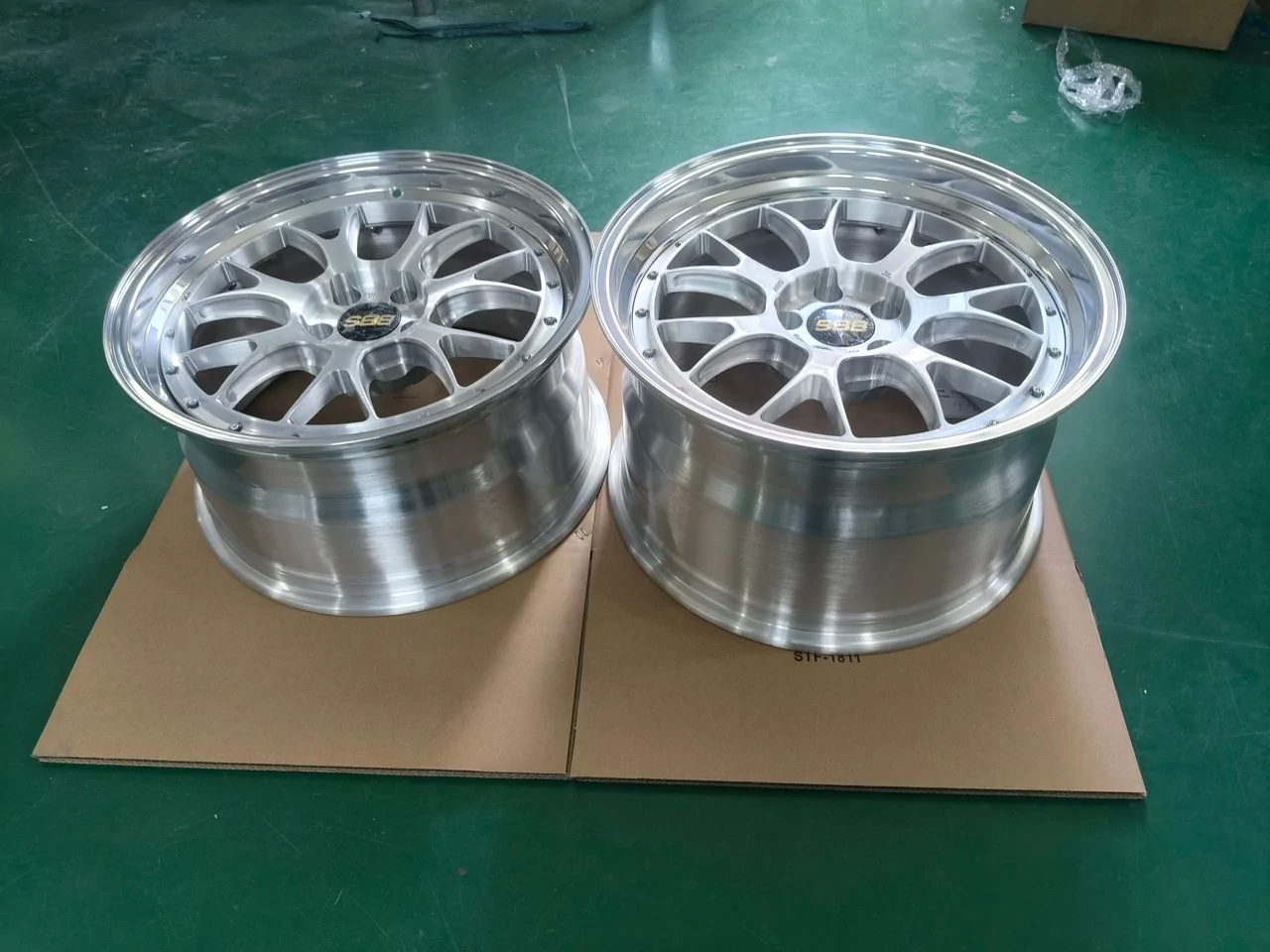

Nice build! Let's see those BBS reps.
mkvkevv
Kevin
May 19, 2026
2025 Toyota GR Supra

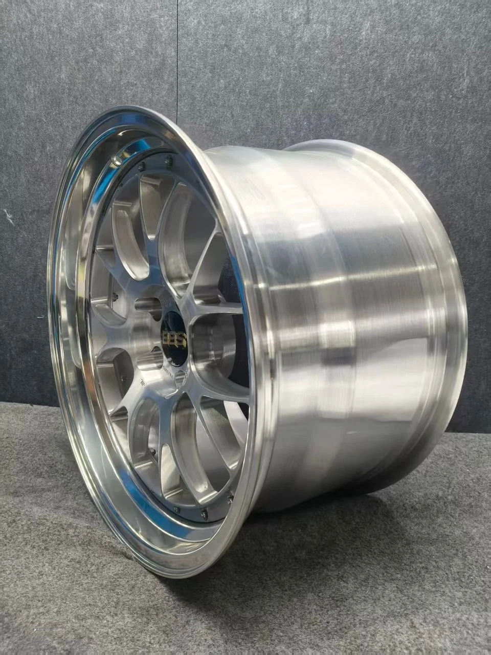

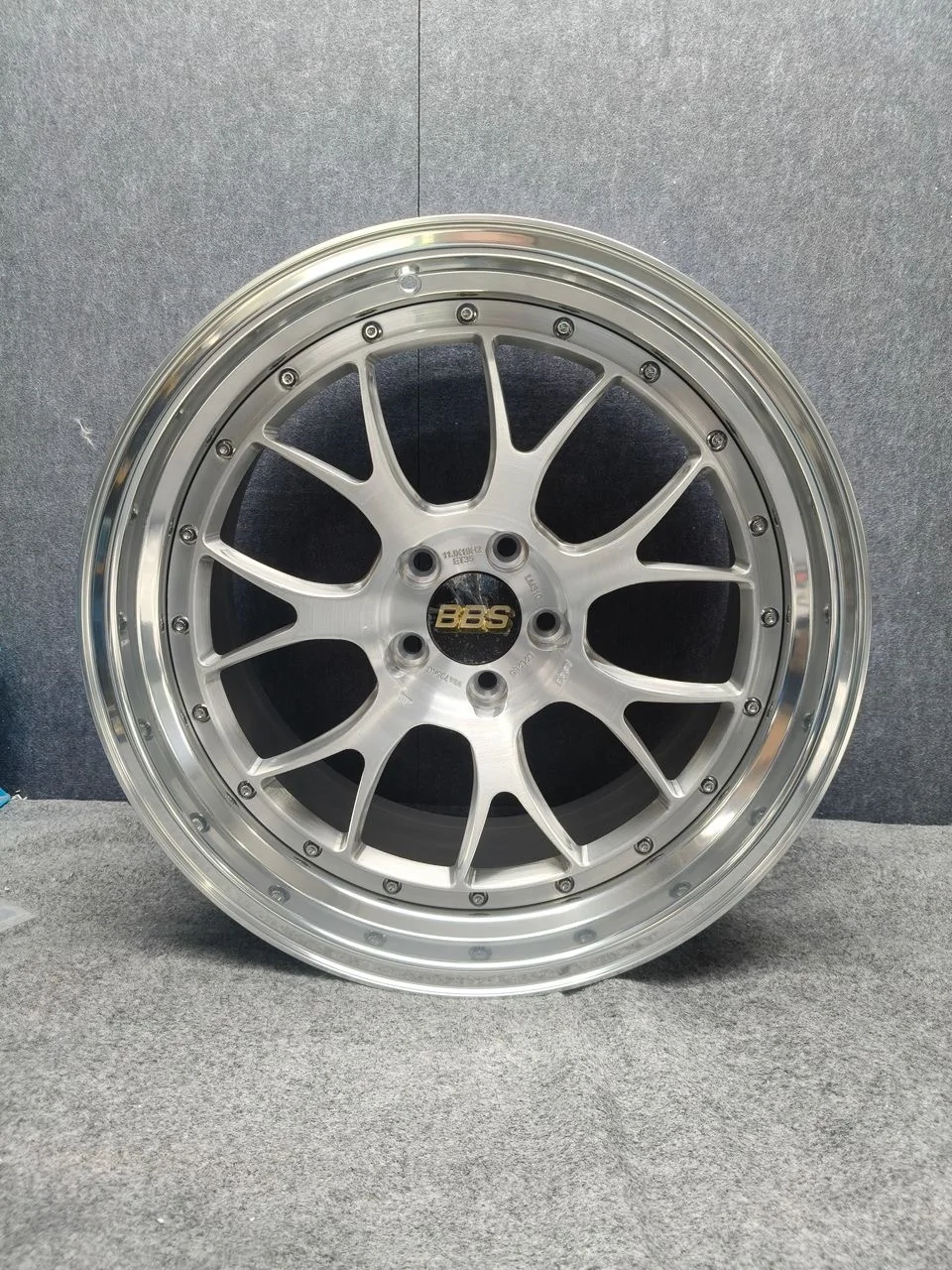

Here u go, haven’t received them but production complete at least.
I previously had some BBS LM wheels from Ron at AR but got bored of them and they weren’t gonna clear the AP brakes I believe. (they are up for sale if anyone is interested, havent listed anything on here because i did not want to lead with that on a new account lol)
