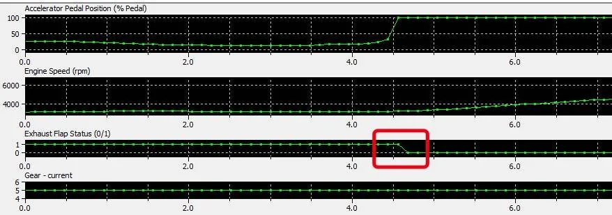

Here's one for ya on the 2023 MT..
SPORT: always open
NORMAL: closed under 3500 RPM* unless heavy throttle
*Valve opens automatically regardless of load at 3500 RPM in gears 1-4, then opens at 3250 RPM in 5th gear, and 3000 RPM in 6th.
Not making this up

So it sounds like we have conflicting information unless MT gets its own muffler flap logic.
I'm almost positive it does, having owned an AT prior to this
